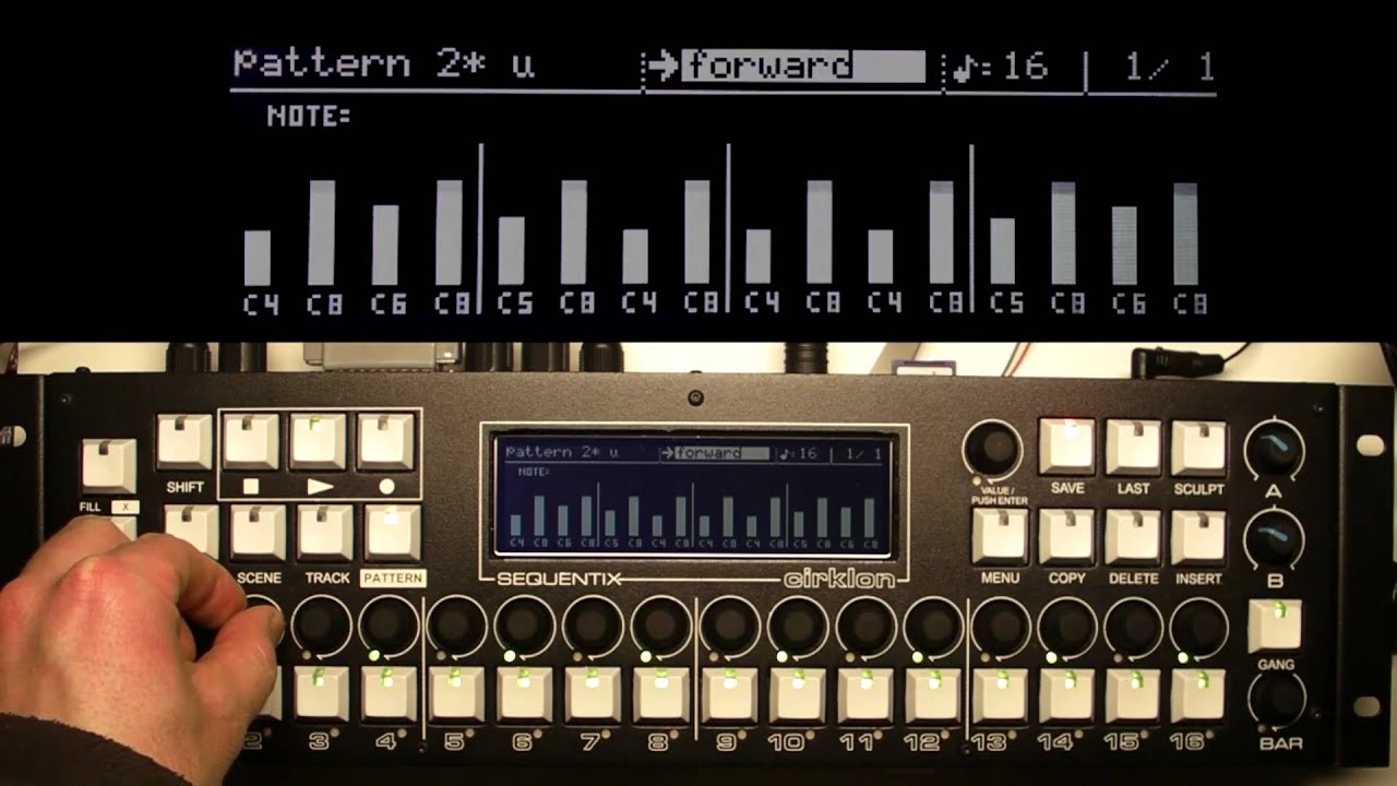

The Cirklon has this functionality, I don’t own one or the code though!
But this isn’t the same.
This Cirklon feature just changes the values of the steps based on a vector entry.
This is a static change - and simple to implement.
