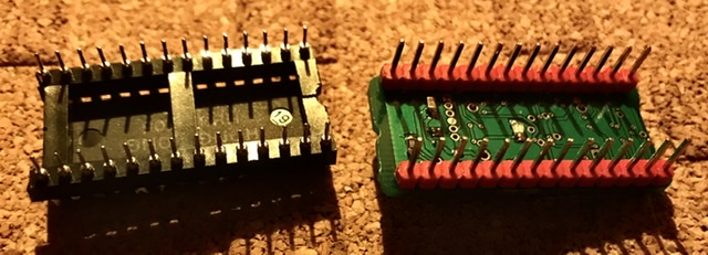

Thank you very much Thorsten,
if I wouldn’t be lost in Giana Sisters since an hour, I had postet that I found the problem. It’s because the SwinSiDs I own do have very fat Pins and they gaped the holes in the IC sockets. I couldn’t believe that but putting a SID in an extra socket, full contact and working. I just did that because I squeezed a leg and came to the idea…but anyway I wanted to do this years ago to protect the legs…
-Solved-
I should have “rtfm” first
Just a head up for those having the issue in 2021  :)
on my end i had a similar problem and it turned out that i had no continuity between the SID pin #6 and the PIC pin #17.
Thanks TK. for the indirect help :slight_smile:
