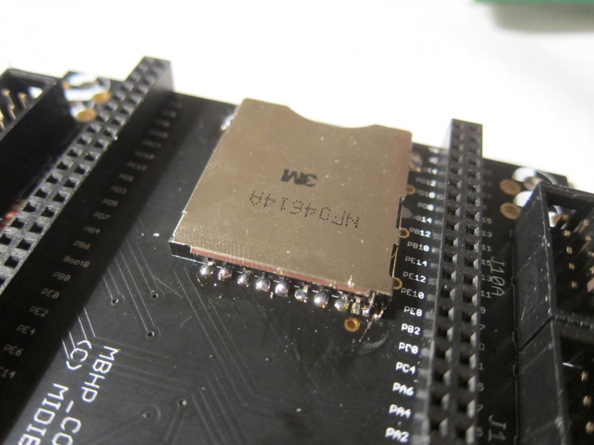

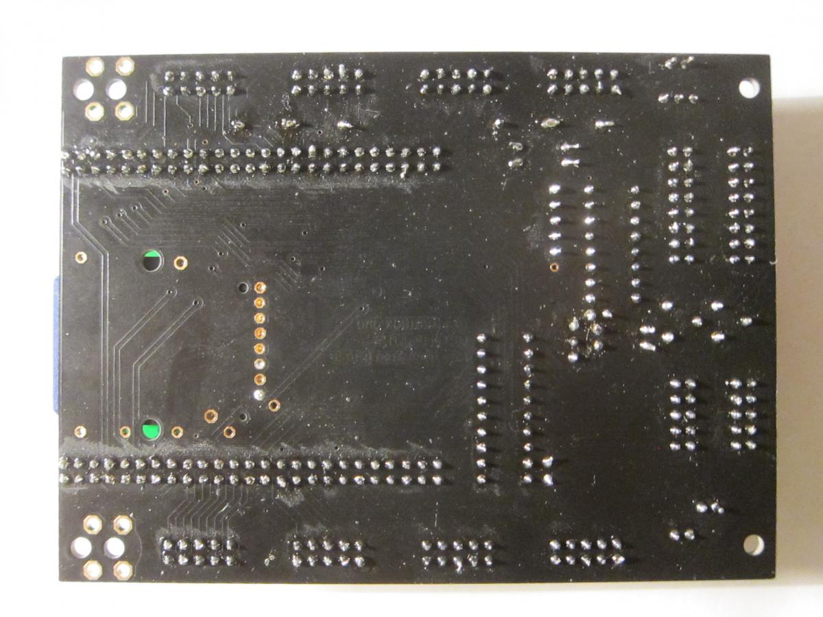

I have tried different ribbon cable orientation (very confusing for newbe), but the effect was the same. So I concluded that I have messed up the MPHP core and resoldered suspicious looking joints (having messed up 4 modules is quite possible but less likely). In particular I have tried to remove a suspected short at the left pins (see attached image) of the SD card connectors. I am also not sure, if they should be soldered to the PCB or not).

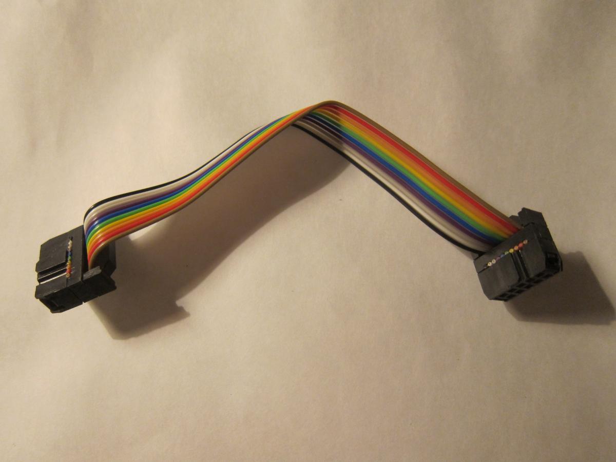

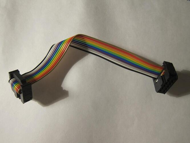

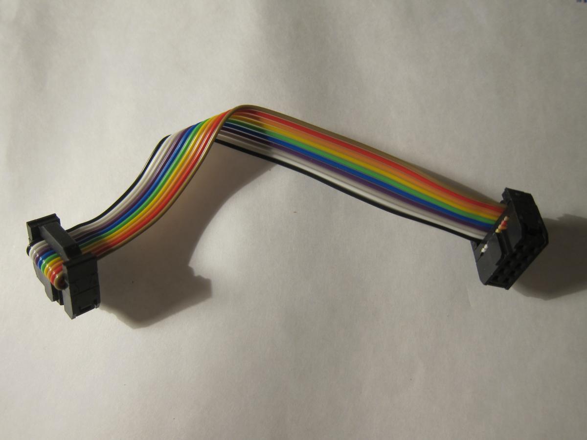

I am attaching images of the (i) MBHP solder joints, (ii) SD card joints, (iii+iv) two ribbon cable connections, I would consider (iii) to be correct but most images I have seen would point to (iv).

This board has to be connected to J4A - are you sure that the ribbon cable is connected correctly?
J4A is correct, but I am unsure about the ribbon cables (for all boards). Do you know good instructions how to assemble them correctly?
