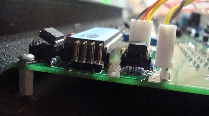

Thanks Burno…
Now… I wonder if it’s that chip in the picture… this happened years ago during shipping.  Perhaps it’s popped out again.
cheers
Steve
Yep! Seems to be that one! lol
