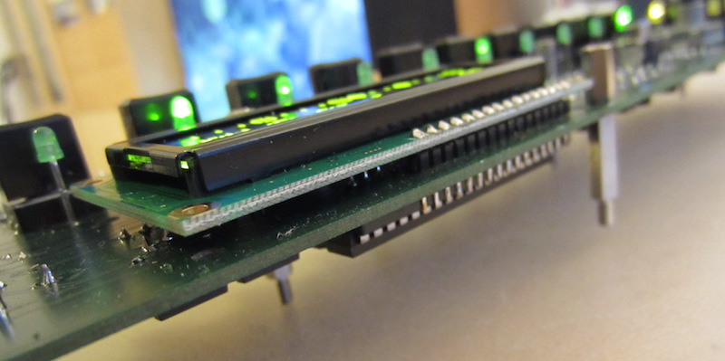

A DOG display will require some special initialisation code in the firmware which is not supported by default…
However, I would propose to use an OLED instead, it looks much better and doesn’t required SW changes!

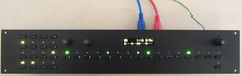

Here some pictures from our (upcoming) MIDIbox DR (based on MIDIbox 808 firmware)
Best Regards, Thorsten.
Interesting. PIC-based?
