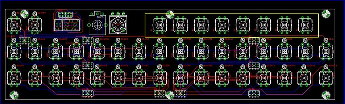

I am also planing to make CS PCB for MB808 standalone sequencer. I am working on layout in Eagle and have some free space that Id like to use, but dont have an idea how. Even it wan`t be used for Divius (MB808) I wanted to have more less the same control arrangement.
Here is how the PCB looks like. (NOTE: a work in progress) It is designed to use 12x12 buttons. The space framed yellow is where I`d like to have some extra controls.
May other 7 analog inputs be easily enabled?
As there are 2 SR left, would it be good idea to have some F buttons or maybe encoders to send volume CC or something?
I really have no idea how to use that space wisely. If Im programmer Ill find some cool usage for it, but Im not. I thought to ad 2x16 LCD there but I dont find it very useful. MB808 is just fine without it.
Any suggestions appreciated.

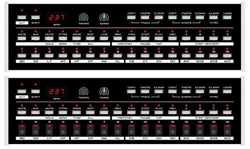

Here are my latest panel layout. As I left with some unused space on CS PCB, I thought it might be usefull to have dedicated buttons of utility functions. I need to check out the firmware to see what should be configured to use these. The buttons will probably be the one known from x0xb0x and Wilbas sequencer, but Im also thinking about using same buttons (just for GP) KokiPsiho used on his Krang Sequencer. I need to buy one of those to check how it fits x0xb0x caps.

I need some help about configuring dedicated buttons before I continue… I just couldn`t get where, and how to configure the pins to send direct commands. I wanted to have direct access to Utility menu functions: copy/paste/clear track, copy/paste/clear steps, clear pattern and undo.
Can I just add these entries and assign the pins in the SEQ_IO_TABLE_DIN and I`ll have direct access to the Utility sub-menu functions?
SEQ_IO_TABLE_DIN
	;; Function name SR#	Pin#
	;; NOTE: the pins of the 16 general purpose buttons are assigned above, search for DEFAULT_GP_DIN_SR_L (and _R)
	DIN_ENTRY CS_M_UTILS_CopyTrack, 7, 0
	DIN_ENTRY CS_M_UTILS_PasteTrack, 7, 1
	DIN_ENTRY CS_M_UTILS_ClearTrack, 7, 2
	DIN_ENTRY CS_M_UTILS_CopySteps, 7, 3
	DIN_ENTRY CS_M_UTILS_PasteSteps, 7, 4
	DIN_ENTRY CS_M_UTILS_ClearSteps, 7, 5
	DIN_ENTRY CS_M_UTILS_ClearPattern, 7, 6
	DIN_ENTRY CS_M_UTILS_Undo, 7, 7
Yes, for MB808 it will work this way.
For MBSEQ it won’t (but the appr. SEQ_BUTTON_* functions are already available)
There will be a minor issue if you access CS_M_UTILS functions directly: the function will be triggered when the button is pressed *and* depressed. However, probably you will never notice this :wink:
Best Regards, Thorsten.
Good. Than, I`m ready to go. :slight_smile:
I wish all issues are like this one. :slight_smile: As you said… I would probably never notice it.
Thanks for an answer mate.  :wink:
