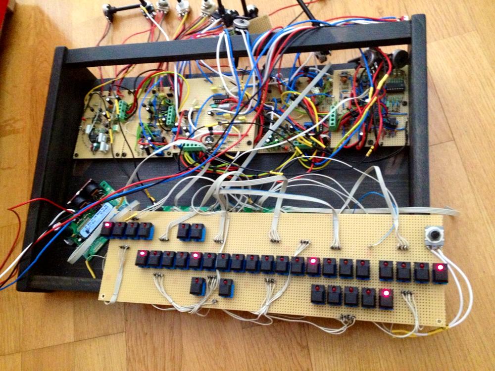

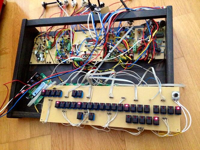

After finishing all the sound circuits I needed a trusty sequencer, so that I have a standalone unit. After gathering some courage, I ordered midibox core, din and dout kits from SmashTV and started building the sequencer. Sequencers main UI pbc with all the buttons and leds are also build on veroboard. I have to say, figuring out connections and connecting all the buttons and leds to Midibox DIN and DOUTS was lot of work, but it was all worth it because MB808 sequencer firmware is simple amazing.

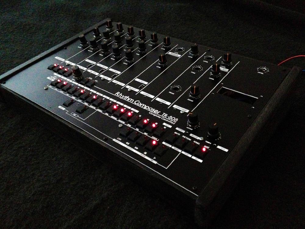

Here are couple photos from the build and video so you can here sounds and see the sequencer in action.
Its still work in progress, but since taking the pics, I’ve build individual outs and main LEVEL amp section, so basicly its done apart the cymbal.
It has ugly insides but beautiful soul

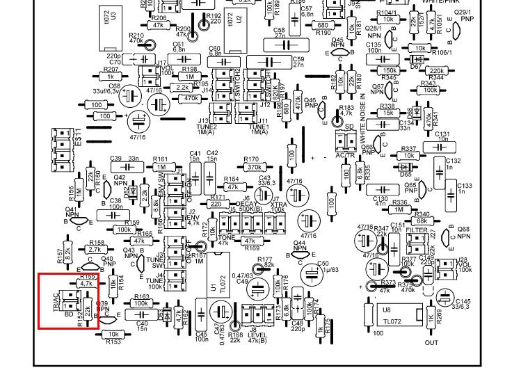

He tank you for your answer i have a 808 like you but with the microlarge PCB
My sequencer don’t trim nothing but i have no connection for the input accent perhaps this is the reason that don’t work ?

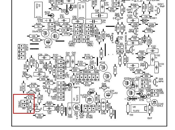

I took a look at Microlarge 808 PCB’s and it seems that there are two connections on each sounds trigger connector.
Trigger and Accent connections are side by side at same connector.
All the 808-clone sound modules and circuits that I’ve come across have both TRIG and ACCENT inputs. If you dont want to use accent, or if you dont have accent circuit to operate accent, Accent input is tied to 12volts, or what ever your VCC is.
More info from here -> http://ericarcher.net/wp-content/uploads/2009/07/tr-808-bass-drum-diy-project.pdf
"f you are planning on triggering the circuit from a logic signal, the easiest way is to tie ACCENT to +12V (+15V), and connect
the logic signal to TRIGGER. This schematic includes my diode - cap - resistor network. This makes trigger behavior independent of pulse width (unless the pulse is super short of course)"
If your ACCENT input doesn’t have voltage/isn’t connected, circuit doesn’t make a sound.
I put a picture of Microlarge PCB so you can see what I mean. Trig needs to be connected to to Midibox DOUTs pin that supplies the trigger for the bassdrum, and Accent needs to be connected to +12V (or what ever the positive voltage is on your powersupply)
EDIT : I DO NOT TAKE ANY RESPONSIBLE FOR POSSIBLE DAMAGE, because I’m not 100% familiar with microlarge PCB’s, but looking at the pictures, I would assume that it operates exactly like every other 808-sound circuit that I’ve seen. Trig = for trigger pulse and AC = for accent voltage.
He thank you for your answer
When i have tested my MB808 i haven’t put nothing on the AC input and now i understand why i have no sound i will trying this as soon.
