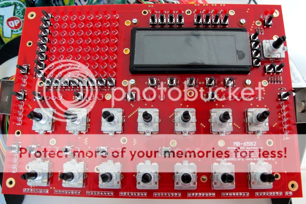

Hi,
I have got exactly the same issue. Some buttons don’t react as expected. Especially the menu button jumps into different other sub menus … very annoying … Here is a picture of my CS PCB:
Also I have recognised that in the Bassline mode while a sequence is played the LED’s 4 to 6 glow always together, rather than separate. Before I soldered the components to the CS PCB I tested all LED’s, diods and tact switches. After I noticed the fault, I check the following things:
  • orientation of the diods and LED’s -> all as expected
  • the function of the diods and LED’s -> all ok
  • the cables from the base pcb to the CS pcb -> all ok
  • all soldering points -> no shorts
To exclude a fault in the base PCB I connected the control surface to another MB6582, and it behaved in the same faulty way. Therefore I can exclude that something on my base PCB is faulty. I installed on all PIC’s the MB6582 setup, without any errors. I don’t know what else I can check …
Any help or recommendation is appreciated !
Thanks

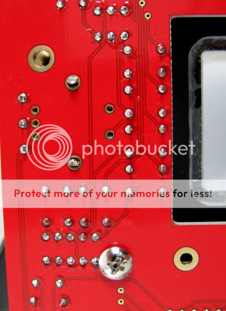

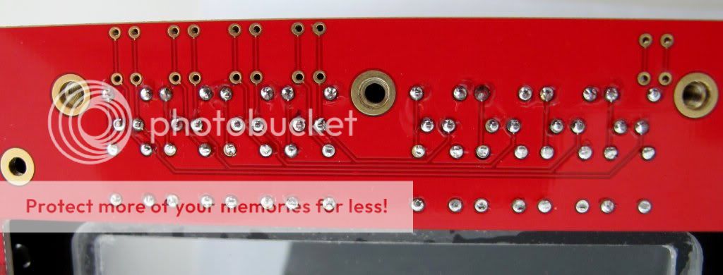

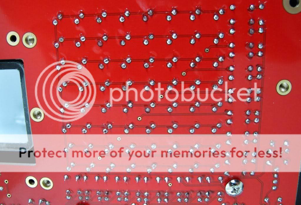

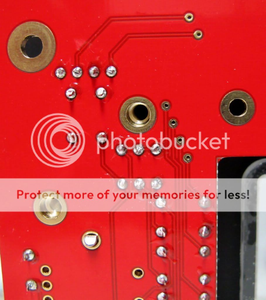

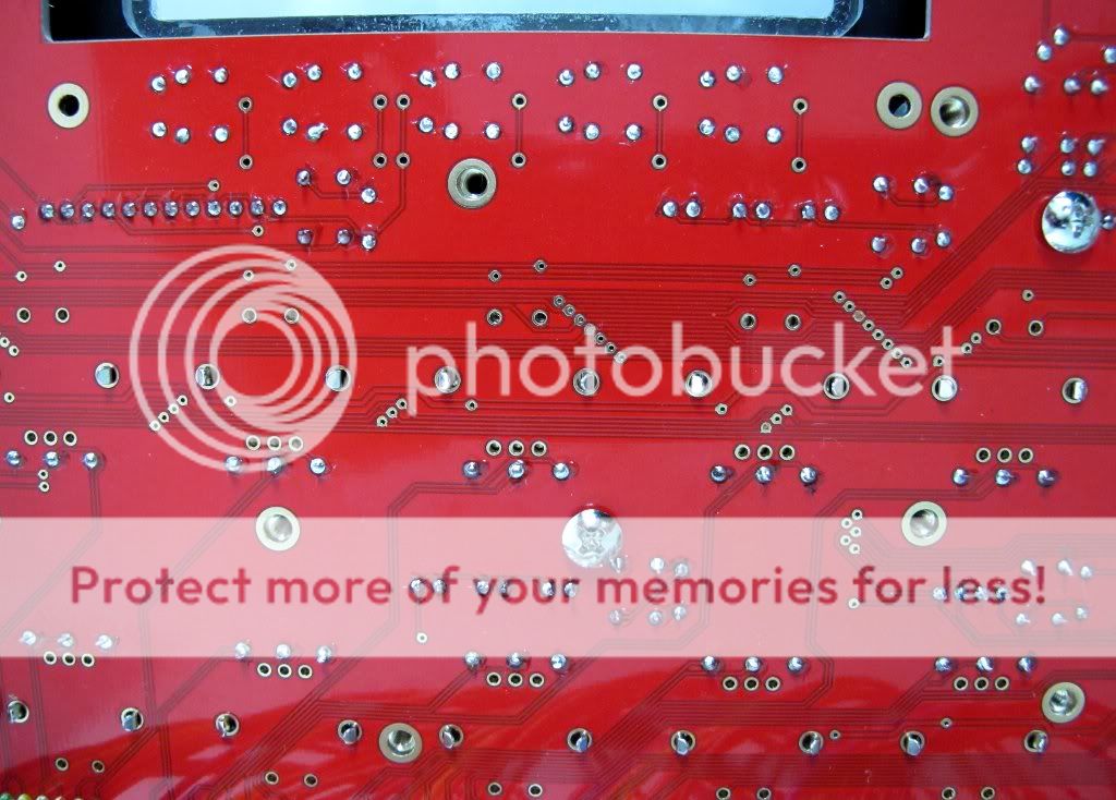

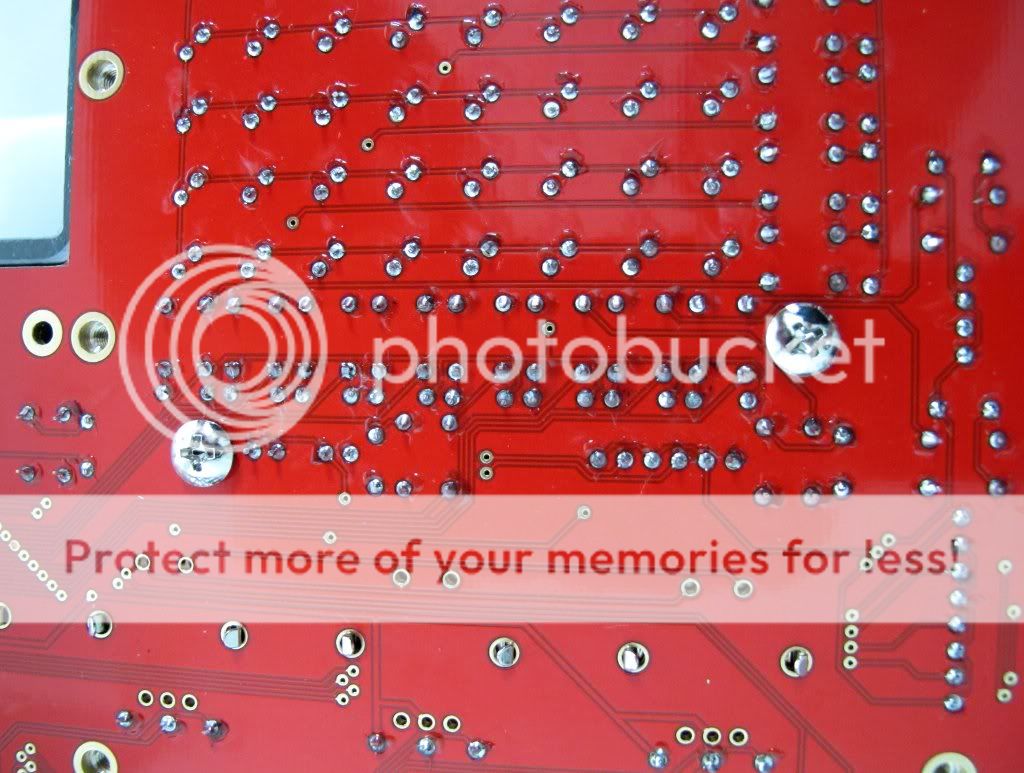

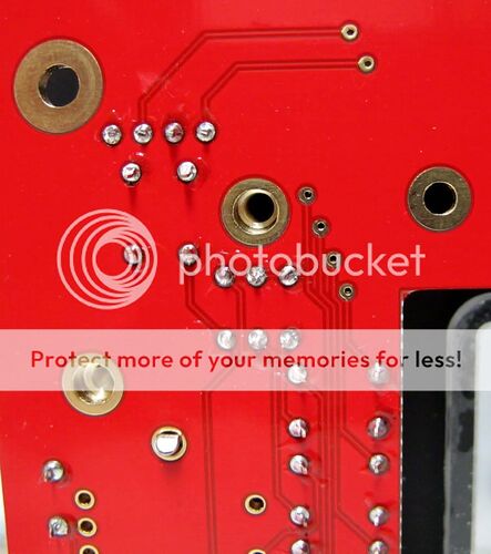

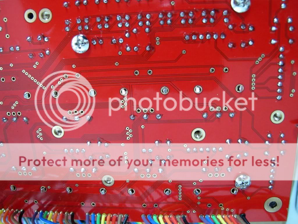

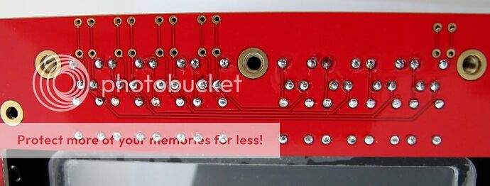

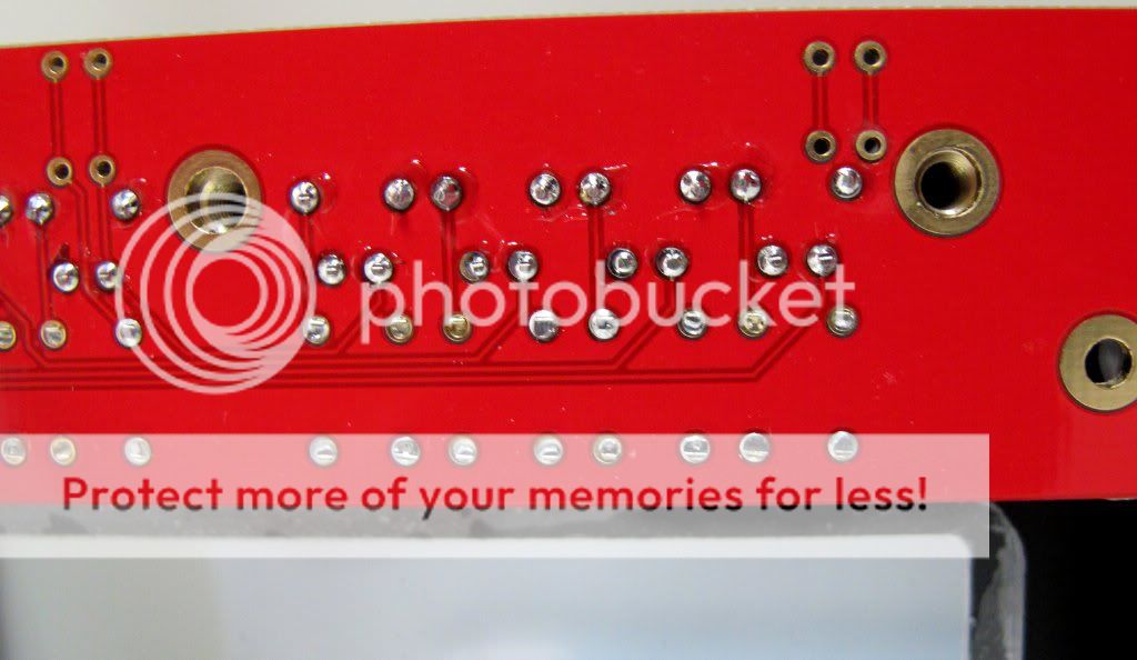

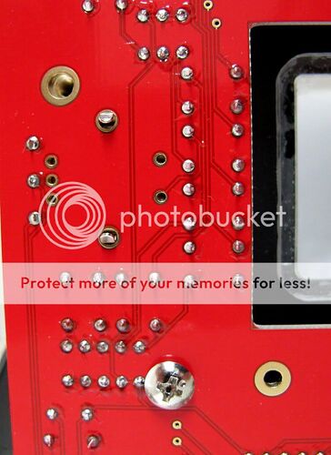

Hi,

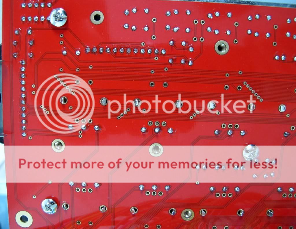

I have insulated the Display of course and actually I use some washers in between, because I need some space for the Window. Please find attached some pictures of the backside of the CS:

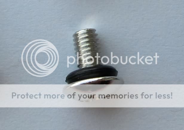

Please note that the screws on the board don’t create a short. I have removed them prior to the testing and they also have a nylon wisher underneath:
I also think the encoders work fine and modify the expected parameters…
Do I need to remove the IC’s close to the network resistors when I measure them ? I will use a 20K scale to measure them.
Cheers
orange
Mhm, its hard to tell, maybe some other folks have opinions on this… in the third picture, some joints do not seem to be soldered/tinned…
Also for stability reasons, i would solder the stabilizers of the rotary encoders to the CS PCB.
You said that you have tested this CS with another baseboard, that works fine with another CS, therefore the problem must be on this CS (Sherlock Holmes :-)), not the resistor networks (which i assumed in last mail).
You can always try cleaning flux with alcohol and a toothbrush, sometimes it hides very tiny bridges.
