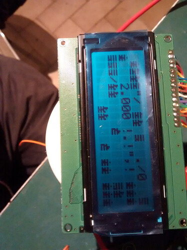

I am almost done bulding the MB-6582 but i am stuck on LCD wiring and connection.
I followed the LCD wiring guide from here: http://www.midibox.org/users/jim_henry/building_a_midibox_lcd_cable.pdf
I had a first problem with my initial LCD: the Backlight wiring was not classic and i think i bricked the LCD. So i started with another one, i double-ckecked the pinouts but it still doesn’t work: i have weird characters appearing on screen (see attached picture)..
Any clue to help me troubleshoot this ?
I am trying to resurect an old CORE8 Module to test the LCD, but without success (i posted another thread about this issue). So for now i don’t have other to check if it is an LCD issue or MB-6582 issue…
Thanks !
Best Regards,
Thomas
Hola!
Which LCD model is it? Do you have a link to the datasheet?
Imho, it might be an accidentally swapped data wire… you could try rebuilding a new cable, following these instructions: (they are not better than Jin Henrys, just a different approach, maybe it will work like this?)
< base_url >/topic/14564-building-the-mb-6582-control-surface-photo-tutorial/?do=embed&embedComment=129696&embedDo=findComment
Many greets!
Hi!
I bought a new one (a cheap one from Aliexpress, waited loooong time to receive it but it was 2$ + free shipping…)
And following your attached guide, i finally worked it thru !
I will replace with a better looking one later, but i am really thrilled it finally display something !
Last step now: link front and back boards.. never been so close :wink:
Thanks for pointing out the wiring guide !
Best,
Thomas
