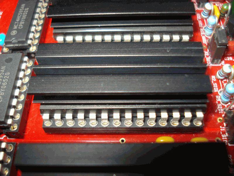

I used heatsinks for DIP devices sticked with AKASA thermal biadesive tape and have disconnected the fan
and drilled some additional holes in the bottom of the case
P.S.
I am not advertising for the brand of the tape…it is only what I used for
feel free to use any other thermal tape you want :smile:
