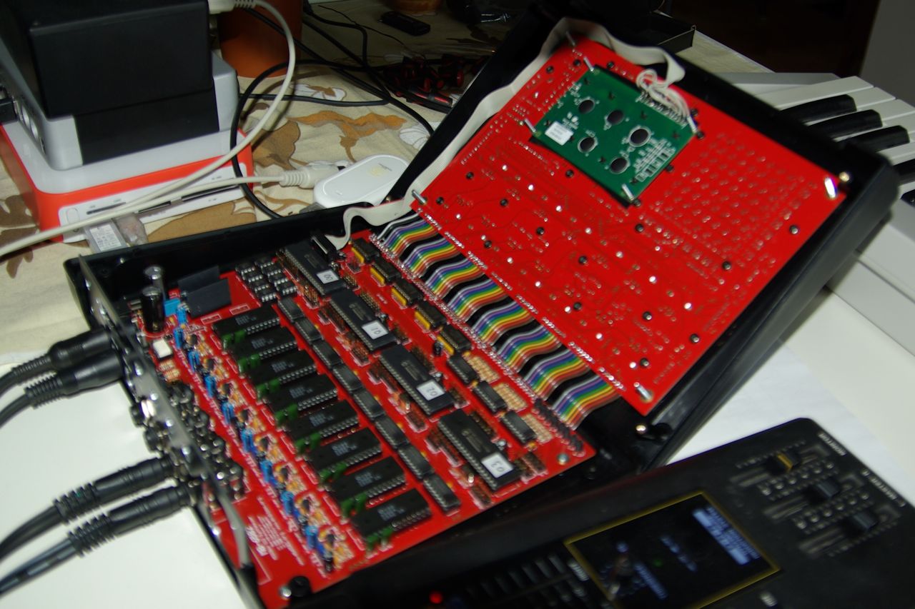

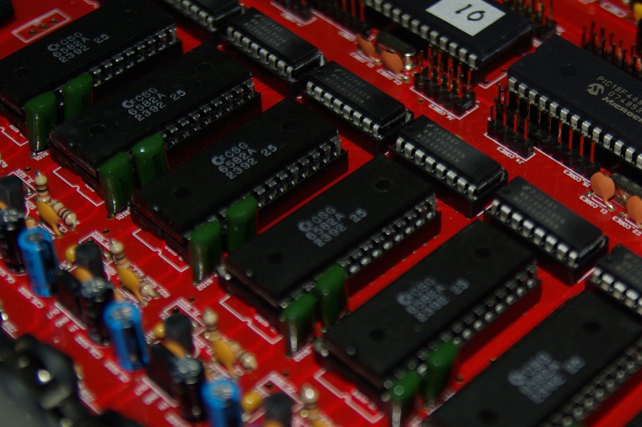

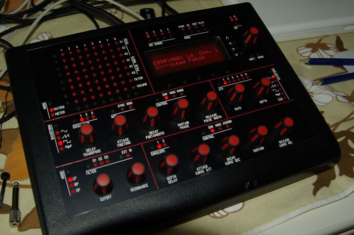

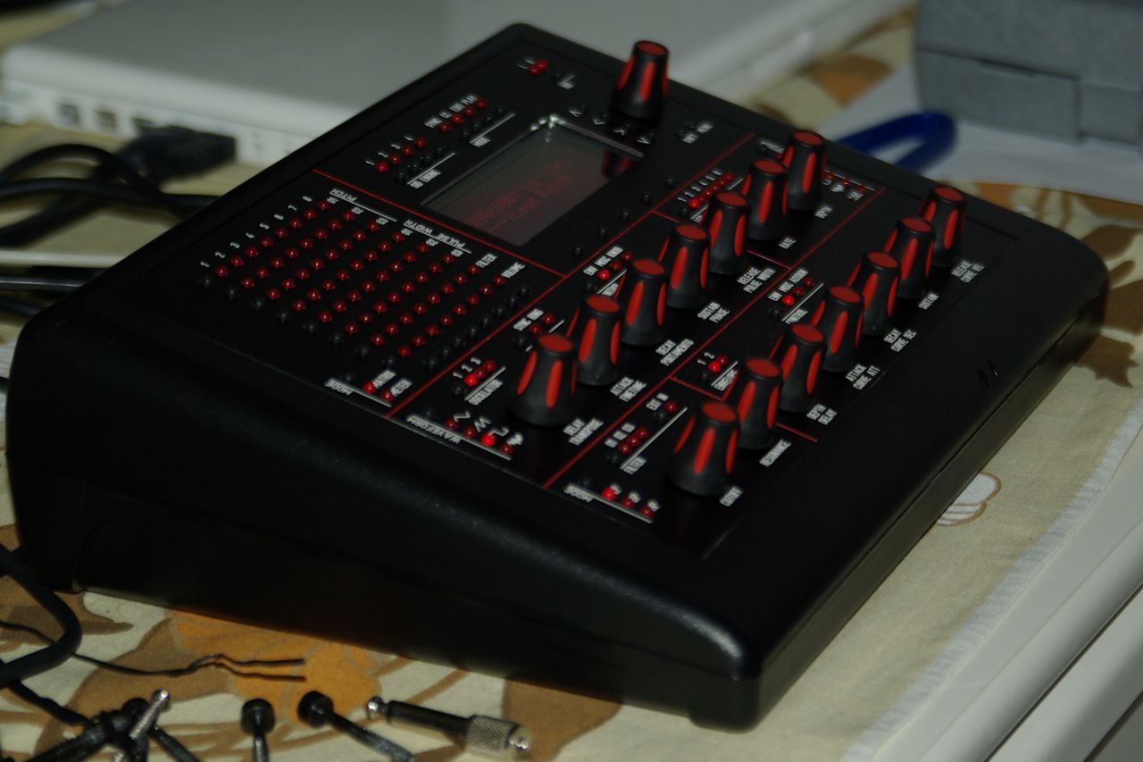

Here are some pictures. No supprises, just a very nice synth!
Thank you again Wilba.
Congratulations! :slight_smile:
Nice!  The red theme reminds me of an Access Virus.
Did you use .100 spacing cable to connect the PCBs?  If so, where did you get it?  I couldn’t find it at Mouser (it’s there somewhere I’m sure) so I just used standard IDC cable.
Thx again re: the 8-pin connectors.
