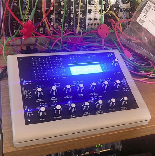

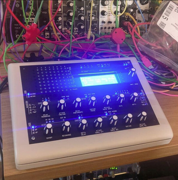

And here’s the finished box =). All working very nicely now.
