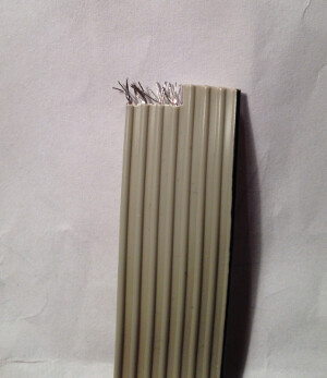

Resurrecting this thread… The connection between Baseboard and CS makes me a lot of headache.
The 100mil spacing ribbon cable (Part Number: 606162-F0) from Conrad is no longer available (discontinued summer 2012). As a replacement Conrad proposed a different cable (607378-62). I’ve tried this without success. This is not the stiff solid wire! It’s stranded wire (see first picture) which won’t give a strong connection (wire breaks between the soldered connection and the insulation) and it’s a pain to remove the insulation without partly destroying individual wires…

My advice:  Bite the bullet and just cut all the jumpers to length by hand and make sure you use 24 ga wire with FLEXIBLE insulation (i.e. NOT TEFLON), it takes a while but down the road it will save you a TON of time.  The 0.1" ribbon is a pain to strip and if you break any of those leads, you have to make a new one and take out the old on to fix it (had to do that twice) which is a long and painful operation.  With single wires, if anything goes bad, its ONE wire to replace
I can second that. I have the flexible ribbon cable in my machine, but it was a long and painful process. Things usually go wrong at the last lead in the ribbon cable, i.e. I broke a lot of wires when trying to remove the insulation of the last lead in the ribbon cable…
