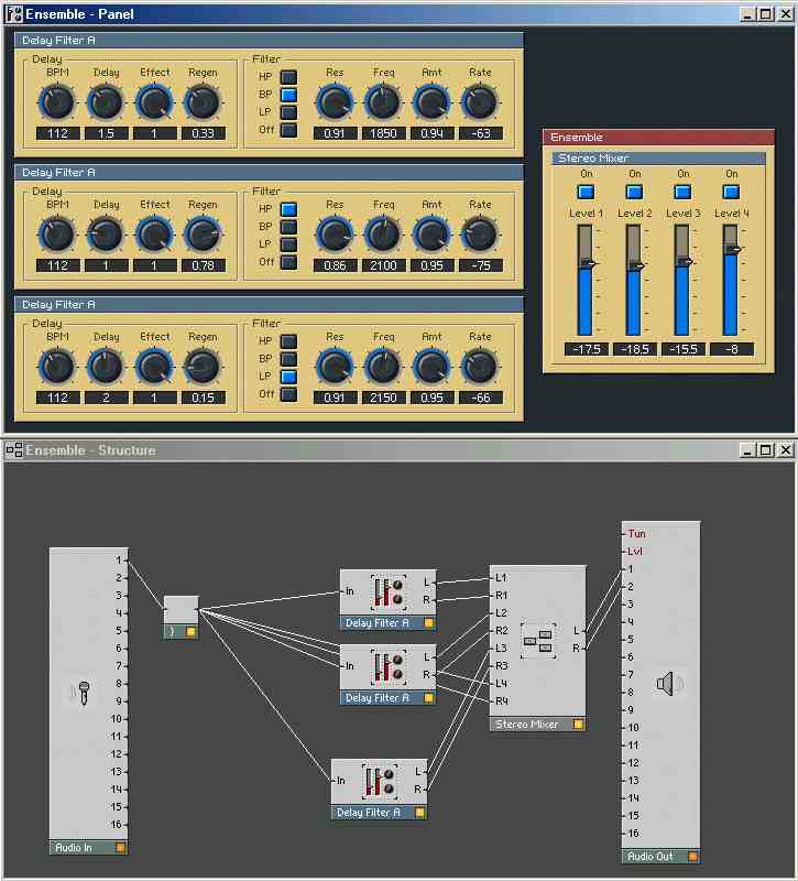

So, my intention was to use three filtered audio delays in this setup: MB64SEQ+Keyboard —[MIDI]–> SID —[audio]–> Logic —[VST]–> Compressor —[VST]–> 3 filtered Delays –> Audio Out
The filtered delays are VST effects, realized with Reaktor like shown here:
(but I think that also common VST delays and VST filters could be used)
Three different filters are selected: lowpass, highpass and bandpass. The cutoff frequency is modulated by a LFO (!) for an automatic varied timbre. Also the panning is modulated. The delay time depends on the BPM, factor: 1.5 for BP, 1 for HP, 2 for LP.
