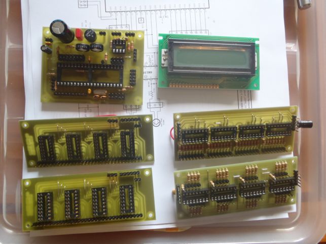

I have attached a close-up(sorry about the bad quality) pic of one of the AIN-boards. Do the By-pass caps look like they are in the correct spot? I was a bit confused when the instructions said: “as close to the +5V power input of the 4051 as possible”. So I soldered them in the same pin as the +5 of the 4051. Is that correct?

Hi. Bypass caps is supposed to be as close to the 5v input terminal of the ic as possible yeah. One pin on the 5v terminal on the ic and the other pin to ground.
And to solder it to the 5v terminal of the ic directly is ok. It’s kinda hard to see for me since I don’t know mikes board from before if it is correctly placed, but if u follow the simple instructions I wrote above it is ok.
But picture show u have no insulation on the cap legs… Bad. U must make sure there is no way that the caps legs can ever shift position and make a short in there. Mmm magic smoke.
So I suggest u put a piece of tape around the legs and glue them in position with epoxy or something. They will never move then.
Or u can desolder and add some shrink tubes around the legs. But it is easy to ruin the tubing when soldering close to it. Right amount of heat = shrink, too much heat = melting.

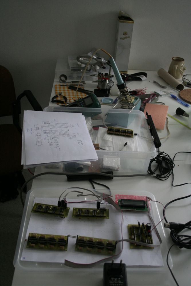

Hi everyone!
Update since last time:
I received the faders and all is well under the sun. :slight_smile:
I have finished all the modules and started to do some of the wiring.
I went ahead and powered up the core, and I get 5V in all the right spots!
I used an old AC/DC wall adaptor which outputs 12V DC and 500mA. Is the voltage too high? I only kept the core powered for a minute or two, and atleast in that time the regulator did not heat up. So i guess i can use this as a power supply?

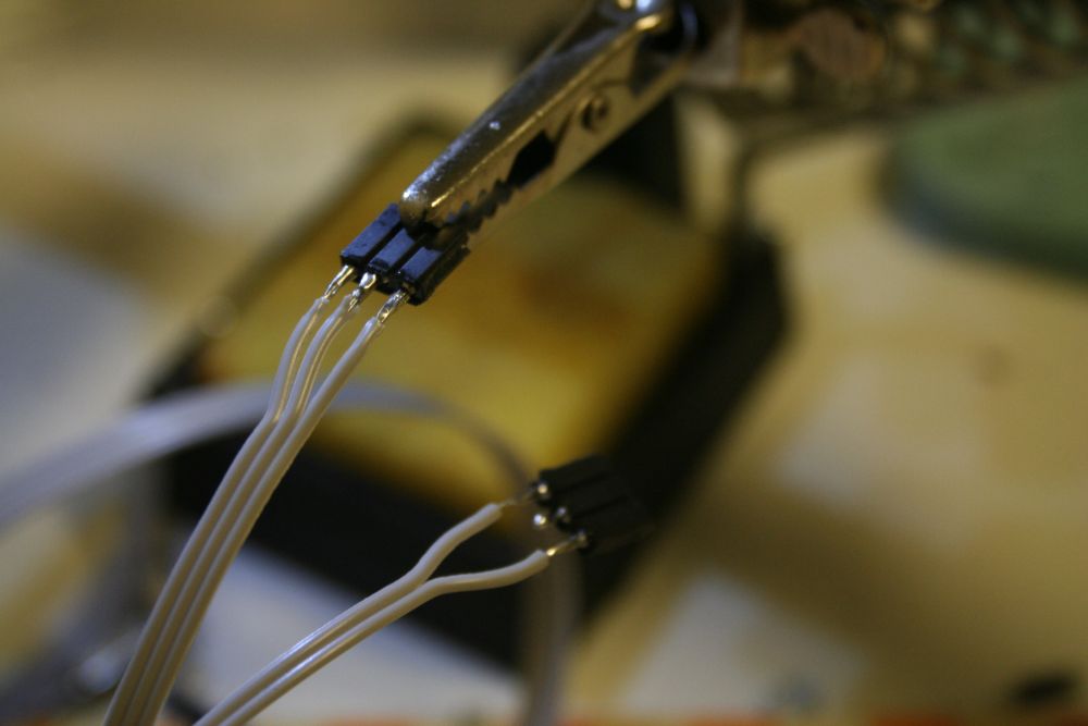

DIY connectors, a push-button assembly, and my fathers old Weller from the 80’s.
