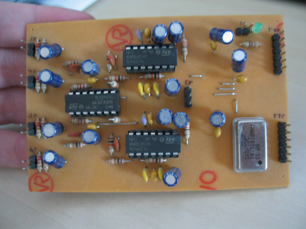

I stumbled accross some web images of someone who has built a OPL3 successfully:
It looks like his board has quite a lot of tantulum caps (I’m guessing they are tantalums).
I have used all ceramic caps for the non-polarised caps.
I just double checked the reichelt orderlist and realised that in fact the 9 x 100nF caps are VIELSCHICHTKONDENSATOR.
My German is not very good I’m afraid. Can anyone tell me exactly what this type of cap is please?
In the meantime I will buy some tantulum’s and experiment to see if it makes a difference.
D
It’s very unlikely that the caps are causing such an issue.
In order to see a picture of “VIELSCHICHTKONDENSATOR”, visit www.reichelt.de and type this keyword into the search mask - they are looking similar to tantulum caps
I’m using the same caps - but as mentioned before: the cap type doesn’t matter here, they don’t have essential functions.
