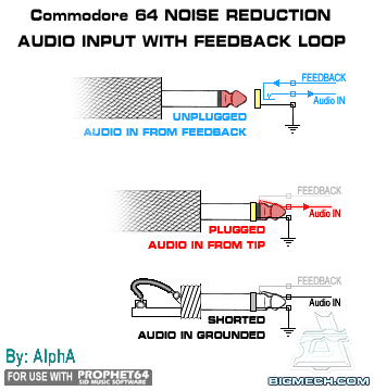

Couldn’t you use jacks that change the circuit when you plug them in to do this?  Basically each (stereo) jack has connections A1,A2, B1,B2, and C1,C2.  Without a jack plugged in A1 is connected to A2, B1 is connected to B2, and C1 is connected to C2.  When you insert a jack, tip of the jack goes to A1 and A2 goes to nothing, ring goes to B1 and B2 goes to nothing, and sleeve goes to C1 and C2 goes to nothing.
So basically (for a mono connection so let’s ignore the ring for now) you would hook A1 to audio in on the SID and rewire the output of the feedback pot to A2.  You hook C1 to audio ground on the SID, and C2 to ground on the feedback pot.  So when no jack is plugged in you have the feedback pot connected, and when a jack is plugged in the feedback pot is disconnected and you have audio input.
A jack like this would work (Mouser part #550-20301): http://www.mouser.com/Search/ProductDetail.aspx?R=NMJ6HFD2virtualkey56810000virtualkey550-20301
BTW you might have room for a small fan along the right side of the case (depending on what power supply option you used).  You could then cut slits or holes on both the right and left sides of the case to get good airflow (even without the fan).  If you have access to a milling machine then cutting nice slits is easy - http://www.midibox.org/forum/index.php/topic,13502.0.html (though I should have bought a longer cutting tool to make the slits taller).
RE: heat sinks see this thread: http://www.midibox.org/forum/index.php/topic,13785.0.html
You might want to consider what the “inventor” of feedback pots on C64s did… see the attachment because his website isn’t working.
http://www.bigmech.com/misc/c64mods/noisereduction.html
If you plan to use the audio input and the feedback loop, you can do what I did and rout the incoming feedback to the switching lug. The tip and ground lugs are wired up in the usual fashion. With this configuration, SID audio output goes through the pot (not shown in schematic) and loops back to SID audio in via the switching and tip lugs until a plug is inserted. An ordinary plug breaks the feedback loop and replaces it with the audio signal at the tip of the cable for normal audio input. Finally, inserting a shorted (tip and shell soldered together) dummy plug breaks the feedback loop and replaces it with ground. Now I have feedback mode, audio in mode and regular noise free mode.
You can’t do it exactly like he did because he’s using mono plugs/sockets.
My suggested setup for MB-6582 is a little different - the feedback pots are connected to audio output and ground on each “end”, and the wiper goes to audio in, thus giving you the ability to attenuate how much output goes into the input.
Perhaps instead of connecting one side of that pot to ground, you connect it to a pin of a switched audio input socket with the sleeve pin grounded.
Thus when the audio input socket has no plug in it, the pins are grounded, and the pot lets you scale between no feedback and total feedback.
When there’s an audio plug in the socket, the pot lets you scale between audio input signal and total feedback.
With a 500K or 1M pot, the two signals being mixed won’t affect each other, I think… I’m not an expert at these things, sorry… you can always test the theory before committing to it.
Anyway, it’s just a crazy idea that could mean you don’t need switches or big panel changes.

Well something like this should do it

That seems like it would work, though perhaps this (see attachment)?  This would let you control the amount of input signal.
Good suggestion. The 500k dual pots I intend to use for the feedback loop, will they have the desired effect on controlling the amount of input signal?
fussylizard: that’s perfect.
Syntax: yes, those pots will then attenuate the audio in, the same way they attenuate the SID output when using feedback.

You might try a few pot values to get best results.  I just have feedback on mine (no audio in) and I tried 100K linear and 500K logarithmic pots.  The 500k log pots basically only had a small useful range, but the 100k worked pretty well for me.  YMMV of course, but I definitely recommend trying out a few options before doing anything too permanent.
