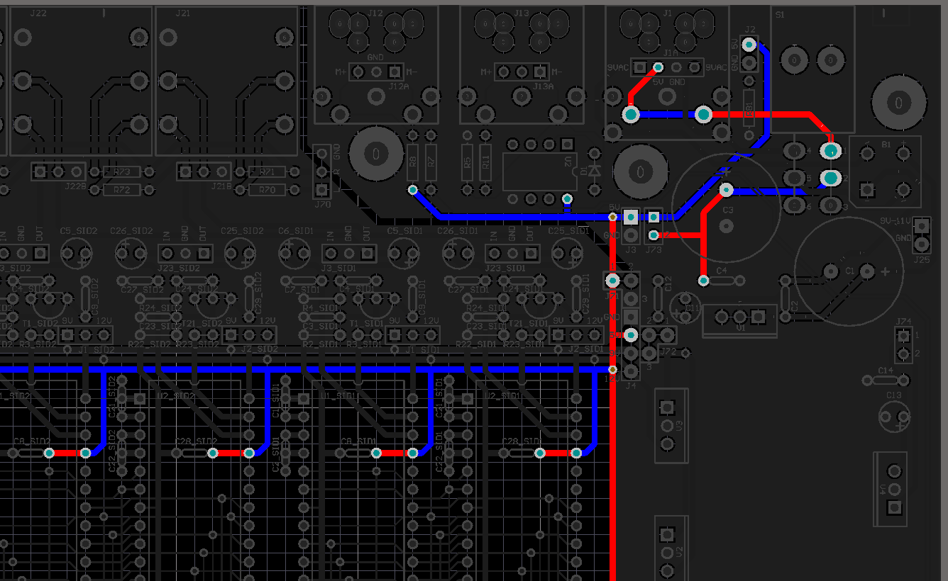

Maybe this picture will help you work out what’s wrong.
Just to be clear, are you testing if pins on IC sockets have 5V?
And you say the pins on IC sockets have 5V, but the top pin of J3 does not?
I suggest you check for 5V for all the pads shown in the diagram.
Edit the image and mark which ones have 5V and which do not.
It would be a lot quicker and accurate than describing it in words.

Check all the pads which should be connected to 5V. See picture. The last time this happened to somebody, it was in the “bankstick” IC sockets - that’s where there are a lot of 5V and GND pads close to each other.

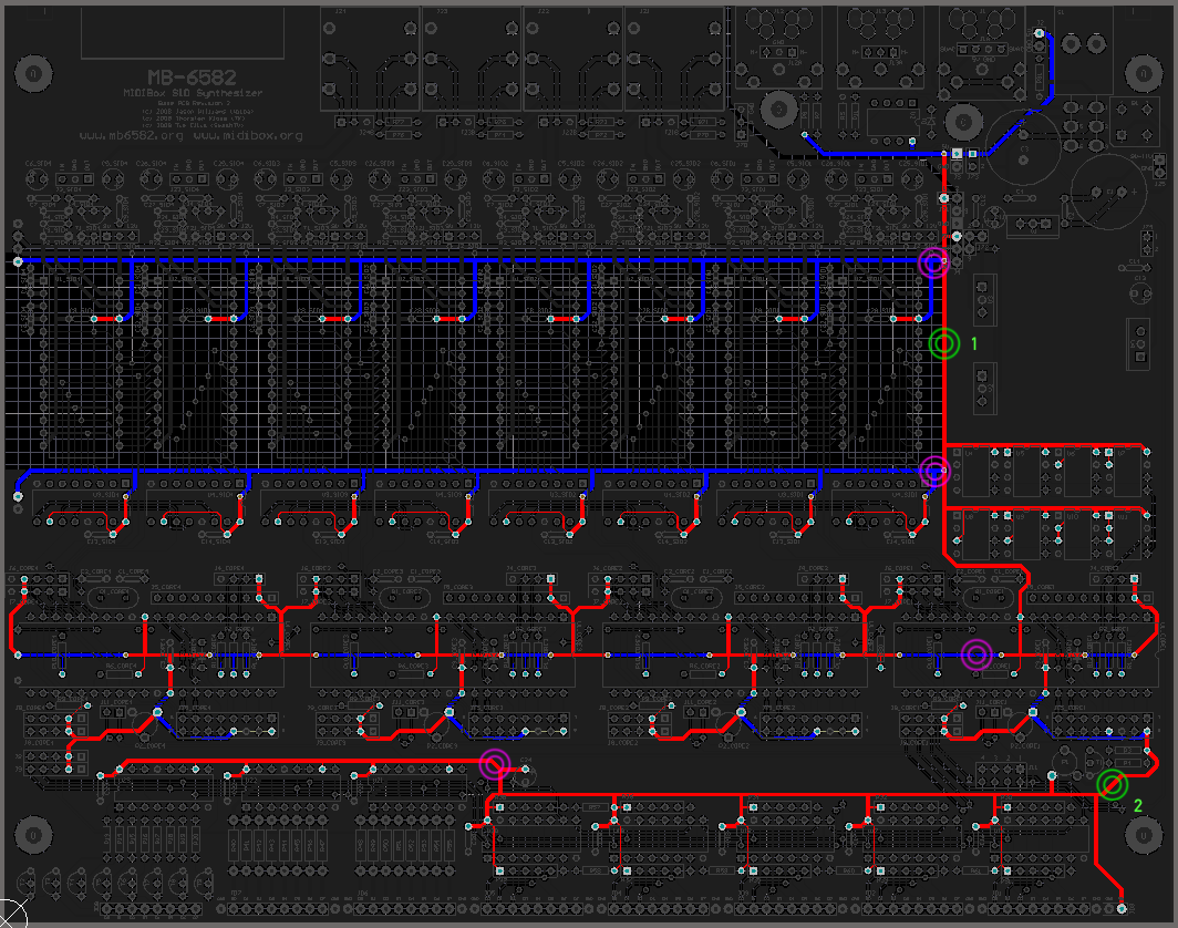

Here’s a picture where I think you should break tracks to discover which section of the 5V tracks are shorting to ground.
Start with the locations marked with green circles. Then you can decide which of the other locations (marked with pink circles) you can use to narrow it down. This is only a suggestion… you want to cut tracks until you get it down to a few pads that must have the short, then you only need to desolder a few components and check if that fixes the problem. i.e. let’s say it’s one capacitor between the 5V/ground tracks that is shorting (the capacitor itself, not solder blobs) then you’ll never find out which one just by looking at solder blobs. Similarly for all we know there’s a short in the copper between a pad and the ground plane. Finding it will be very hard if you don’t narrow it down to a smaller area to look and start removing components.
I wish I could suggest an easier way but there really isn’t, and I think you’ve given up on looking for solder blobs shorting… it probably is something else.
Let me know what your results are after cutting tracks… draw on the same picture showing where you cut and which section is shorting.

I have made 2 cuts per your instructions. The first cut showed that the short is in the upper section of the PCB. So I made the second cut to seperate the sid area. when I test sid pin 25 (5v) to another 25 there is polarity as expected and there is no polarity at ground, yay. However, when I test pin 14 (gnd) it still shows polarity to ground as expected but it also shows polarity to 5V at J3 or J4, however there is no polarity between pins 14 and 25. So should I just ignore that and focus on the section above the first cut where J2,J3,j4 etc are?
You’ve cut only the 5V tracks… all the pins that should be connected to ground still are connected.
So when you test pin 14 of the SID socket (ground) to 5V pins at J3, it’s showing as connected. That’s OK.
You can now test between any of the pins connected to 5V (like the picture of the 5V tracks) and any one of the ground pins (i.e. at J3 or J4).
You’ll then notice that there is no connection in the SID sockets, and hopefully nowhere else lower than your cut track at point #1.
Perhaps you should now refer to the first picture I posted, showing the 5V tracks connected to the power socket and the switch.
Start desoldering the joints connected to these 5V tracks. You don’t need to remove parts yet… just take off the solder. Just use desoldering wick/braid to remove the solder and check there are no shorts between the pad and the ground plane. Retest if 5V/ground are still connected after each joint is desoldered.
