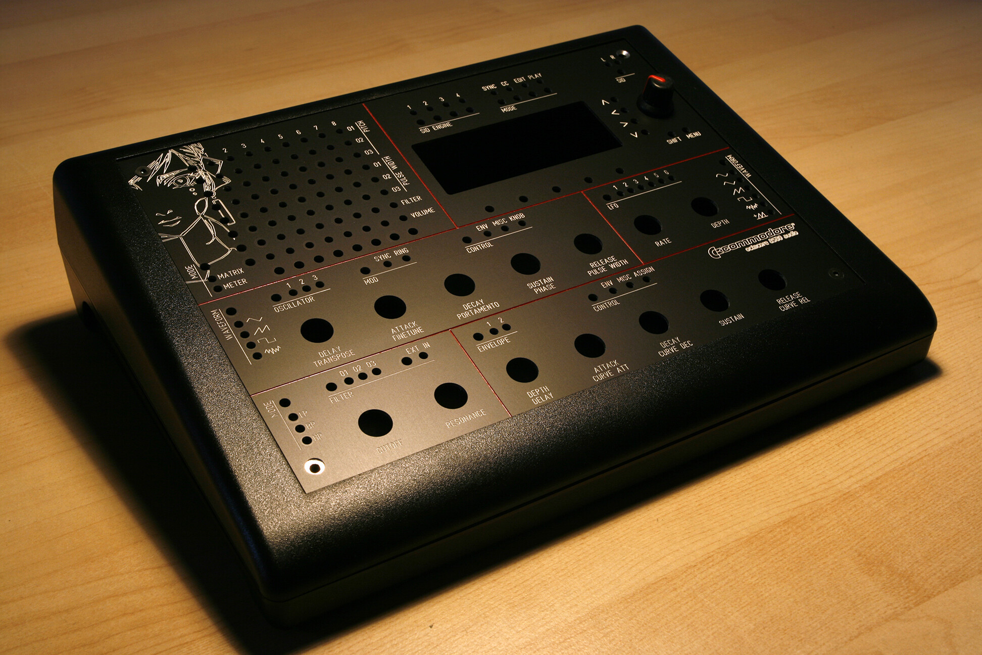

Hi folks, just added two HPGL line engravings to the standard frontpanel design.
Upper left: a nice manga converted to vector and plotter outline. Lower right: commodore “octacore 8580 audio” logo.
Additional price at FPE: ca 15€, costs now 111€.
Hope you like it. Will sleep this over and if i still like it tomorrow, order at FPE soon.
If you are interested in the Corel-Draw .cdr, HPGL .plt or Frontpanel Designer .fpd files, just tell me, I will share them gladly.
Thanks for your help considering the options with screws and glue to bind frontpanel and interface-pcb!
I will do it now as many people do it: 4 screws in the corners (flathead) through the case mounting holes AND the pcb,
and about 20 spacers directly glued to the backside of the frontpanel.
Bye!

Wow man thats awesome!
I am insanely jealous.
I thought a panel would with a commodore logo would be cool, but i never actually thought of adding it myself, i didnt think there would be enough room.
If a tribute mb-6582 was ever built for Bob Yannes, it be cool to get one made up with his signature.

The panel has been very well manufactured by FPE/Schaeffer AG.
Just eating the gummibears that came with the package and waiting for SmashTVs parts delivery ;-).
Can´t wait to hear ´em 8580s screaming. Thanks to all of you who have made this great project possible!

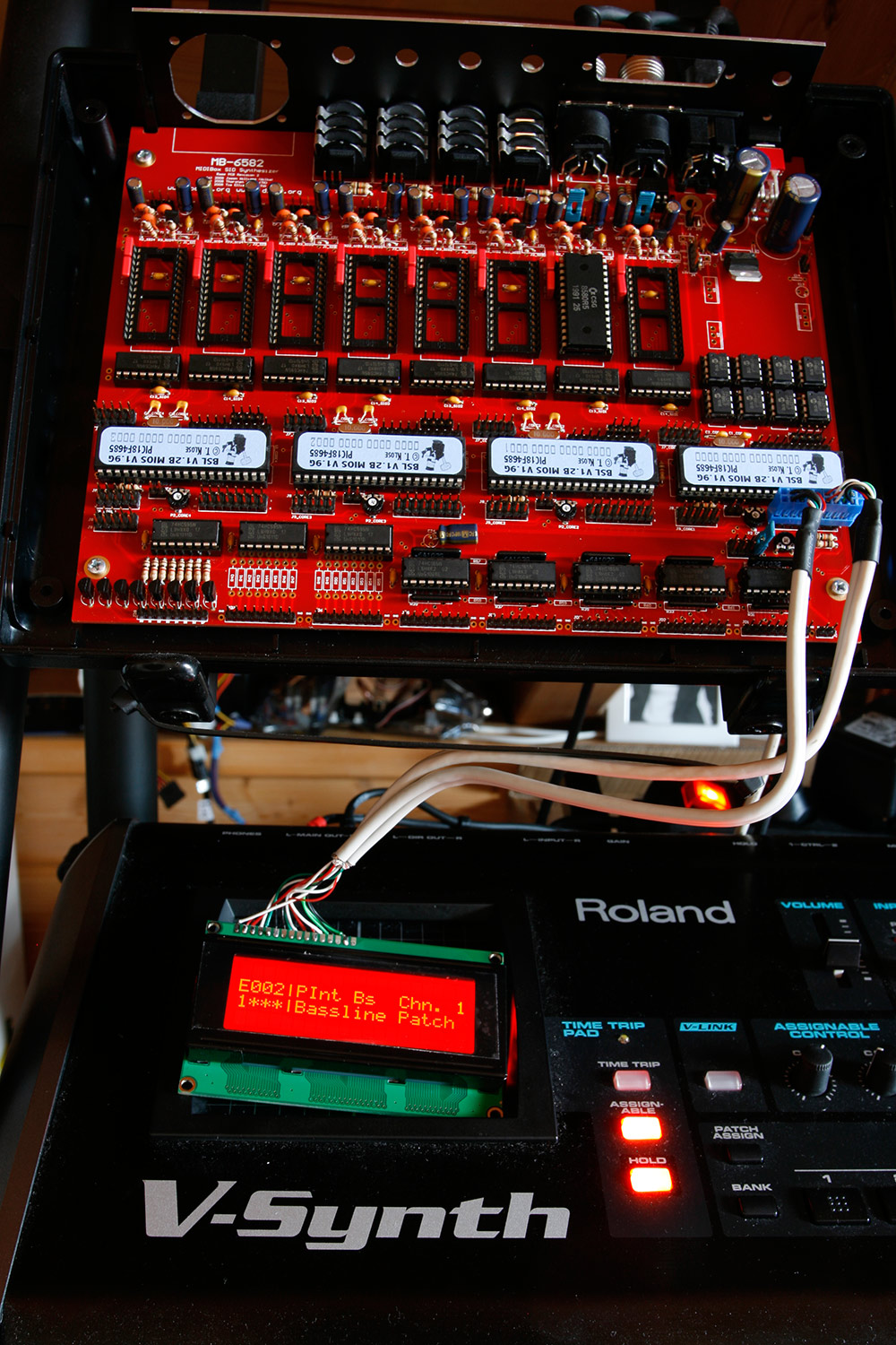

Ok, after a ridiculous session at the german customs (buerocracy to the max), I started soldering the base board. After that session, my back and head was hurting like shit, my hands were shaking and I was high on solder fumes :). Was a lot of fun and is far from finished yet. I broke the capacitor C2 while inserting it and the SID output sections are still missing :-(.
Thanks for the great and complete kit and documentation Wilba and Smash, and of course for the concept, TK!
Hola!
The MBSID base works, just a few days after the parts package arrived from SmashTV…
Had a great time building it, now letz move on to the CS :-)…
By the way, Rutger´s Patch Librarian rocks (for those still CSless like me, it is great to get a preview of what will be possible with the control surface).
Aaah, and the 8580 sounds yummy, btw. Never thought the low pass filter would sound so nice… Very cool!
My only problem during build was a datasheet error for the LCD - they printed the wrong polarity for the backlight - but it was cheap at 9USD from China though, you cannot ask for a correct datasheet, i guess :).
Ah, and ups, gotta insert that C2, but it runs without it, too :).

I should warn you, the connector you use at J15 (i.e. the LCD connector) is most likely not going to have enough clearance with the control surface PCB when it’s all assembled in the case. This is why I recommend an IDC connector/ribbon cable, and not inserting the “stress relief” part of the connector. Just a heads-up so you can plan another trip to the store :wink:
Wilba, thanks, great master (bows), i know about the connector, just ordered a flat one yesterday @reichelt. Greetz!
