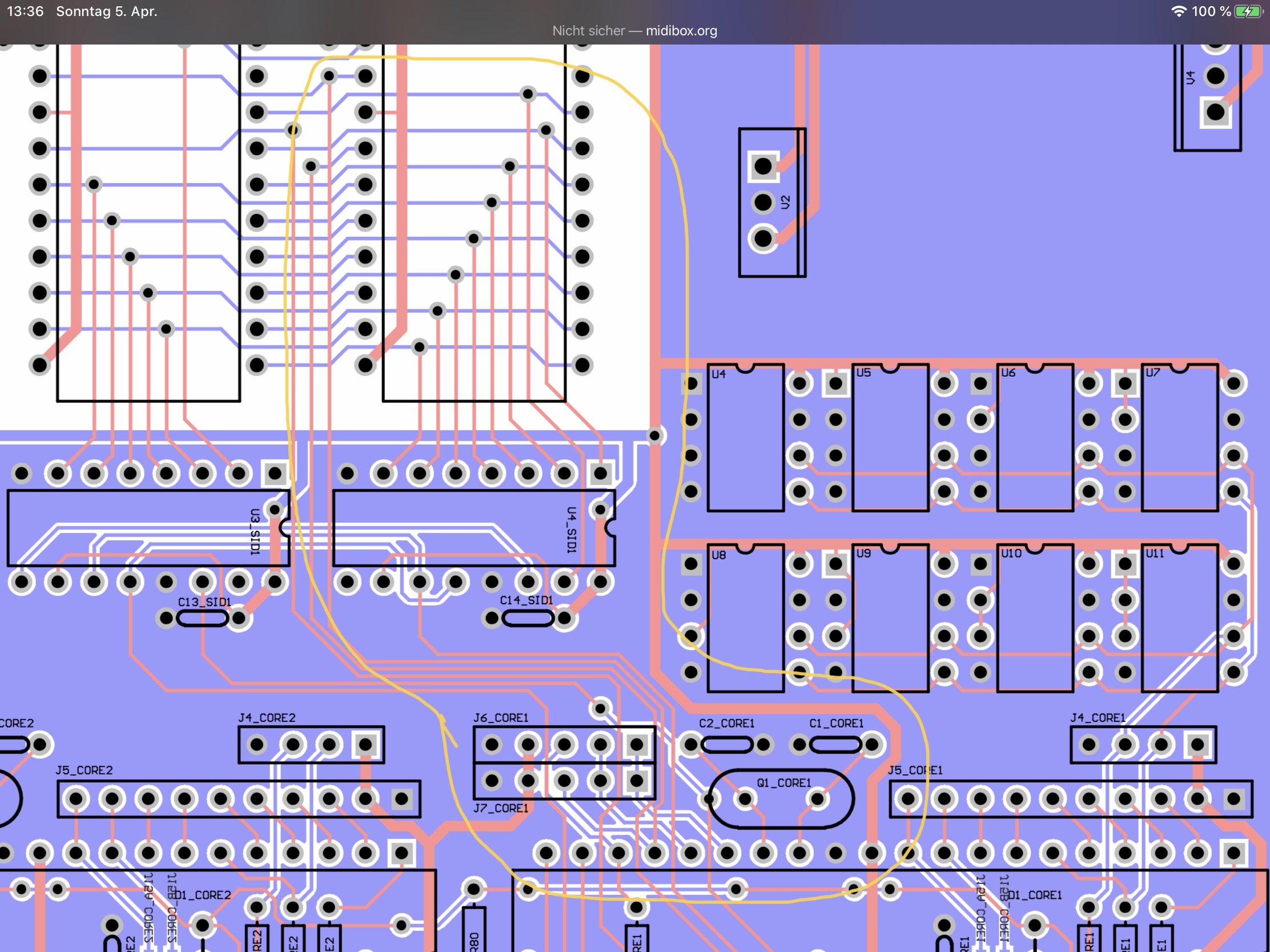

It seems to be output related but I’m some percent sure it also could be data-path and clock related. I would check and reflow the data lines from Core to SID and the quarz.
(yellow marked area)

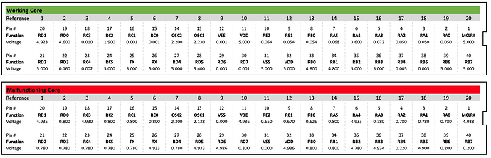

I started out by comparing the voltages on core1, relative to my properly working cores (2-4) and here’s what I see…
I’ve been over all the points and joints countless times, so I’m really scratching my head with this one…
