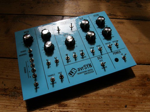

As j00lz said, drilling the holes is not a big problem, even the LCD cutout is well doable with a bit of filing and time :wink: For labelling I sometimes use laminated printouts glued to the panel. That works pretty well, the only hard/time consuming thing is to get the holes to look nice.
You can see my go at it here: http://www.flickr.com/photos/34559421@N02/sets/72157619960055010/
Quick overview:
Print out the artwork and glue it on the panel, drill the holes:
Put double-sided sticky tape on it:
Stick the laminated panel printout on it, and cut the holes into it:
Mount the components:
Done:
