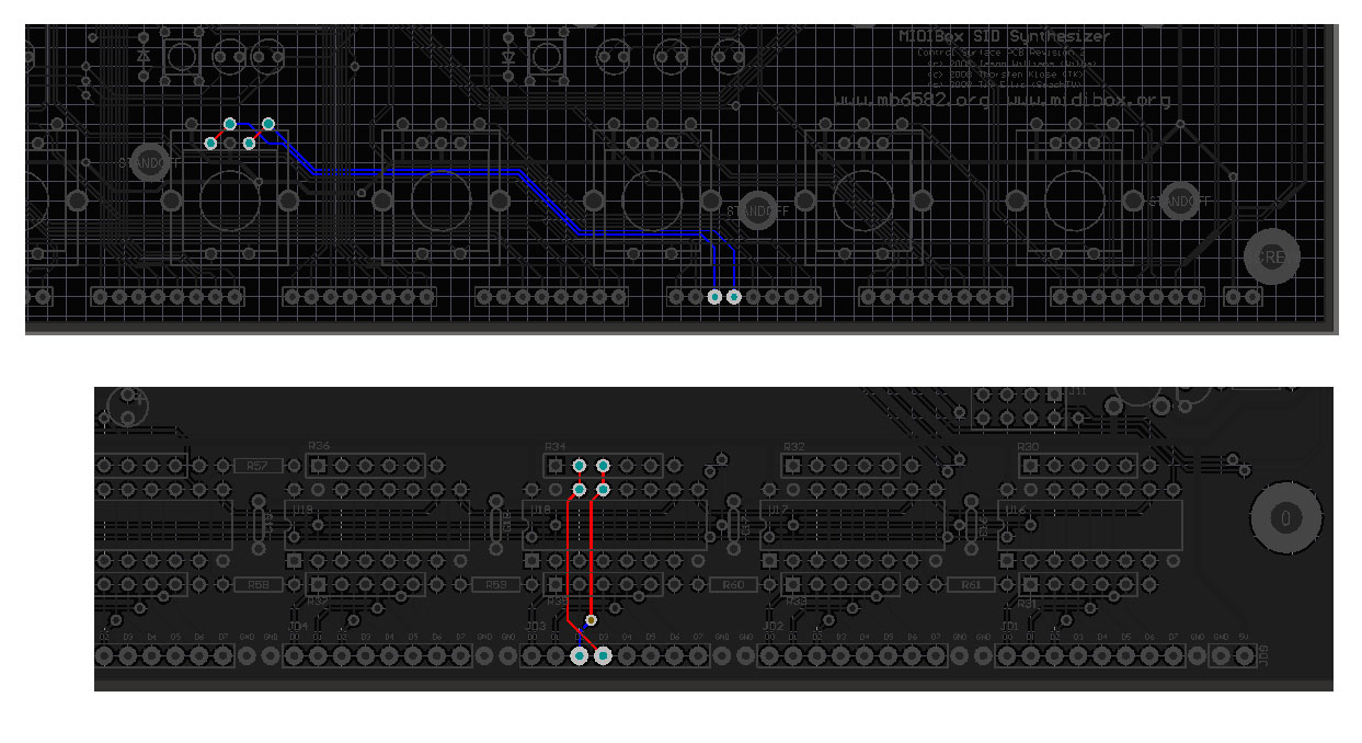

Update :
As it turnes out with an encoder stuffed (i tried two different ones) the result is the same. Depth values go up to 127 and barely nudge from that value. On certain occasions the CS freezes on the envelope screen i.e. everything works but I can’t navigate back to any other editing screen. Note : this doesn’t happen when there is no encoder stuffed.
I’m shure there is a short or damaged track/pad somewhere thats causing this behaviour in the envelope section but following the tracks from where the encoder used to be I see nothing wrong with the PCB.
Could it be the 165N’s?
Encoders only going in one direction suggests that one pin is always shorted to ground. This could be at the encoder (one pin of the encoder is always connected to ground) or it could be in the tracks leading to the bottom, the cables or on the base PCB.
You should be able to remove the ICs in U16-U19 (to be sure) and with power off, test continuity between ground and the two “signal” pins of the encoder, while turning the encoder, you should get “beeps” from the multimeter from both pins. Both pins will be connected to the 5V rail via 10K resistors but this shouldn’t affect continuity testing between the pin and ground, I think.
I have found a short between pins D0 and D1 of JD3. These pins are also shorted to ground. Resoldering the wires hasn’t solved the problem. Taking the “DEPTH” encoder hasn’t helped either. I triple checked the tracks and it looks like there isn’t anything to cause a short starting from U17 all the way upto the encoder.
Also I have uploaded the LED test up. All the LEDS that didn’t work still did not light up apart from the sync led. Does this one work only when there is a master MIDI device connected to the MB6582 and it’s sending tempo info?
Thanks
“Sync” LED just isn’t used yet… I had planned for it to toggle between master and slave (i.e. LED on when it’s slave to MIDI clock) but I never got around to actually coding it up (or suggesting to TK to do it).
Re depth encoder, can you check you’re testing the right pins? The Env Depth encoder isn’t connected to D0 and D1 of J3, it’s actually D2 and D3. See pic.
Regarding shorting to ground… this CAN happen depending on the position of the encoder, i.e. those pins WILL short to ground as you turn the encoder, that’s how it detects the turn, as one or both will be shorted to ground.
Wilba, thanks that picture really helped. The fault was in the IC in U18 after replacing it with a new one everything just worked perfectly including the MOD Matrix and all the LED’s that wouldn’t light up before. Now I have a question, is this normal? Does the 74HC165 actually make all of that work or have I fixed something without knowing it?
