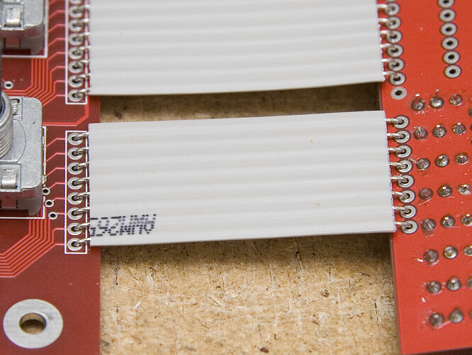

The ribbon cable I use is tough stuff… the insulation is quite stiff and the wires are thick and practically solid, as it appears like they’ve been dipped in solder before being put in the ribbon. As such, you need to pre-bend them 90 degrees and solder them flat. I’ve attached a picture of how I did it… this is TK’s box but I did the same technique on my original MB-6582 and that’s been opened and closed many times after I finished it!
Man that looks pro! Mine connections, well, do not look like that :slight_smile: That picture really helps explain things. I think if I had done it closer to that the first time, it probably would not be as much of an issue. Part of my problem, I’ll admit, is likely speeding through the process (I think the Wiki even says to take your time :P). The other problem is that, while the Digikey cables might be close, I don’t think they are exactly the same?
