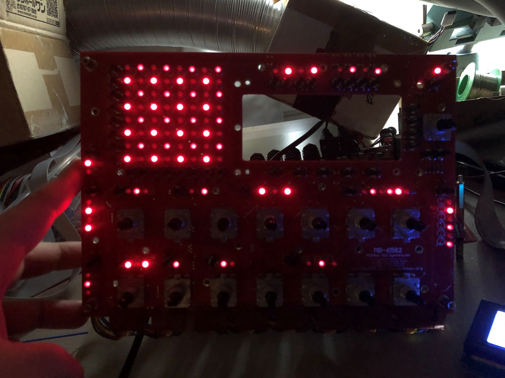

My almost complete MB-6582 (feedback pots missing) is having a strange issue where all LEDs light up in checkerboard pattern, no buttons or encoders respond.

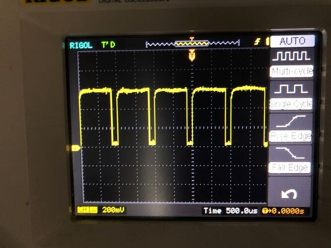

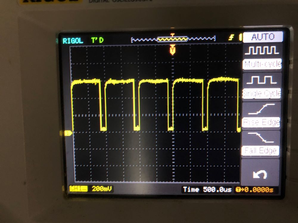

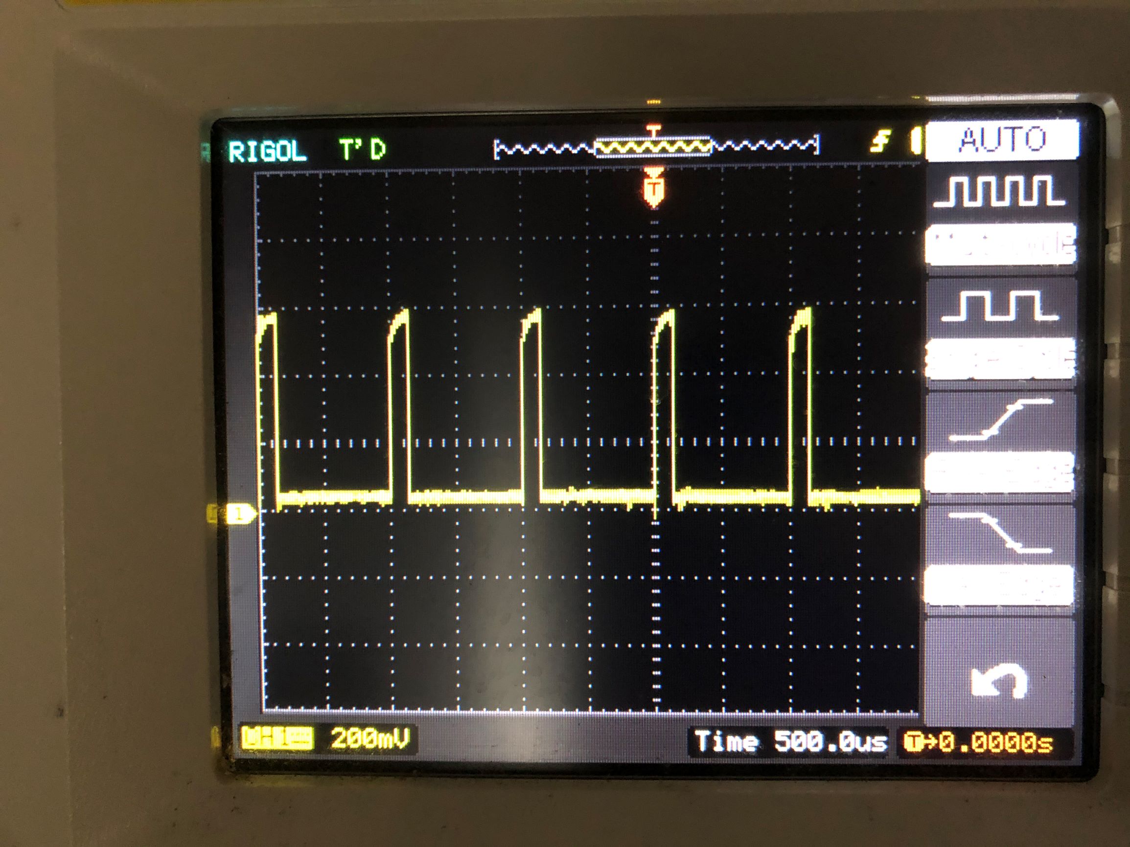

I have attached some photos also of oscilloscope capture of the signal that turns on every other LED. It seems the wider pulse is turning the LEDs on,
but the off LEDs also see a short pulse.

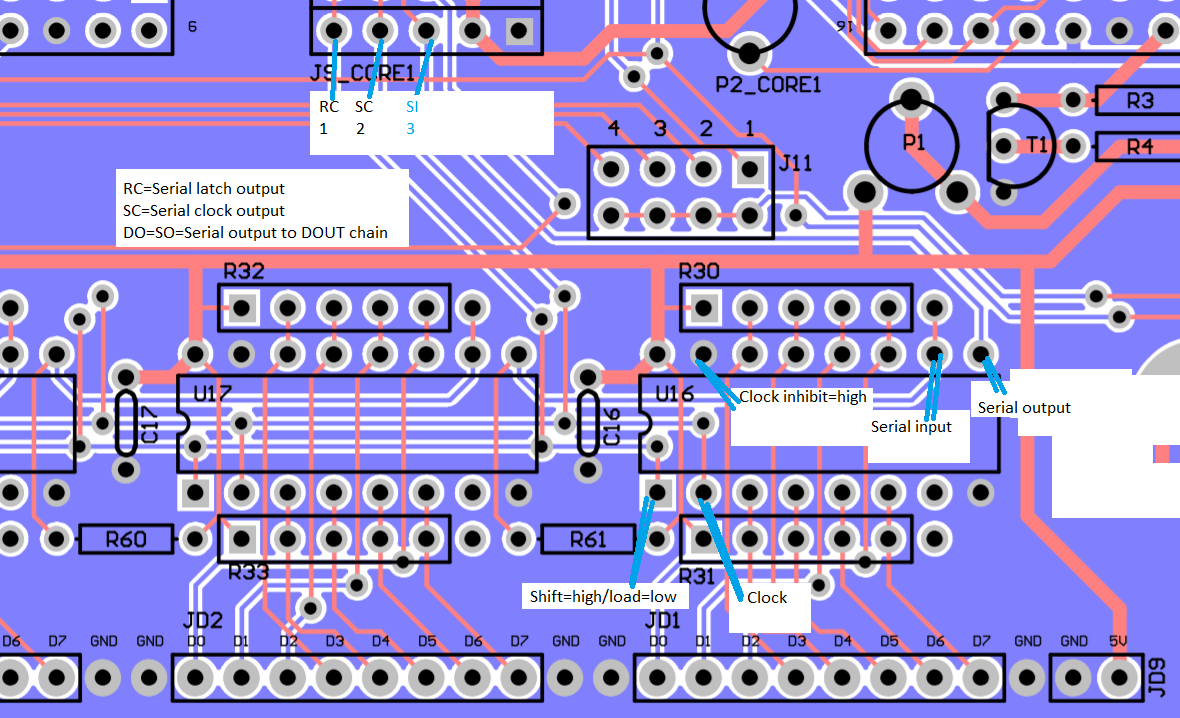

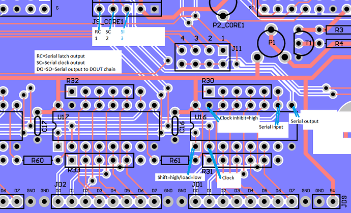

-Looking through the PCB layout drawing and datasheets of HC165/HC595, put back in the MB6582 software and started measuring voltages at the HC595 and HC165 pins. At the pins of HC165 I noticed that the SC line was practically constant around 5V with some 100mV noise from the other serial lines (RC…).
Attached also my crude picture indicating which signals should be where.
