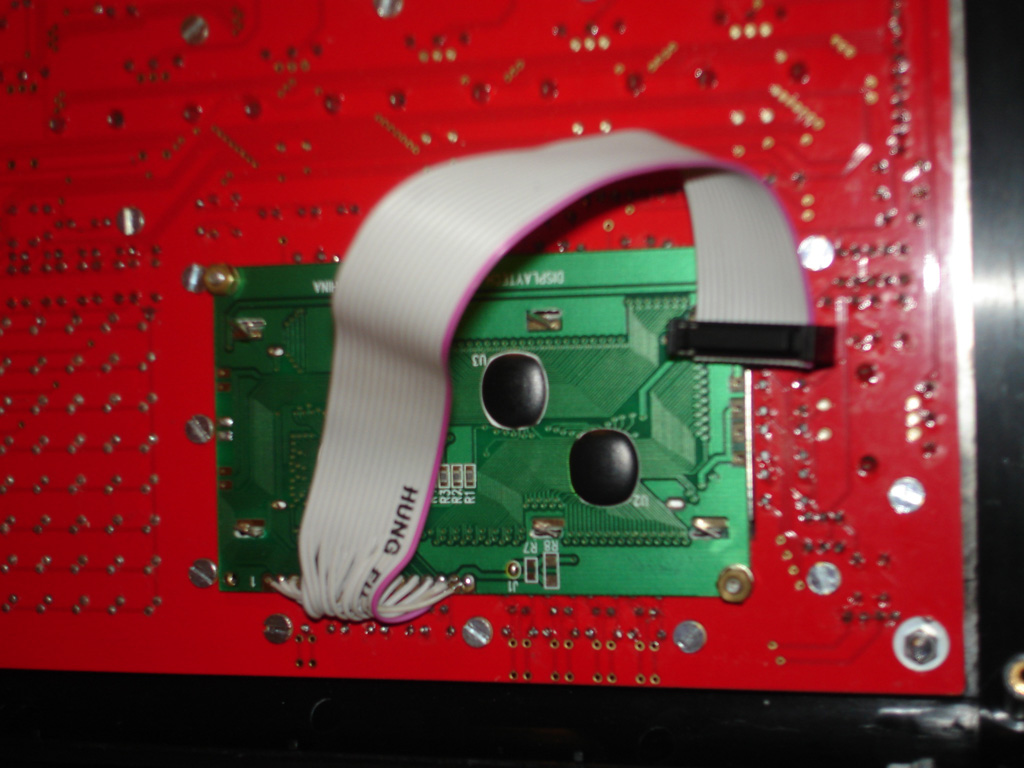

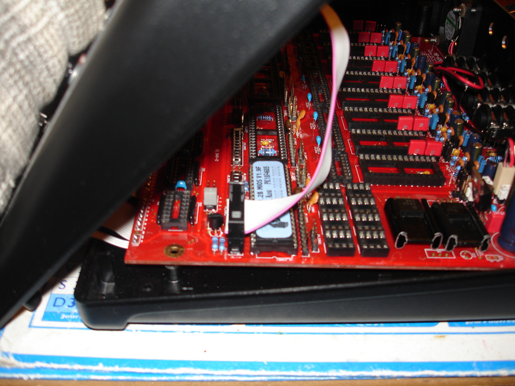

I’m not very sure if i have correctly mounted lcb ribbon into connector, perhap i have made a mistake !!
Please could you tell me if that’s the right way in the photo
Thanks !-]
I don’t think there’s any way to tell from the picture. It depends on what order your LCD’s pin sockets are in and which way you soldered the wires (which are hidden in the pic).
Anyway, once you do get the LCD sorted, I always write a big letter ‘C’ on the part of the cable that is closest to the CORE. And I use White-Out ink correction fluid to make a letter ‘T’ on the Top side of the IDC connector (top for me is the edge of the board where pins 1 & 28 are). Sometimes one letter is easier to see than the other. That way I don’t have to think about it much ever again.
Ok snoozr perhaps with this picture it will be more easy to check ?

That LCD cable looks way too short, but I guess it works. I like to have mine long, and “rounded”, going up and around the CS PCB. You can see it in the photos.
A longer cable will also allow you to open it up completely and still have the LCD connected, which is good for troubleshooting.
I suggest removing the LCD from the CS PCB and testing it that way.
Also ensure there are no shorts between the LCD’s pins (where you soldered the cable) and the CS PCB. This CAN HAPPEN and cause buttons to work, maybe even making the backlight stop working. I insulate with sticky tape, but a piece of thin card or electrical tape will also work.
Perhaps you should now try taking out the shift register chips on the bottom of the base PCB, thus disconnecting the two PCBs almost completely… and get to a known good starting point, such as, MIOS installed and the LCD working.
Not really, we need to know what LCD you’re using first.
Whats the name of it, and can you link us to the datasheet?
You will then need to look at the Pinout, and check it with the wiring with J15 of core 1:

ok thanks for the informations, i check that tonight but perhaps that i have inverted pins ??? About lcd i have bought it to Wilba, i havn’t the datasheet and don’t know the brand …
i will answer you after checking !
Ok great Smithy, my lcd is working now ! the problem was i had inverted ribbon with connector ! I’m afraid that my previous lcd is definitvly dead …
