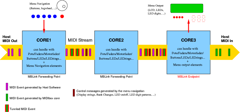

"If a big MIDI system with a complete menu navigation for multiple cores should be realized, the use of MIOS is highly recommented, since this operating system is much more flexible compared to the old PIC16F firmwares. Here a possible solution:
The first core provides the menu navigation interface. It sends control messages to the last core which handles with the output elements like LCD, LEDs, LED digits. Other core modules between the first and the last one can insert additional output messages into the MIDI stream if necessary.
Optionally, the first core could convert incoming MIDI events to control messages and send them to the other cores in order to access the soft-overtake function of pots, to move motorfaders, to change the patterns of LED rings directly. It could also send messages which assign MIDI events to pots/faders/encoders. In this manner, several setups (banks…) can be managed by a single core to reduce the programming effort."

So would it be possible to have one core looking after the user interface, 8 motor faders and 64 led ringed encoders.  The second doing the same but with 2 40 LCD’s for the motor faders.  The last core using a graphical lcd shows you the information for the selected controler (like midi channel destination and controler name) and uses its buttons and encoders only for navigation and user assigned keys?
Can banksticks connected to all the cores connected be accessed?
Sure, that are nearly no limits! :slight_smile:
But keep in mind that you have to program the control software by yourself. I’m only able to provide example codes (more are coming soon, also for multichip setups!) and some applications which are used by myself. And I can give a couple of tips, how to solve particular implementation problems with MIOS… but everything else has to be done by people who at last build the hardware.
