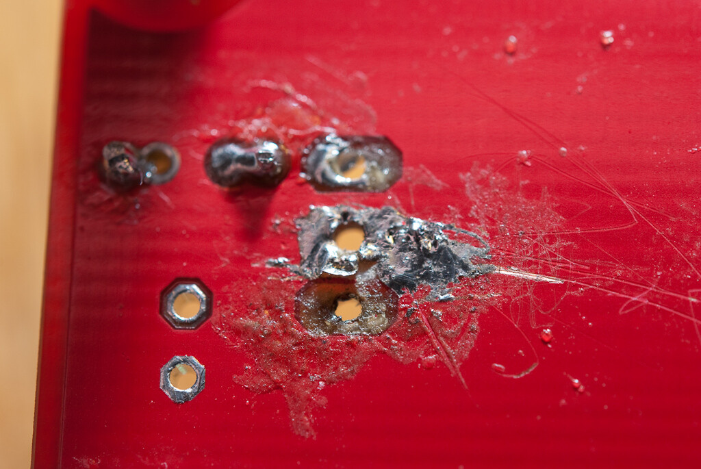

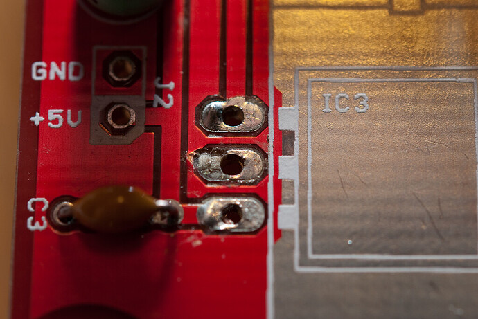

Well, the AS3 probably would have been ok if I wasn’t so mess about it. I think the problem started there but is now well beyond just that. First, I pulled up pads while trying to desolder the 7805. I also have some cuts into the ground plane that I made unknowingly last night while trying to separate a big blob of solder that connected between two of the regulator pins. While these are the input and GND pins (not GND and +5V, which is where my short is somewhere) I may have done plenty of damage.
Even if the disaster with the pads can be worked-around (the pads on top aren’t in terrible shape), I still can’t find the short between GND and +5V. Been looking at the board with the magnifying glass for over an hour and the only thing I can point my finger to is the pads.
Ugly photos attached. Sad but hopefully it doesn’t discourage anyone else :slight_smile: Just sending out fare warning to watch the heat of your iron! I think I was probably fine until I had the brilliant idea of turning my iron past medium to medium-high.

Doesn’t look too bad there… and no one will see it when it’s finished anyway. Get the braid onto that mess on the ground plane.
Finding shorts between 5V and GND is a pain. There are drastic measures for narrowing it down (like cutting 5V supply tracks to isolate which half of the track is shorting). However it is more likely to be around this big mess than anywhere else.
The 7805 output and the 5V pin of the 100nF cap near it both look a bit messy, you should clean them up a bit and recheck.

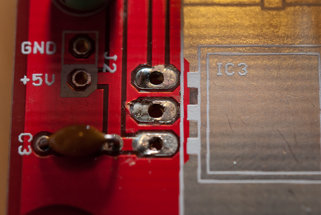

The part that confuses me is that the short is actually the top 2 pins on the underside photo (bottom 2 on the topside). I can’t see any obvious places where there might be problems with those two pins. I think the problem is there though since that’s where most of the damage is, though it’s a bit unnerving not to have anything directly.
I actually got a good bit of detail from the photos I took of The Aftermath (it’s so bad is deserves a proper noun now :). I think I am going to try that same approach for the board as a whole and see if I can end up with better detail by doing it that way over staring through a magnifying glass. At least if I take photos I can take them to work to stare at :slight_smile:
