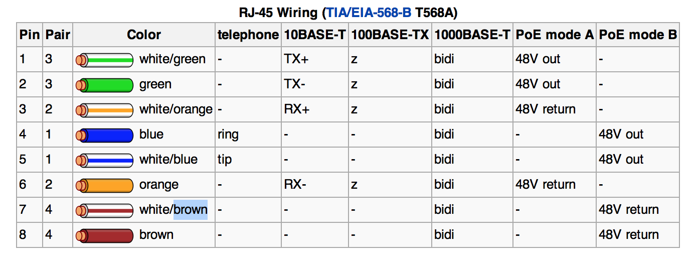

The Schematic of LPC17 Core Module has Pin2 connected with a wirewrap to witch i cant find the doc…
Wikipedia told me that pin 2 should be TD- and pin 4 open, is that a mistake by me?

The MagJack pinning is not identical to RJ45 (you’re comparing apples and oranges ;-))

Yes. True. But.. ![]()
I’m wondering where the third wirewrap wire is going… the one that is connected to the Pin2 on the MagJack.
