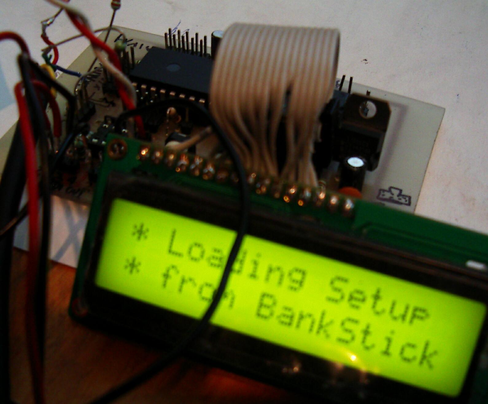

I have problem with my midibox64, i have programmed PIC (bootloader + mios 1.9 + main.hex from midibox64 2.4 via mios studio), mios studio monitor shows echo when i power on (F0 00 00 7E 40 00 01 F7), then on LCDisplay i have this message:
Formatting Bank 1 (blinking)
Loading Setup from BankStkick (blinking)
MIOS v1.9…
and then it stops on “Loading Setup from BankStkick”
Where is the problem, is there my fault or is this some popular problem?

Yes, by “stop” i mean that nothing else is happening. I see only “Loading Setup from BankStkick” message.
It’s the same situation with and without bankstick, it doesn’t matter.
I have 24lc128 EEPROM.
OK so without the bankstick what happens exactly? Tell us everything so we can figure it out best
I wonder if it says “Loading Setup from BankStick” when there is no bankstick
On LCD is only “Loading from…” message and nothing else.

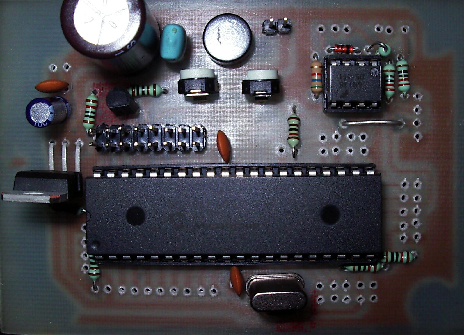

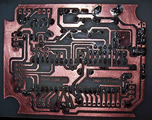

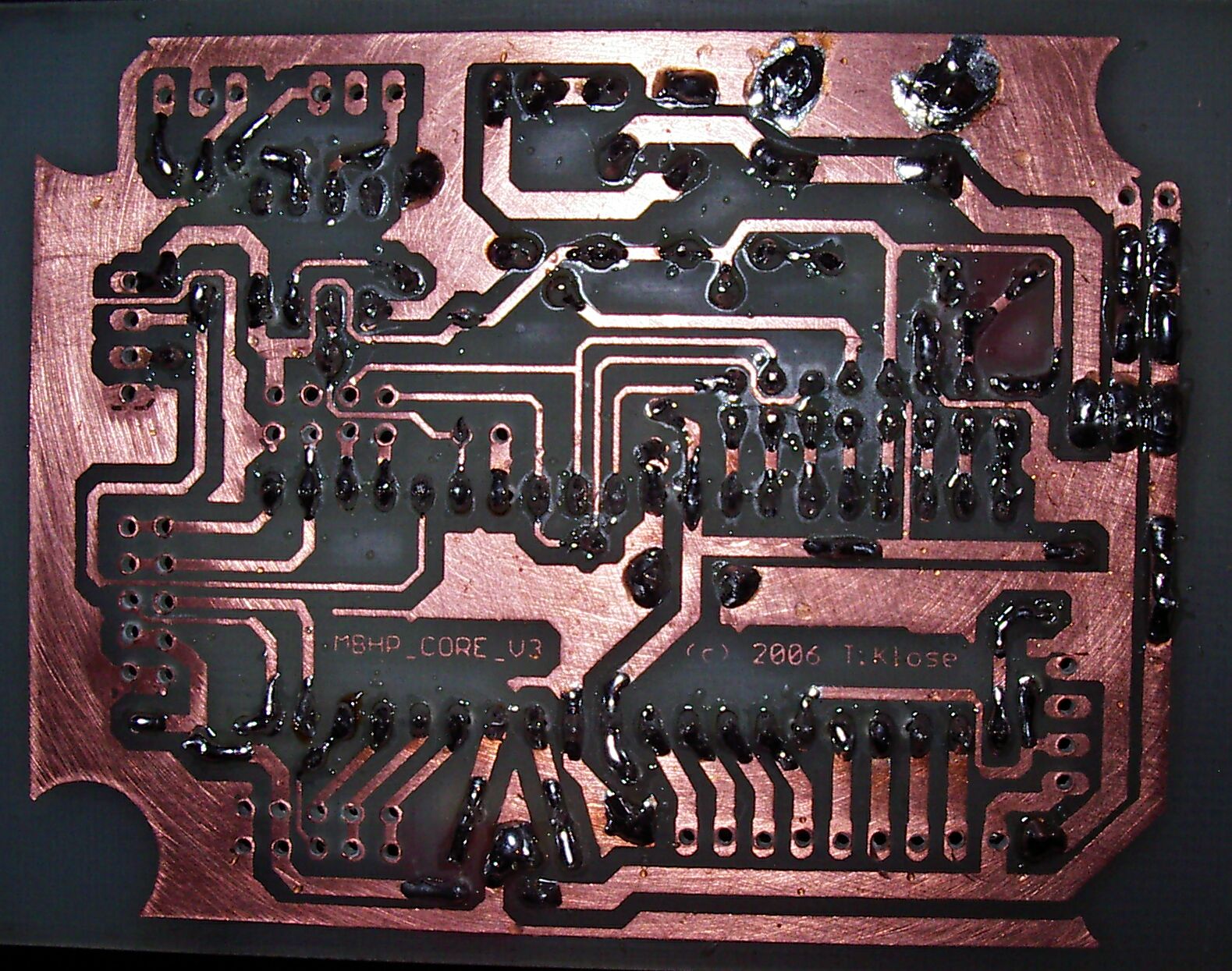

So this is my new PCB, is this looks ok?
On both PCBs i have the same message on LCD.
Can you give me some step by step instruction how should i program PIC, with every radio button and value for selected sotware for MIDIBOX64.
Im not shure did i programmed PIC propertly. We want to have 2 cores for 128 buttons and 64 pots, or is there some other way to have 128/64.

I think you have forgotten to solder the wires at the bottom. Look at the bottom of the core page and youll see what I mean.
greetz
