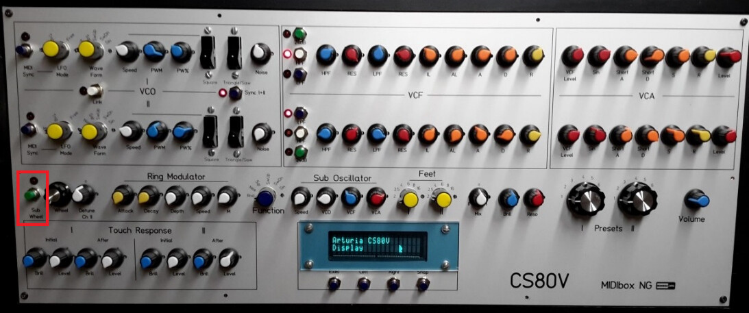

In this version, I’m using a rotary switch for program changes, which may be part of the problem, but I did run an experiment with the latest configuration, eliminating the rotary switches.
In my MIDIBox64 photo below, the rotary switches are on the right - Presets I & II.  For the experiment I reassigned the momentary push button switch (sub wheel) on the left (in red) to be a program change. The push button program changes worked on my previous MIDIBoxes.  Side note: the front panel says MIDIBox NG, but it’s actually a 64.  I have the hardware to make the NG, and will eventually replace the electronics behind this.
In the config file I assigned that Sub Wheel button to select program 1F.  I commented out the original button assignment

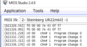

 When running MIDIBox64 2.4f, this is what I see when I push the button - each button push sends a program 0 change.
When I load my modified code for version 2.4, with the altered MIDI_evnt.inc file, and using the same config file,this is what I get for each button push, which is what I would expect.
