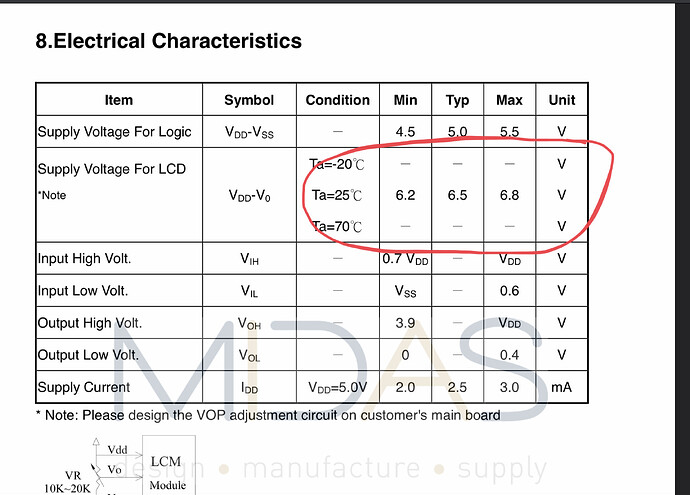

Look at the page you linked to, there is a rating of 5.5v.
By google-ing MC42005A12W I found two pages where supply voltage is = 6,5v

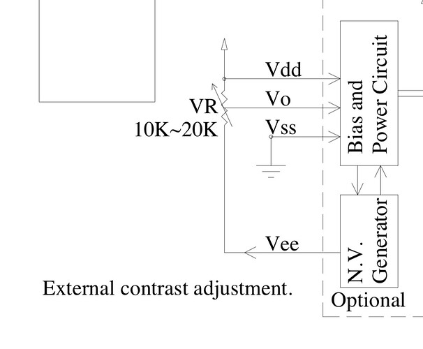

Here they fixed the same problem by bridging PIN3 and PIN15 with a 9.8k resistor.

Pin15 (Vee) on the Midas display is a negative voltage OUTPUT! So do not connect this pin to your Midibox PCB. Instead connect it like in the circuit from the data sheet with a 10k-20k trimmer to Pin3 (Vo) and Pin2 (Vdd). In this case Pin3 also must not be connected to your Midibox PCB.
Hey everyone, problem solved!
I followed the instructions in the link, and by removing pin 15 and 3, and shorting them with a 10k resistor did the trick. Also, turns out that this screen takes - power, so I had to swap pin 15 and 16 around. But so far this screen does seem to work!
