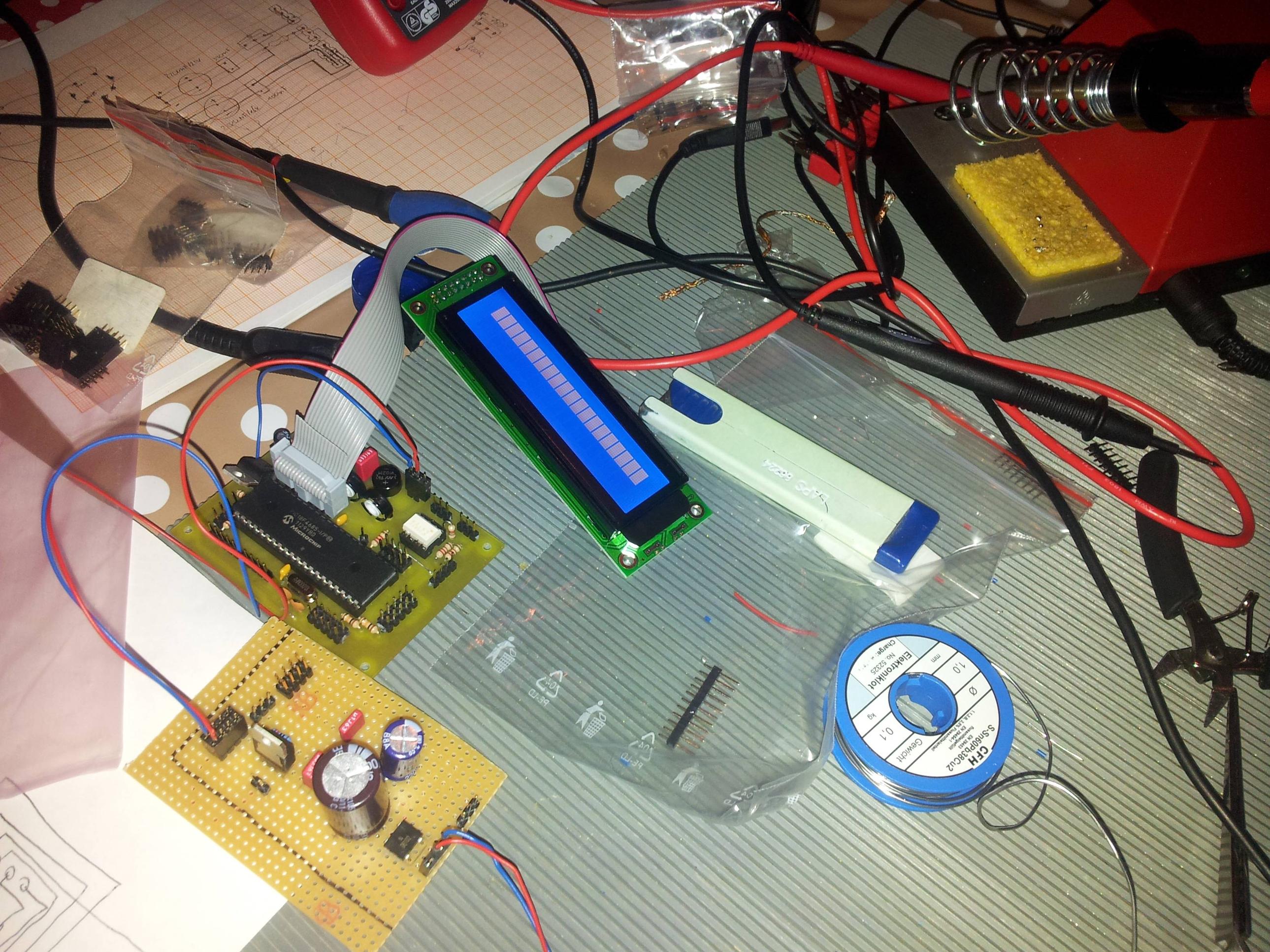

I got the LCD up and running but I actually did have to add a 75 Ohm resistor. So I spliced open the ribbon cable and just soldered it in between. Works out nicely!
(Don’t mind the temporary cables everywhere, I’ll sort that mess out soon :rolleyes: )
