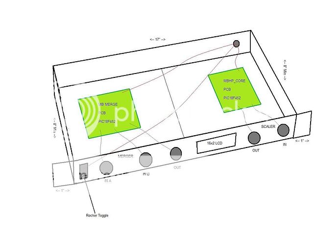

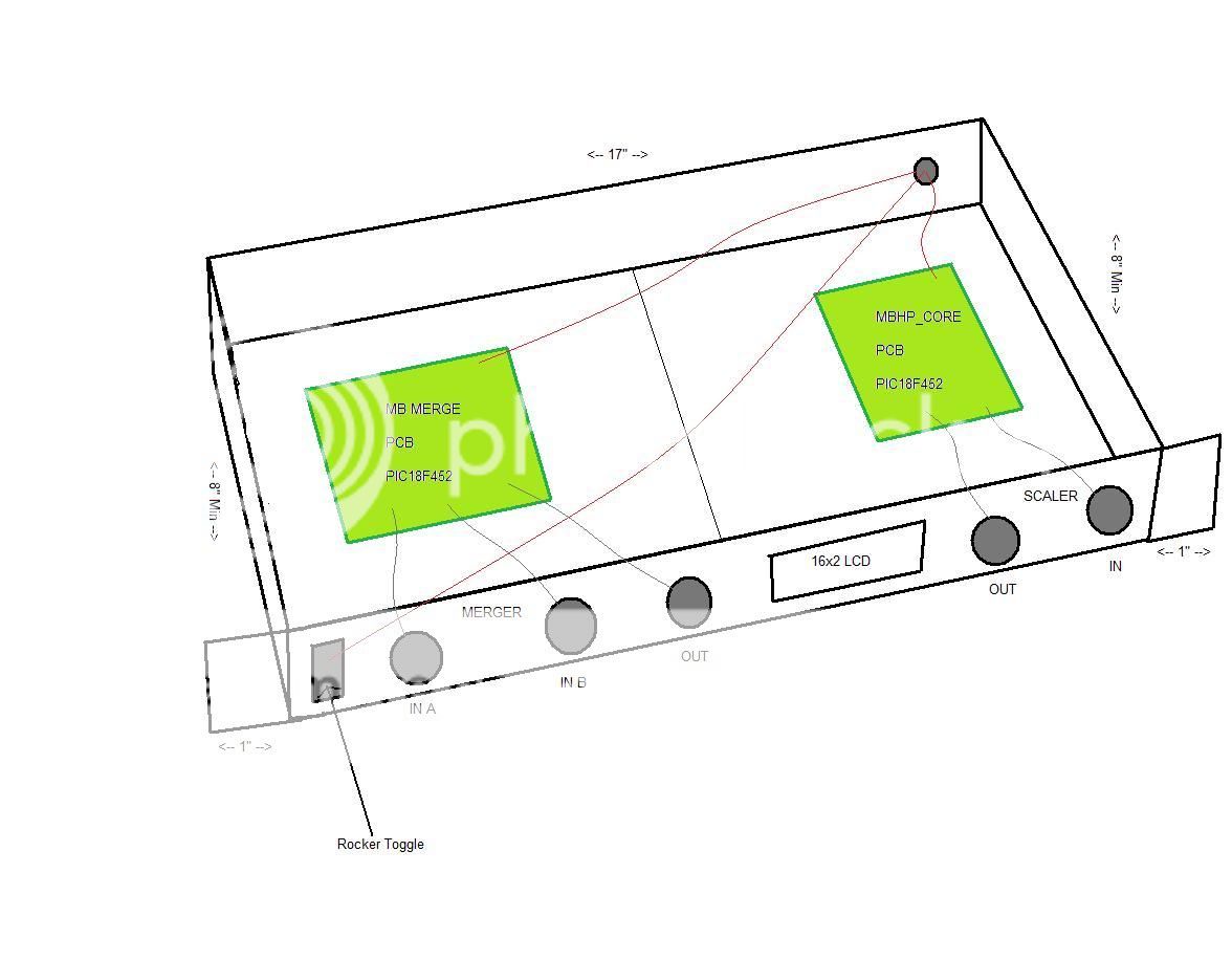

I’m having some problems with both the hardware and software side of my project now. Here is a crappy MS Paint picture I drew of what I wanted to build before I started, that also includes a MIDI merger module which I am still constructing:

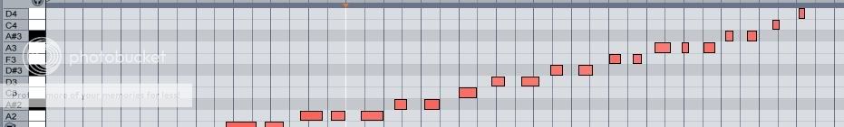

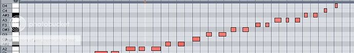

My other problem is that the scaling program doesn’t scale my MIDI notes correctly. In every scale I have tried the program misses out the root note itself. For some scales instead of simply missing out the root note it inserts completely the wrong note, and in some cases on the wrong octave. For example when set to G Major, instead of simply missing out the root note when I press G on my keyboard, it corrects to an F which is incorrect for G Major. Here is an example of G Minor, where the program simply skips the G note altogether, but the rest of the scaling is correct:

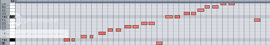

Now here is an example of when the root note is not just missed out, but replaced with an incorrect note, and on an incorrect octave. This example is root note E, and scale set to Aeolian (Minor):
You can see instead of skipping the E this time it inserts an F which is an incorrect note, and inserts it on the wrong octave.
