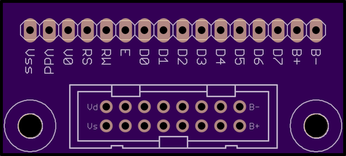

Just created an adapter and ordered it at OSH Park:
(The J15 connector will be mounted upside down, therefore the pins are mirrored - it’s 1:1 compatible with a 2x20 CLCD, the same cable can be used)
Three boards are available for $7.40 :smile:
Best Regards, Thorsten.
Actually, the Osh Park boards allow for very low tolerances even for traces / pins close to the board’s edges, so you could probably even decrease board size some more.
