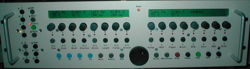

Feature: Adaption of the Logic/Mackie Control emulation to the MIDIbox SEQ hardware for the final mix-down (yes, it already works ;-)) - motorfaders will be simulated by every second encoder.
Here some quick snapshots, how the MBLC emulation looks on the MIDIbox SEQ hardware.
8 encoders are used as “V-Pots”, the remaining 8 encoders as Motorfader-replacement (mostly controls volume).
The Jogwheel function is available (17th encoder), and there are 3 button layers to which the LC commands are assigned
(of course, it is possible to add even more buttons (up to 128-2*17 = 94 button functions) and LEDs (up to 128), and to customize the button/LED in order to assign LC commands like desired - the MIDIbox LC application is really flexible :slight_smile:
And it provides a “general purpose” mode with 128 additional MIDI parameters
Common view (the tracks are selected with the Bank +/- buttons)
View of a VST plugIn:
Editing VST parameters:
The screens look a little bit scrambled. The reason is, that it has to be stretched from 2x55 to 2x80, so that the displayed parameter labels and values are exactly above the appr. V-Pots.
There are 4 different display modes with alternative views, e.g. one where the 2x55 display is centered (no scrambling)
Best Regards, Thorsten.
