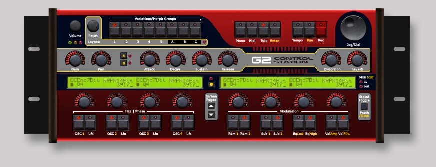

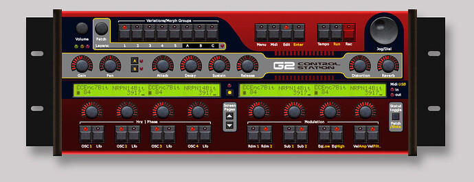

this is the way to go…
what is the soft that create such great Panel ???
