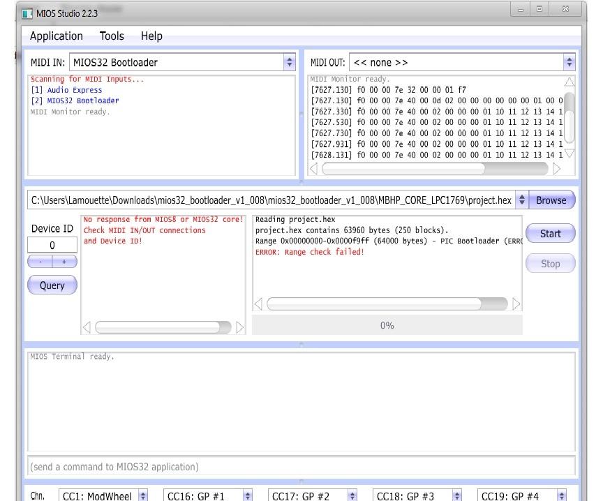

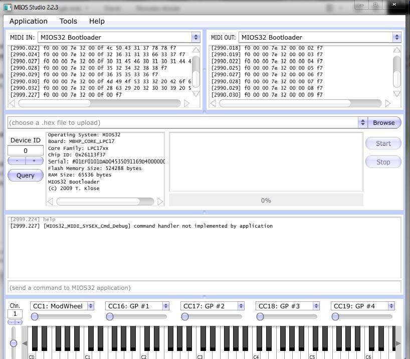

LCP17 No boot Mios studio

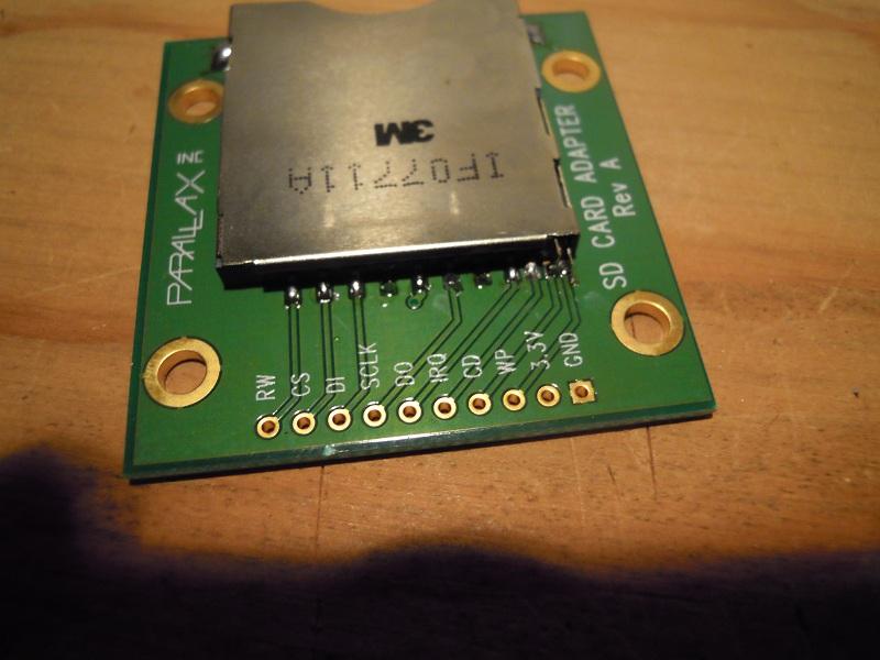

SD CARD Adapteur - 1

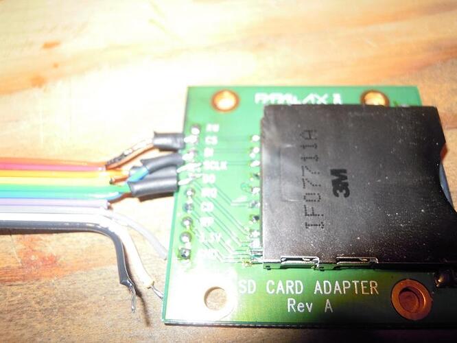

SD CARD Adapteur - 4

Mios Studio detection
Bad thing : nothing happens when i try "help"… :purple:

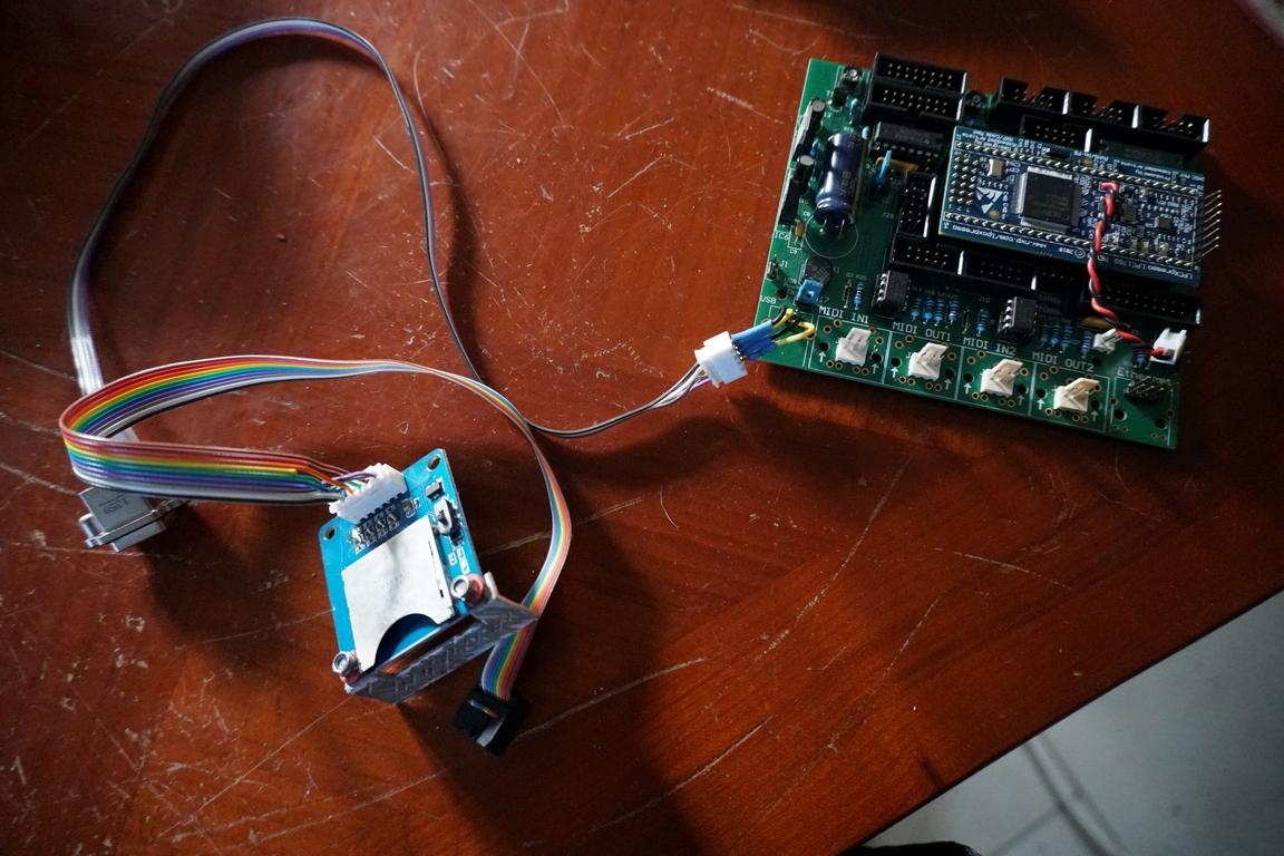

DSCN1872

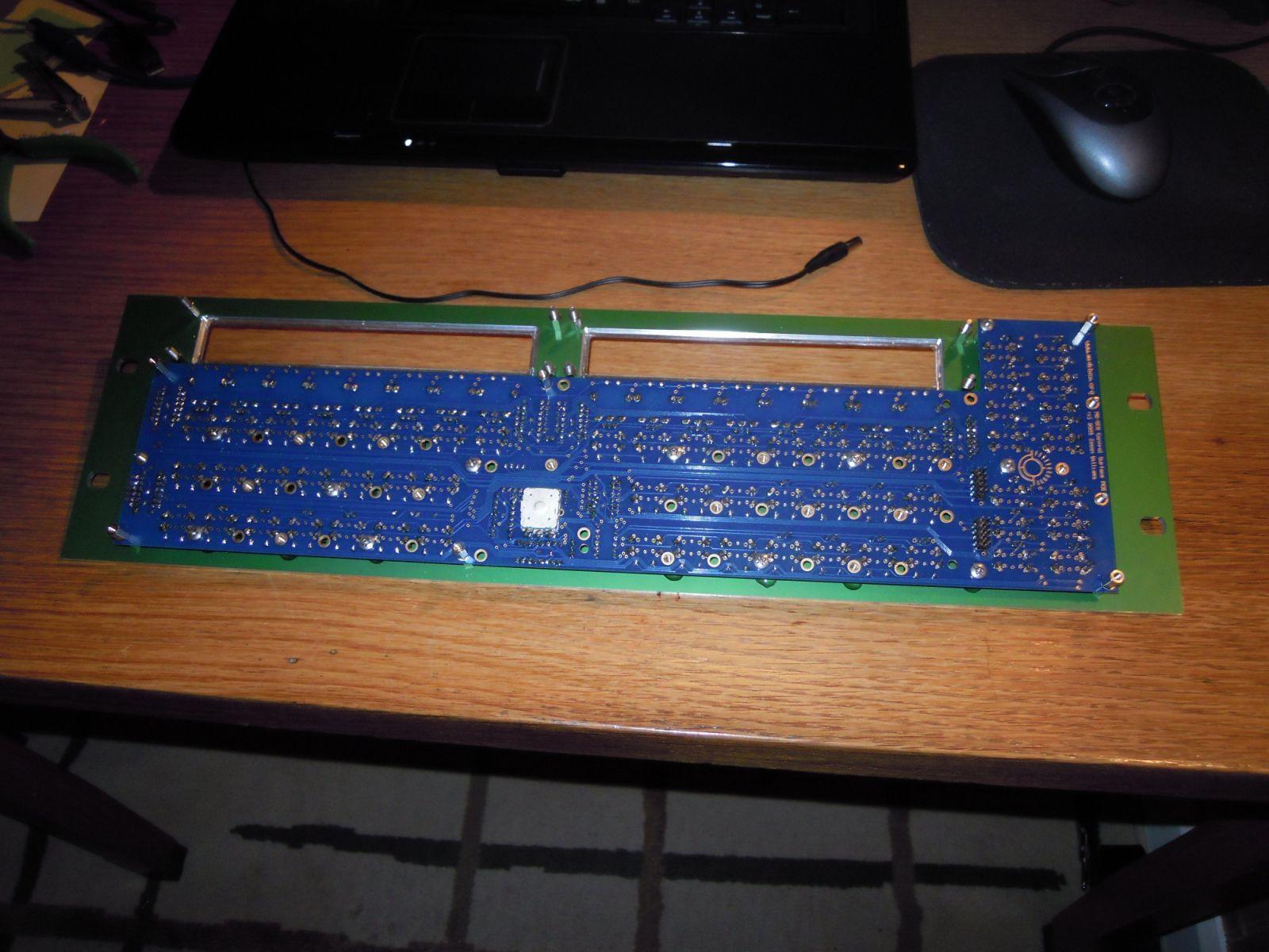

Assembly of the LCP017, the SD Card adapter, and the 2 screens ! I’m on the way !!!

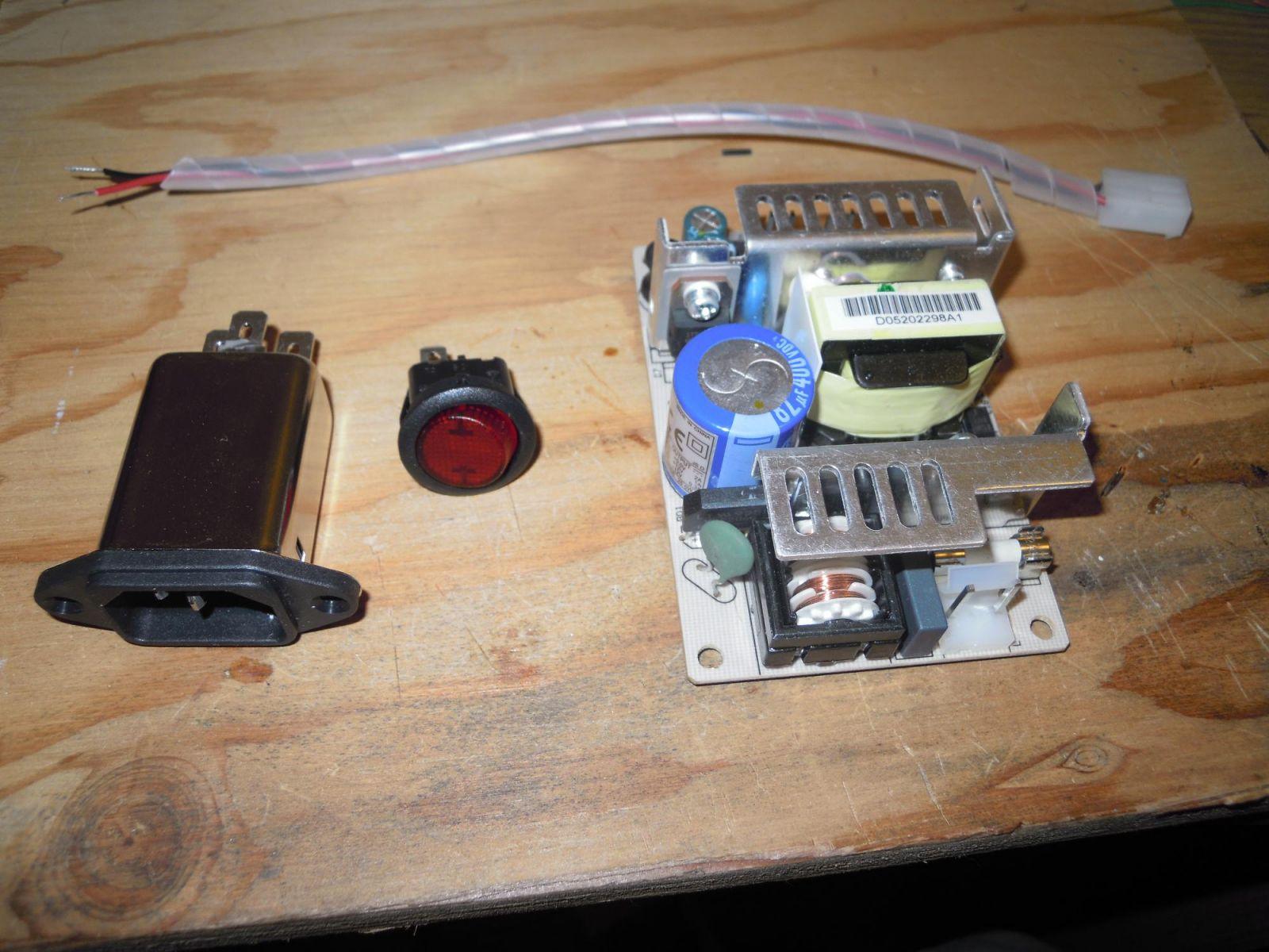

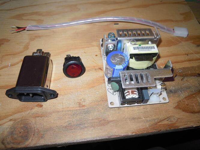

PSU Module + illuminated switch and power cable entry
back
face

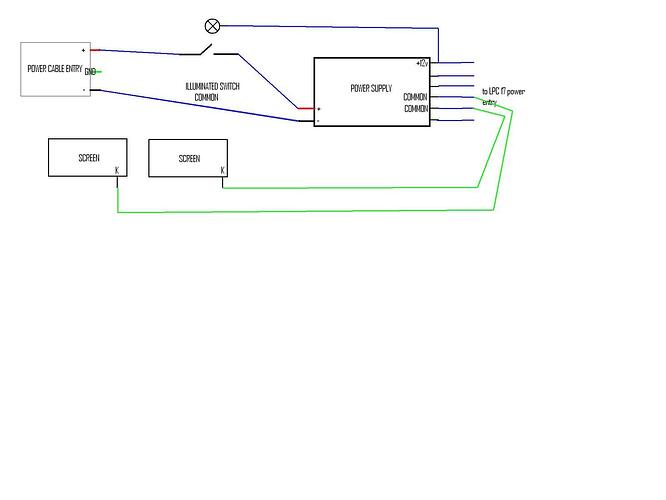

power supply schema

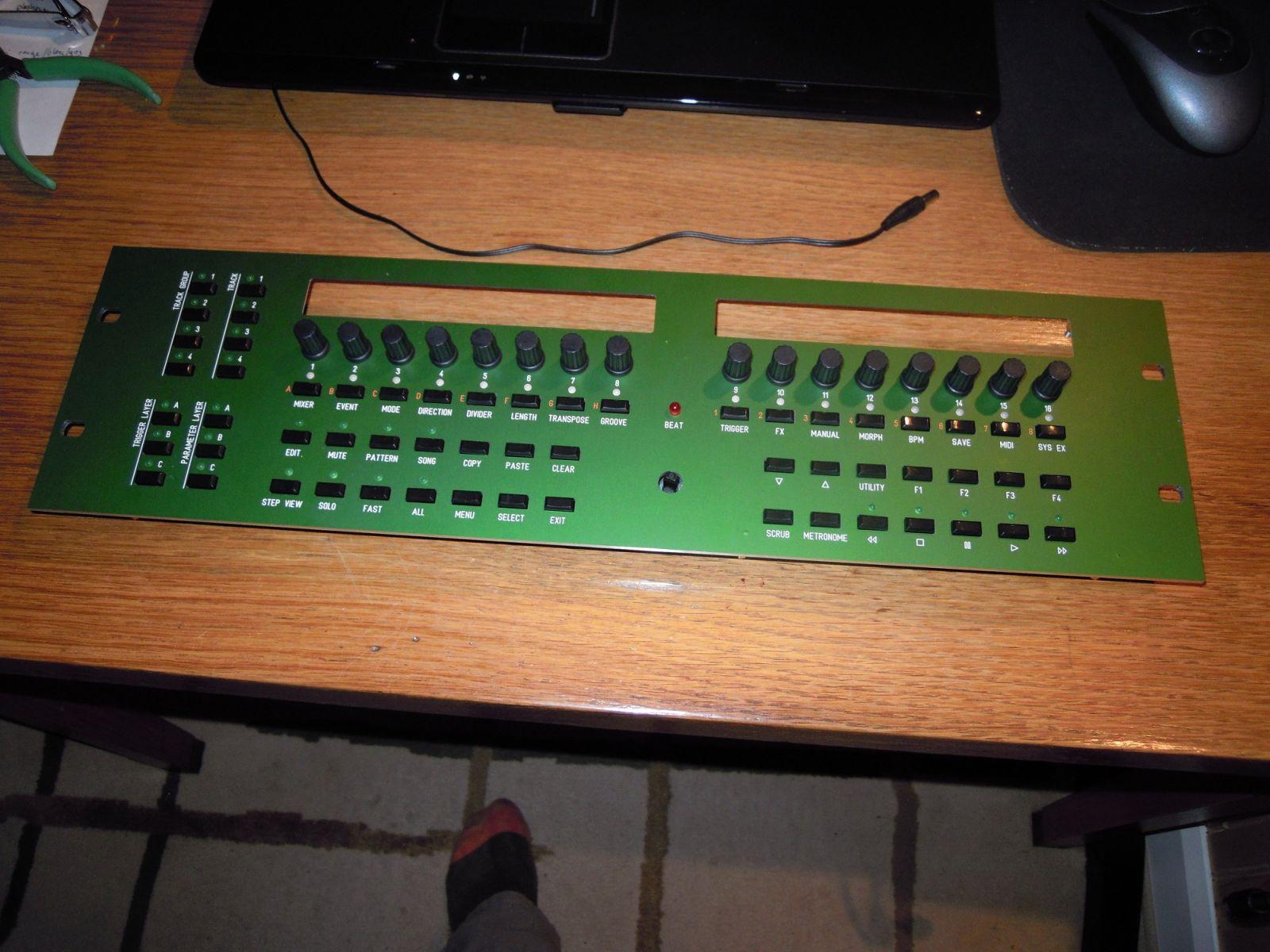

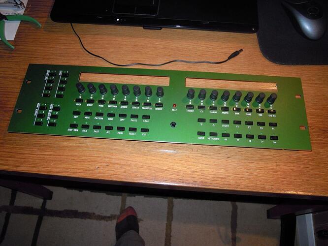

Yeah !!! I avance slowly ! Frontplate !
I’m just so dumb, scewing so much qnd do some little mark on the frontpanel… i will try to put some stickers…

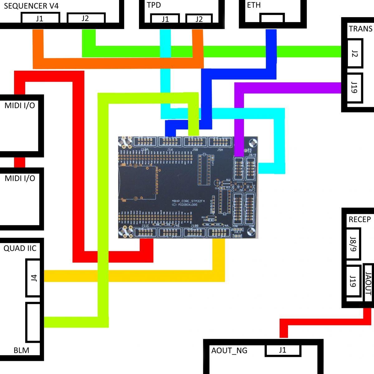

SEQV4 SMT32F4 wiring check

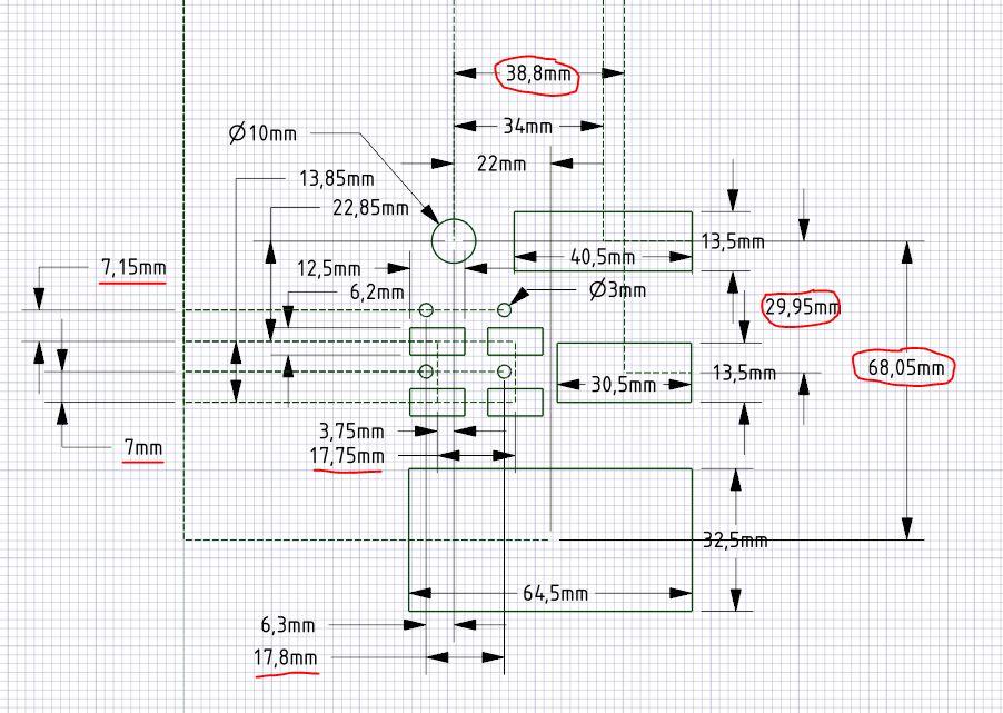

Preliminary drawing for TPD Frontpanel

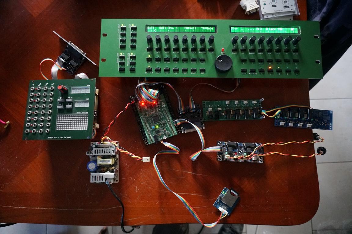

Re: DSCN1872
Great Lamouette ! Have fun for the end !
Re: DSCN1872
thx, it´s hard, but i will do it !

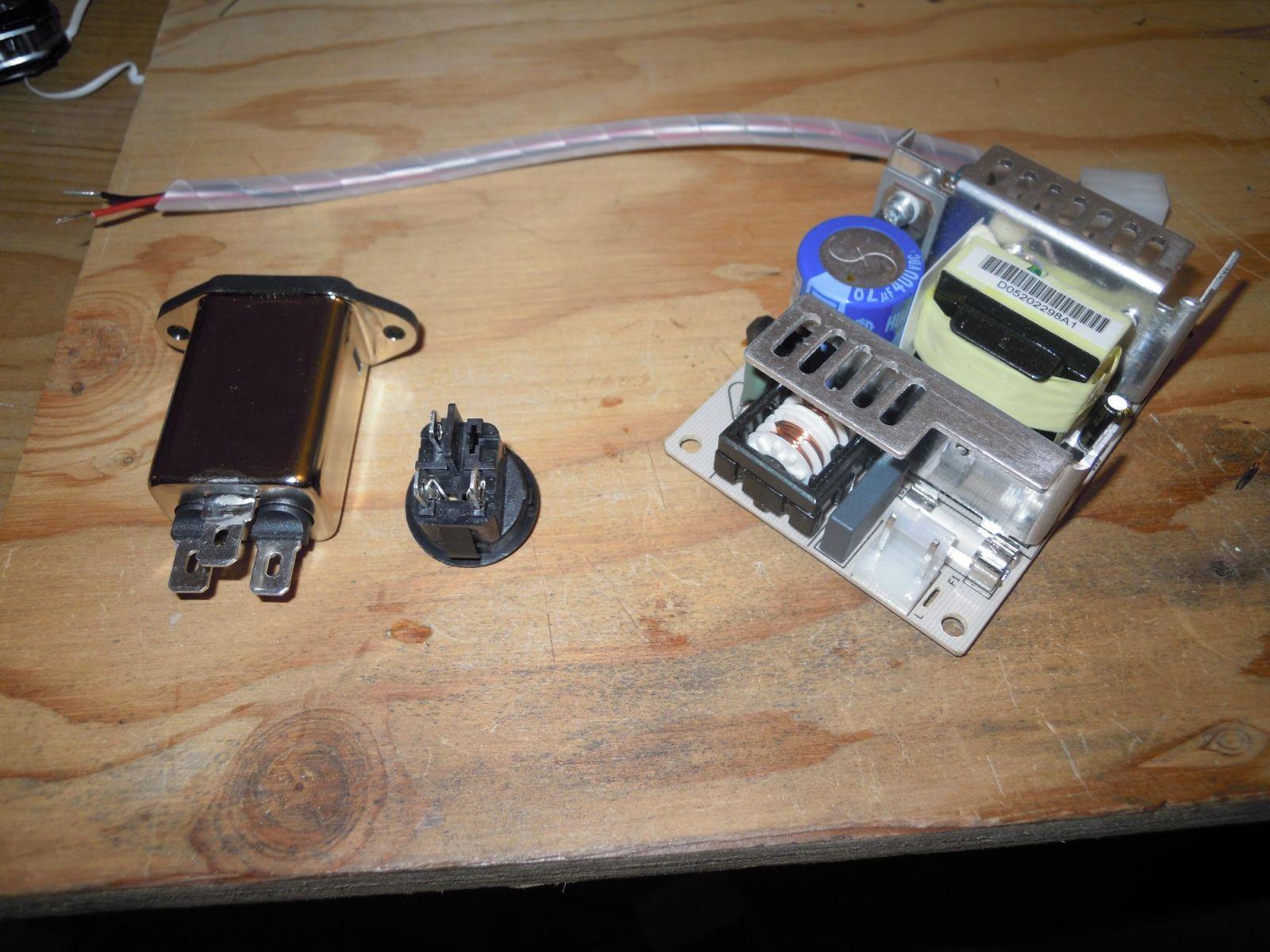

Re: PSU Module + illuminated switch and power cable entry
That is tiny! For your Seq?
Yes ! Hope it will work fine
Re: DSCN1872

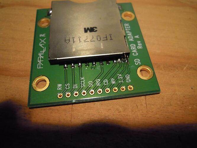

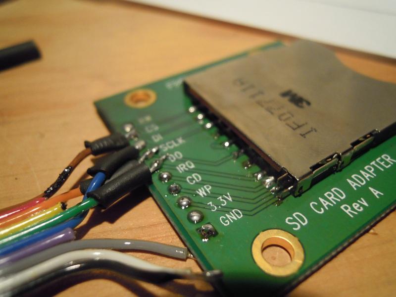

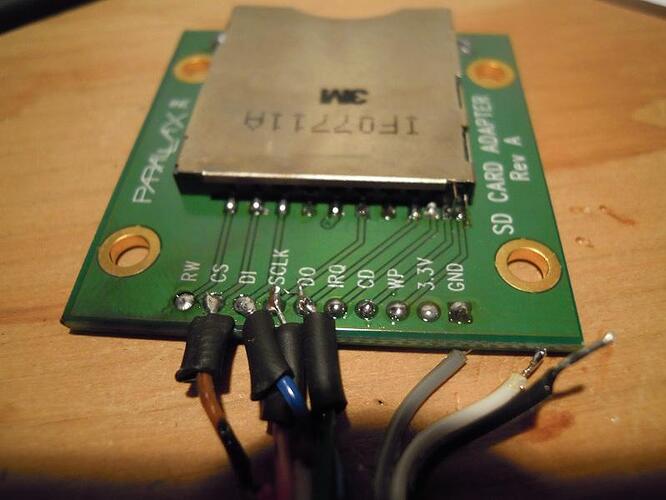

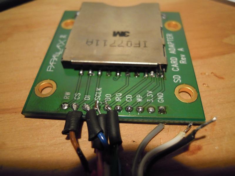

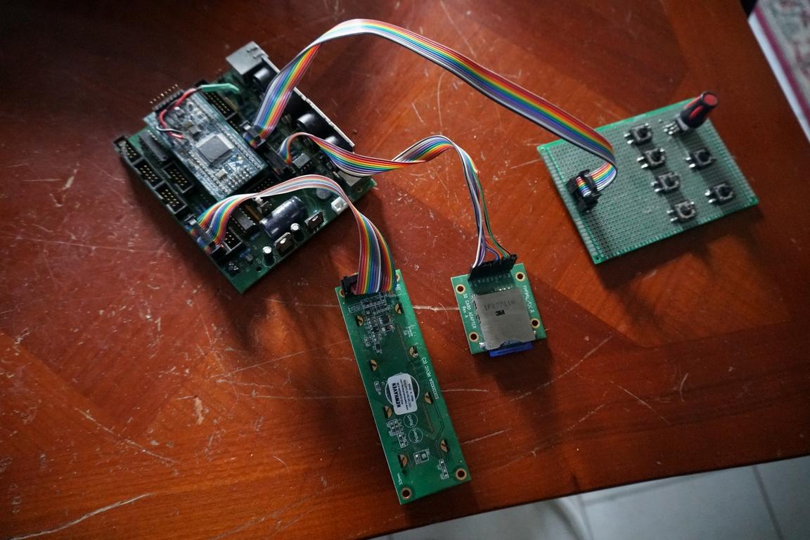

Where did you get this SD card adapter board? Is it a MIDIbox thing or a regular commercial product?
Re: Yeah !!! I avance slowly ! Frontplate !
Nice socks!:ahappy: (nice panel as well…)
Re: DSCN1872
@Saurean: I’d like to know this too. I have used a couple of SD card boards from Ebay, but they don’t have mounting holes.
Re: SD CARD Adapteur - 1
Where did you get this?
Re: DSCN1872
http://ca.mouser.com/ProductDetail/Parallax/32313/?qs=zGloE5nDus3Xw0sYxl9ouGXOLcCSiN7Q
Re: DSCN1872
Thanks d0gmaz
Re: DSCN1872

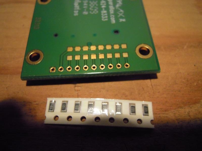

Yes it’s this one, I have some problem with it because, when a connect it to the usb port of the computer, the software regognise the SD card, (so i had upload the bootloader on the SDcard), but when i only power the SEQ, i can see on the screens, ‘‘no SD card’’ (or something like that)
There was some SMD components that i didn’t use ont he card, maybe the problem come form them…

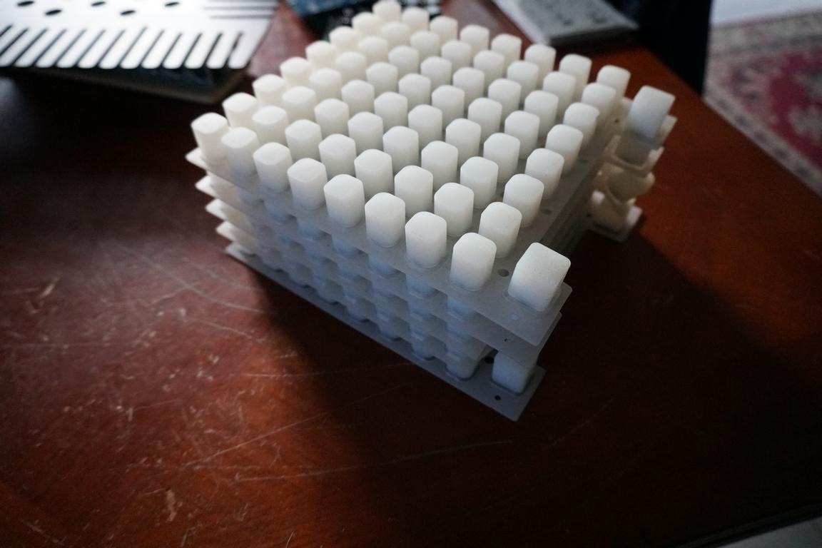

Re: GM5x5x5
Are u gonna mount the boards inside so that the short side of the PCB show in the window?
Maybe mount them 20-30 degrees too, that would make it look really angry :smiley:
Need to fit some blacklights in there and fit the surroundings of the PCB with pure white. Would be awesome.
Or maybe red PWMed diodes pulsing in there. mmmmmmmm (too much need for speed maybe? :P)

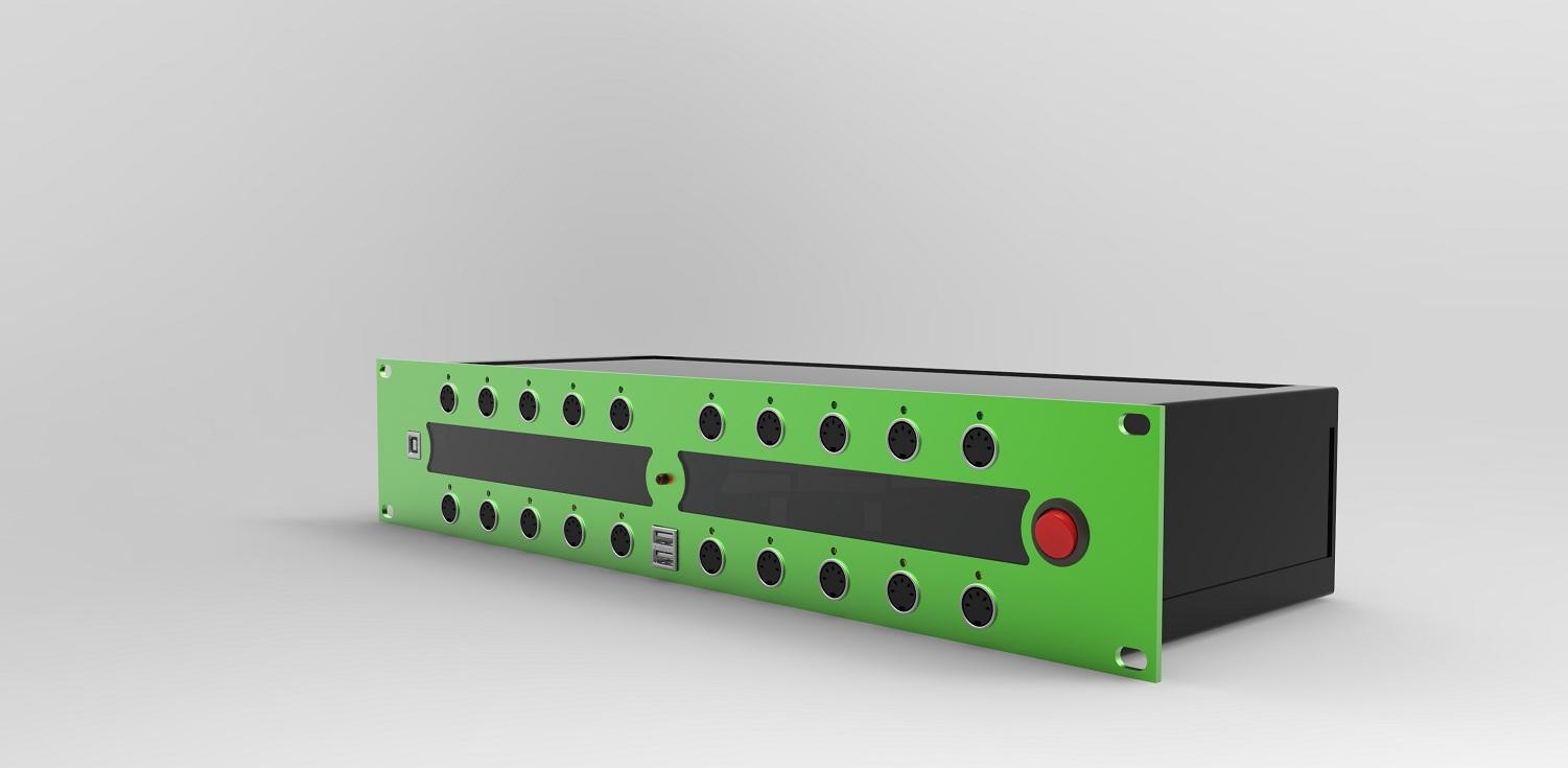

Re: Midibox green
Great 3D Work! I just love the toxic green anodizing color :D. Personally I would consider changing the on/off color though. :slight_smile:
What is the black spot in between the glasses? EDIT: On/Off LED?
But this looks REALLY great!
Re: Midibox green
Green would be my favourite! Well done! :thumbsup:
Re: Midibox green
thanks ! Yep, It’s the on/off led ! i will try to find something more design ! Also, it’s not totally finish, i have to have the fix screws, and sone others usb port on the back panel !
My SEQV4 (not finish now… i have to rework on it) is also green ! so i think this will be same color ! (i love the black too and i have to do it with a pearl white !)
