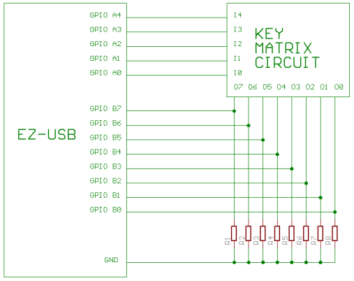

Lets say I have made the keyboard matrix, as i have linked to above.
Taking the picture below, would it be possible to just wire the matrix to the DIN module?
And then i guess I would have to do some programming in MIOS?
Ok, considering that i basically dont know what im doing, im doing a pretty good job at making this sound simple  ;D
/carsten
http://www.dribin.org/dave/keyboard/html/
http://www.ucapps.de/mbhp/mbhp_scan_matrix1.pdf
http://www.midibox.org/forum/index.php?topic=6505.0
http://www.midibox.org/dokuwiki/doku.php?id=midiboxkb_-_using_a_c64_keyboard_as_input&s=scan+matrix
I guess the above links would provide info enough to create the same as the c64 input, with a toy keyboard.
