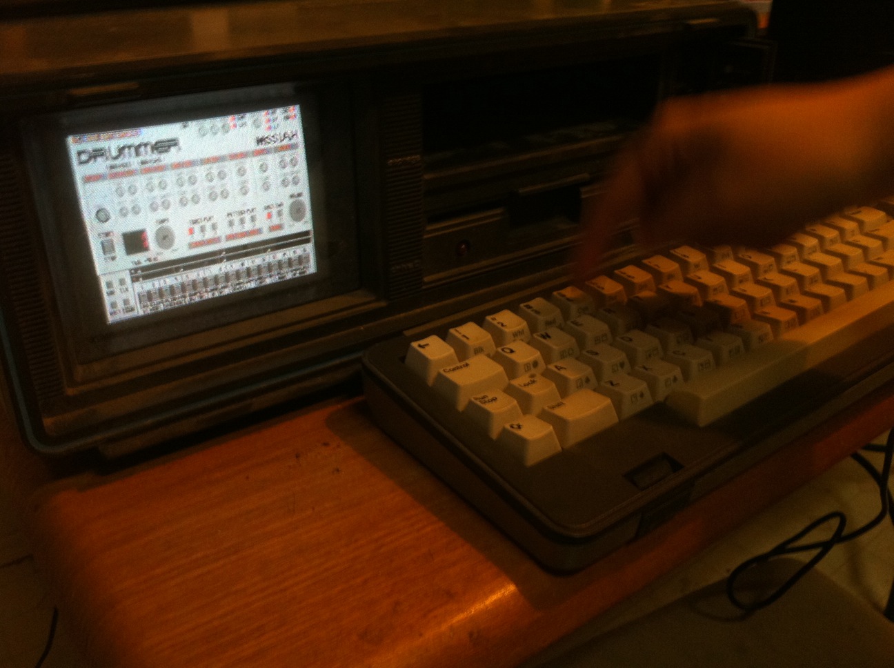

Me testing the SID chips pulled from non-functioning C64s with the MSSIAH cart.
The working Commodores (about half the inventory)
My SIDs

Don’t cannibalize that SX!
I don’t cannibalize anything that works. The 20 SIDs came from busted machines. Loving the SX though with its 42 lbs, allegedly portable awesomeness.
As for selling them, I am setting up a shop to sell most of the C64 inventory. I’ll post when thats done. Mostly interested in getting some SID chiptunes up and running.
Its super pristine under the dirt
