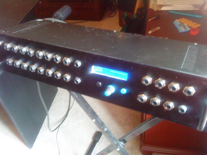

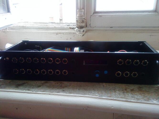

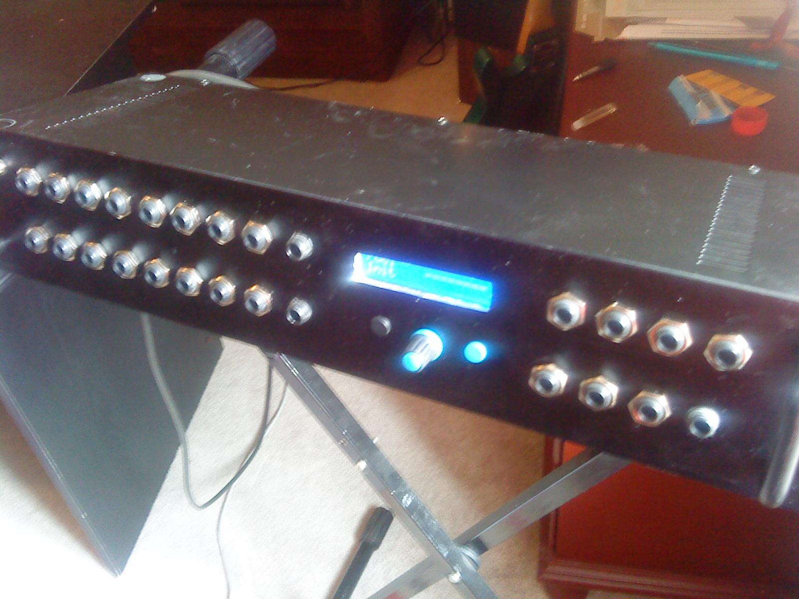

MB CV : top view
MB CV : left side

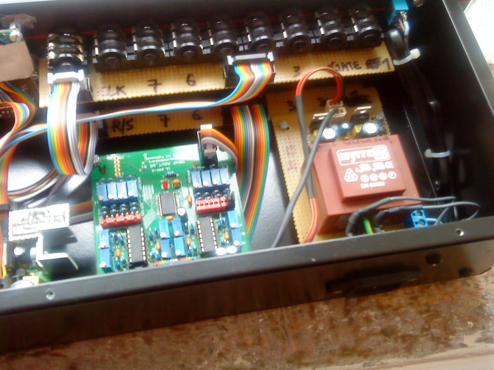

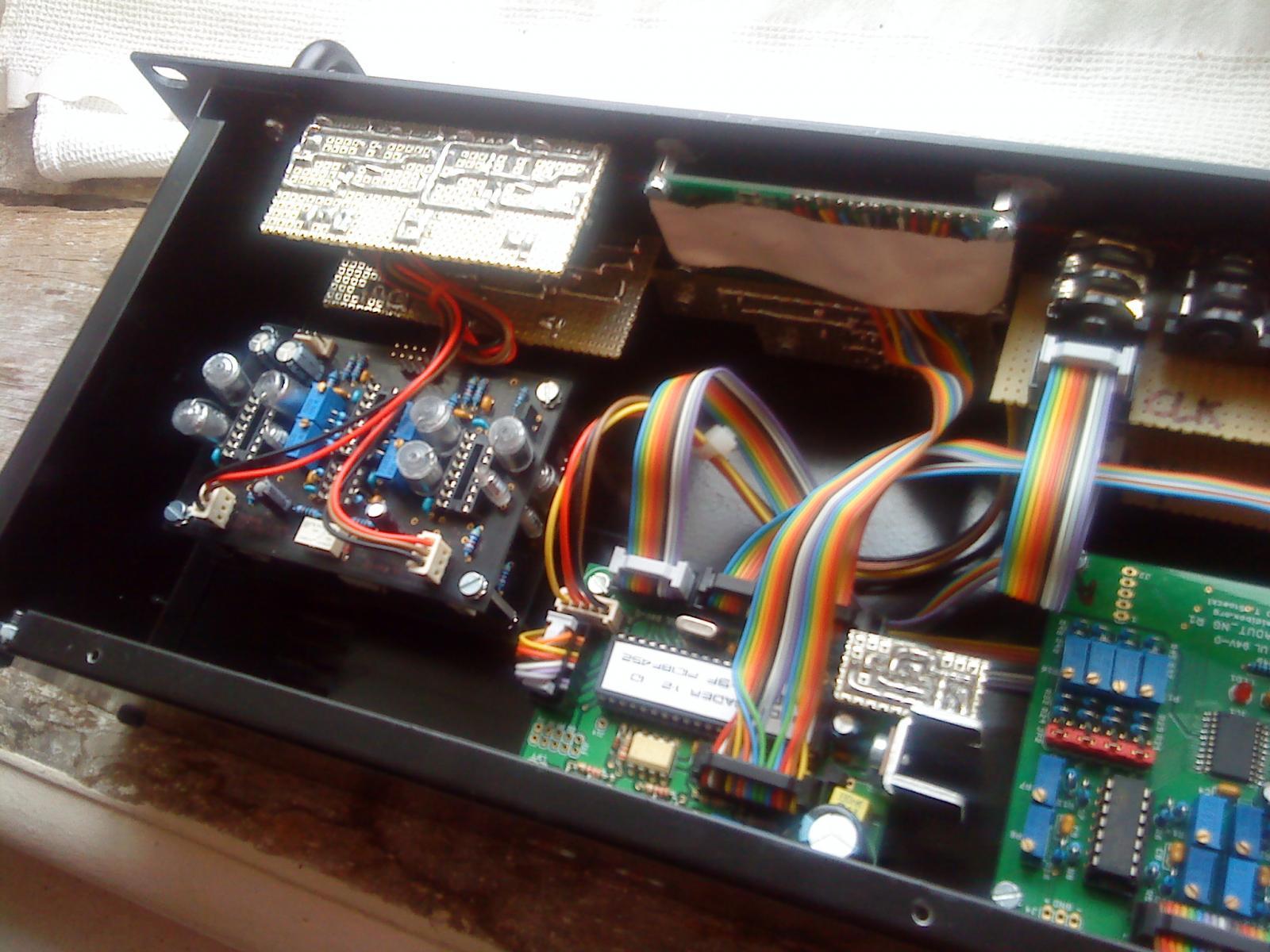

aout module, bipolar PSU, gate cv veroboard PCB
MB CV : right side
dual stereo ssm2044 filter + core

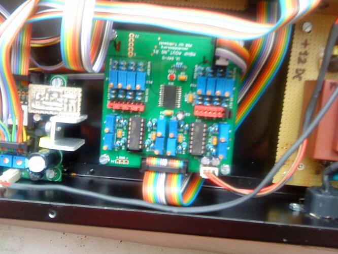

MB CV : AOUT_NG module
MB CV front
MB CV : panel hand drilled
was very long ! 6h using a column driller and Dremel
MB CV
8 gates
8 CV
1 clk
1 run/stop

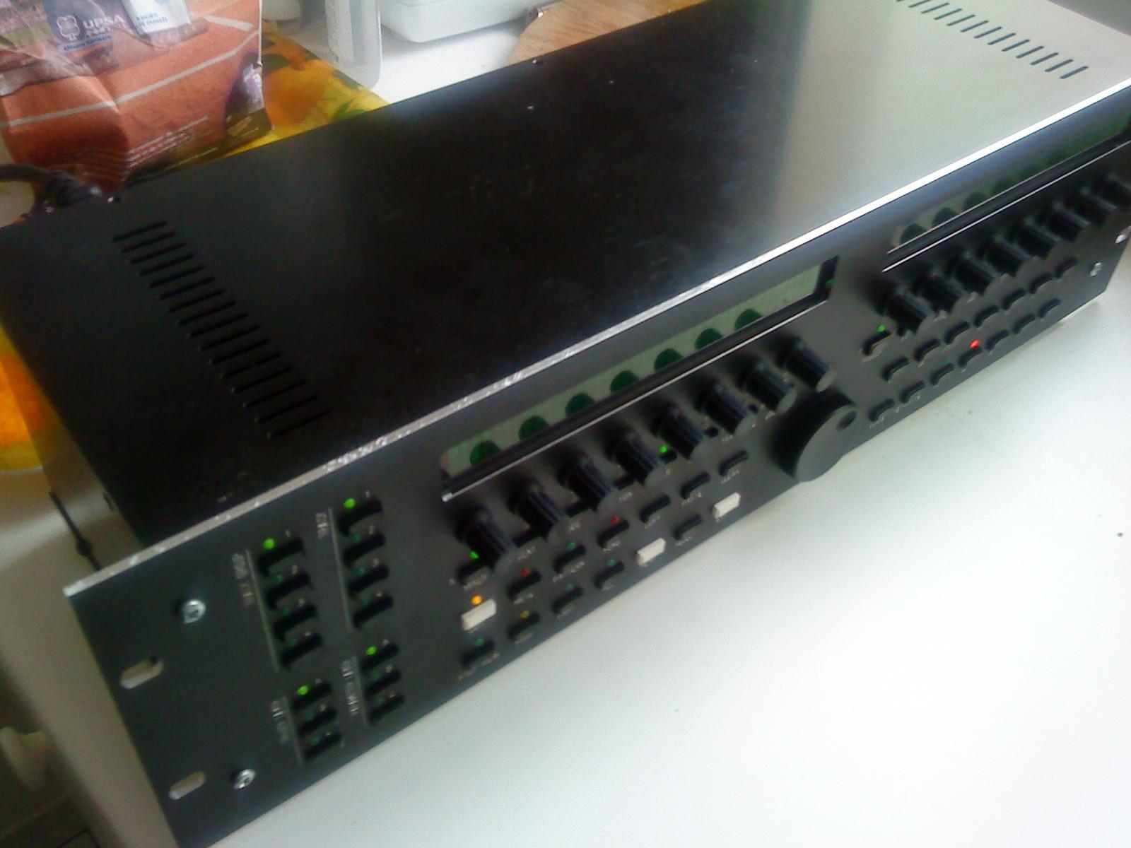

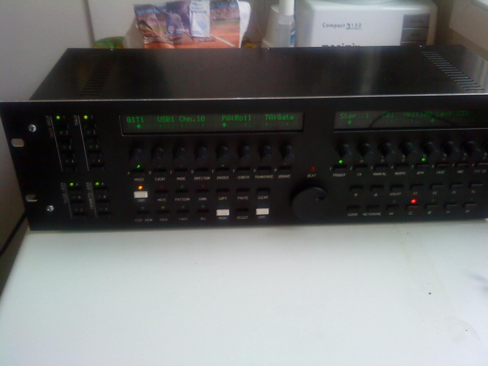

MB Seq v4 : front
panel designed by Wilba, manufactured by julianf
mounted and racked by JV
originally invented by “midibox God” TK

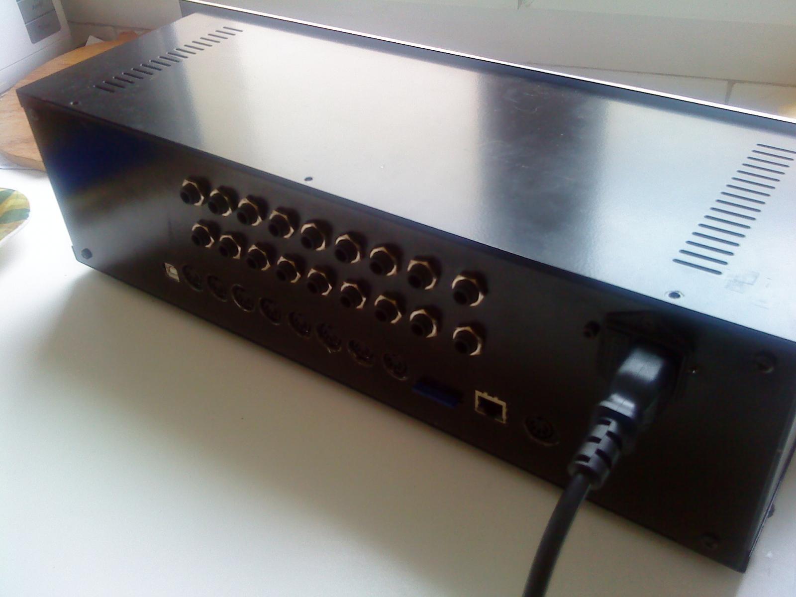

MB seq v4 : full options !!!
8 Gates out
8 CV out
1 Clock out
1 Run/Stop out
USB
4 I2C out
2x2 MIDI i/o
Ethernet
SD Card
Sync24 out
220V AC powered
Rack hand drilled (long and complicated)
MB Seq v4 : 3U Rack

5€ ELPAC GR-114B PSU (+/-12V 250mA ; +5V 1A) @Selectronic.fr
Handmade Gate and CV veroboard PCB
Handmade I2C + SDCard/Eth veroboard PCB
Modded to output 5V gates with 3.3V from the Core32

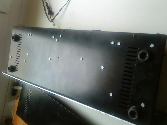

MB Seq v4 : bottom
clean isn’t it ?
