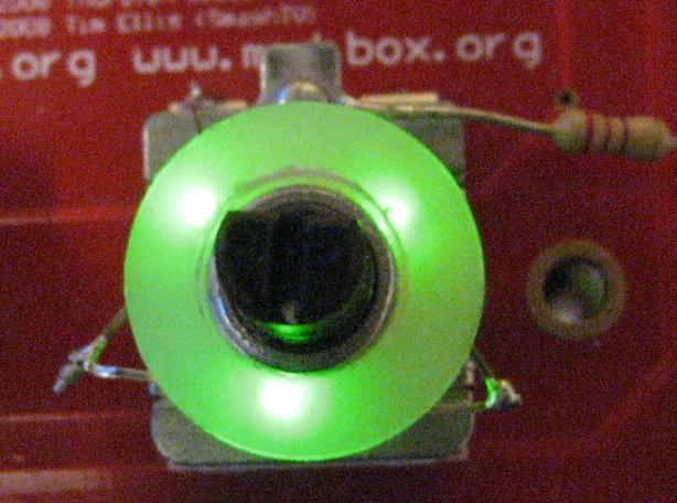

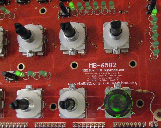

Testing encoder LEDs through the opal washers.
Washer LED bleedthrough?
Now smeared using the washer as a diffusor
End result with smearing…

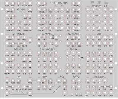

Getting close to sendoff. Outlines of components are shown. This mockup got printed and real knobs were put in place to check finger clearance.
The component outlines are the round circles around the holes. This way we can ensure that everything fits even on the backside.

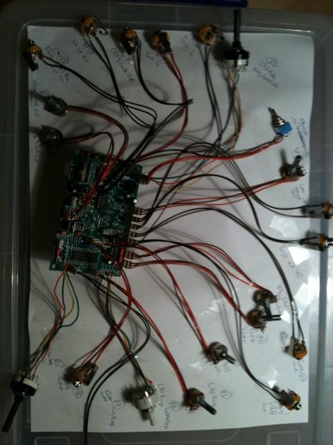

Thomas Henry/Fonik Super Controller PCB and parafernalia for the modular. The FSM (Flying Spaghetti Monster) likeness was unintentional. His noodly ways manifest themselves in the strangest ways…
This and much more will be slaved to the AoutNG and under control by the MB-SEQv4 that sits on top of the 9U of analog mayhem.

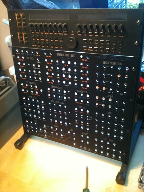

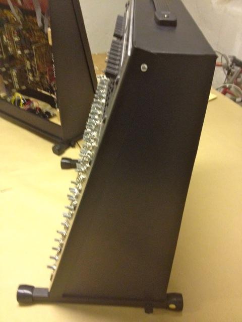

Dummy mounting of modular synth panel and MB-SEQ
Just testing racking the monster.

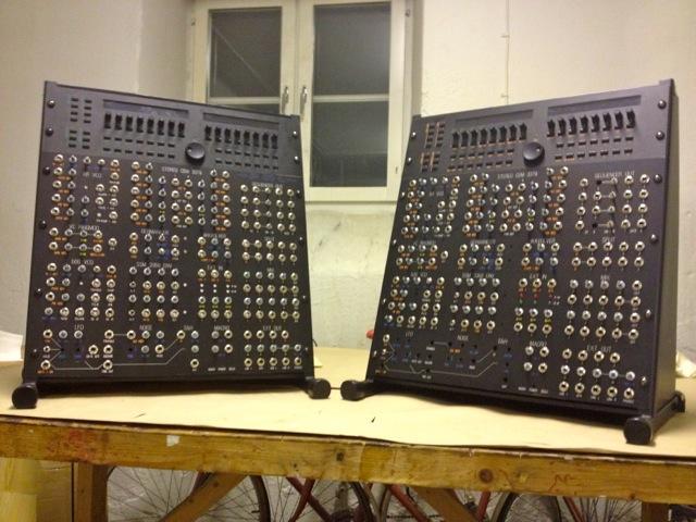

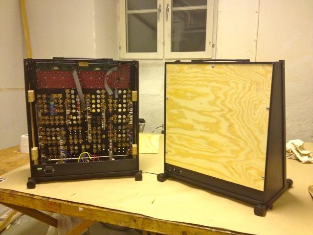

Twice the fun / double the trouble

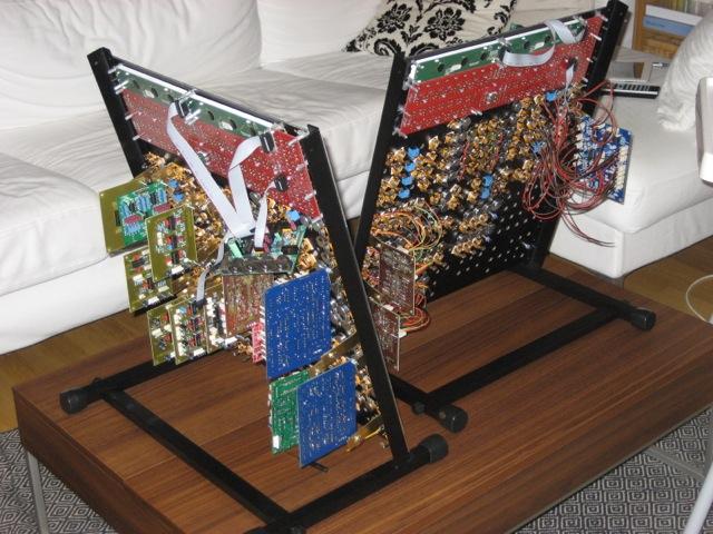

Building two modulars, one for me. All the electronics mounted on one of them. The other has most of the front panel wiring soldered. Add bottom plate w/ PSU plus the cabinet holding the Core32, SD-card and ETH PCB (not pictured).
More work on the cabinet to follow later.

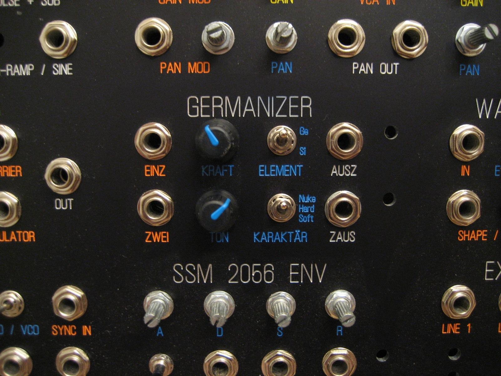

Technodistortionsgerät
This is part of the story. It’s an homage to Deutschland and the Hardfloor-stylee sound. Happy skronking!

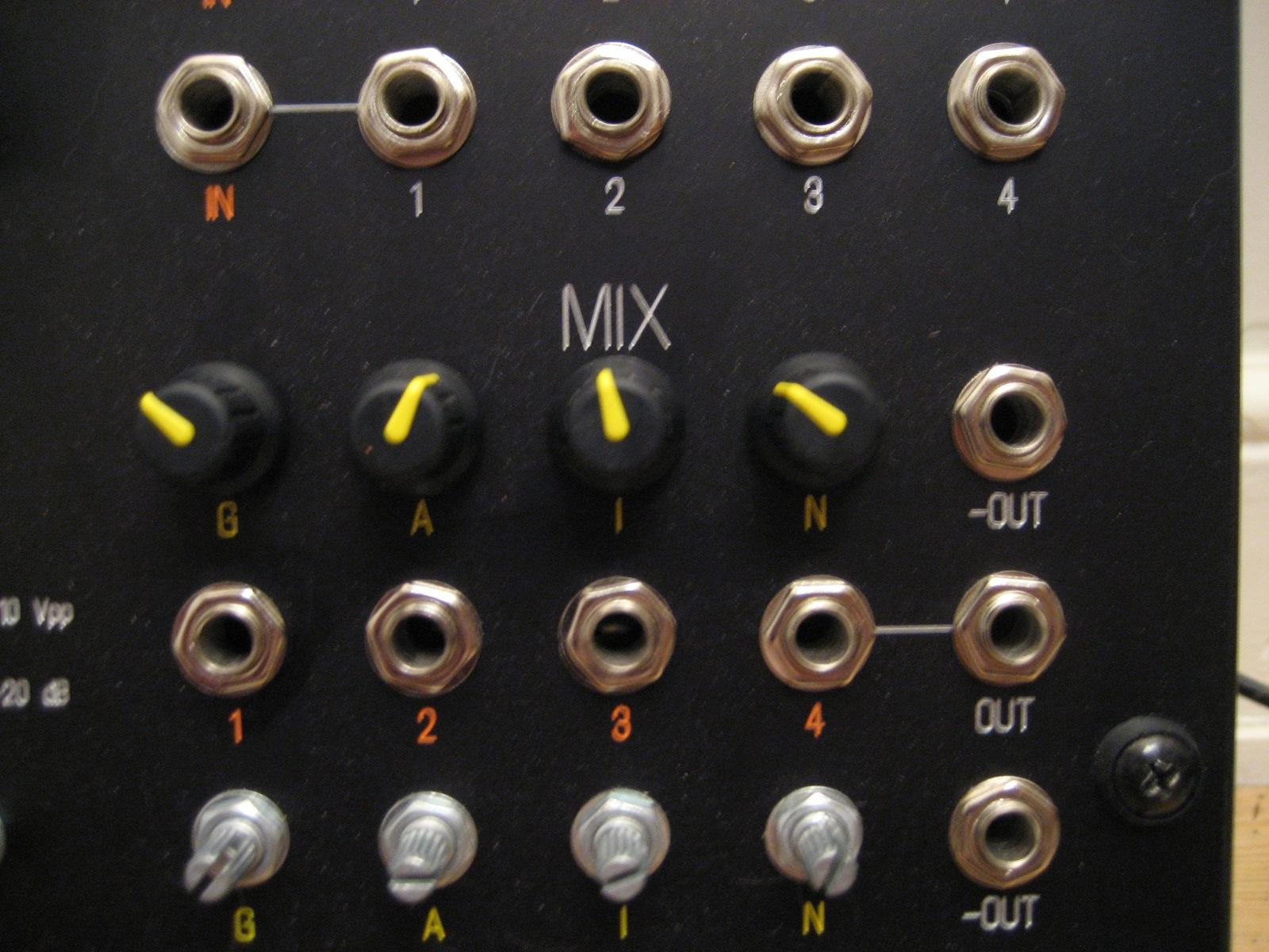

Part of the mixer section. I bet we saved 5 cents on the engraving by writing G A I N but it looks cool in a strange way.

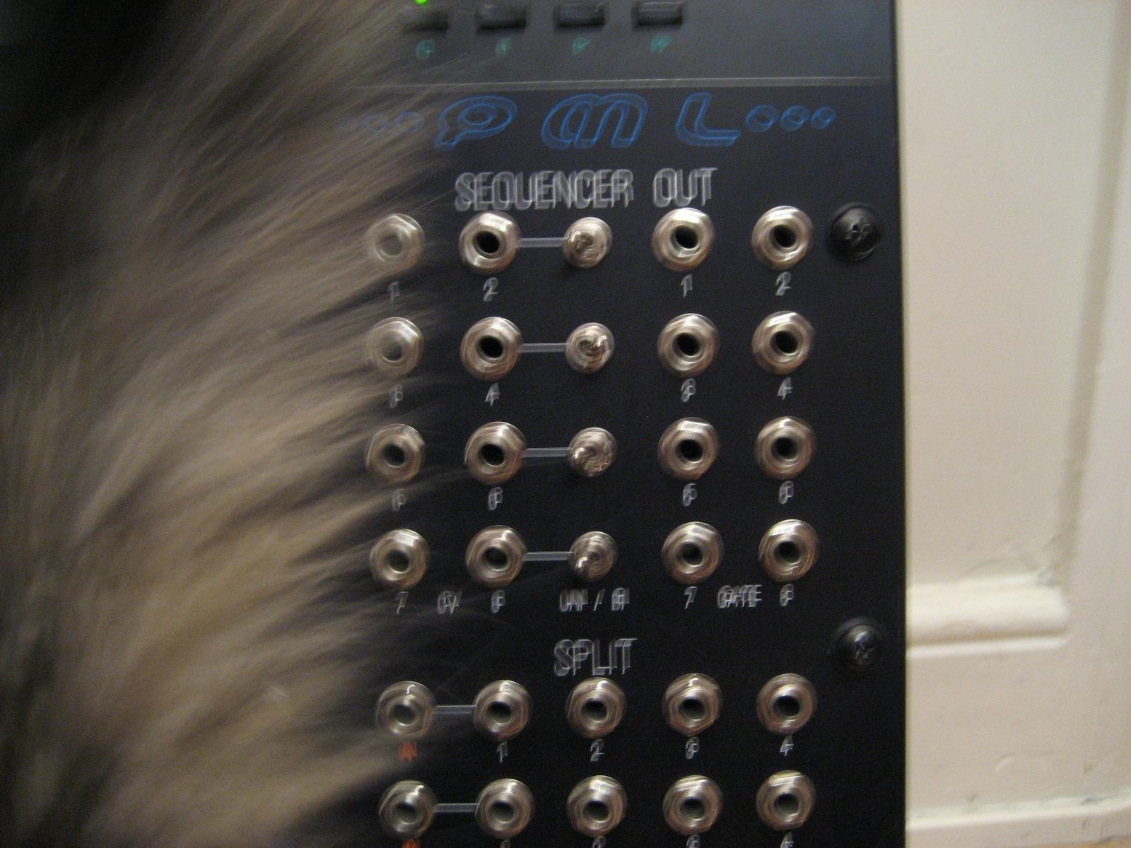

Affinity
My cat had some affinity to the box while I was trying and failing to take some pics. CV/Gate out section.

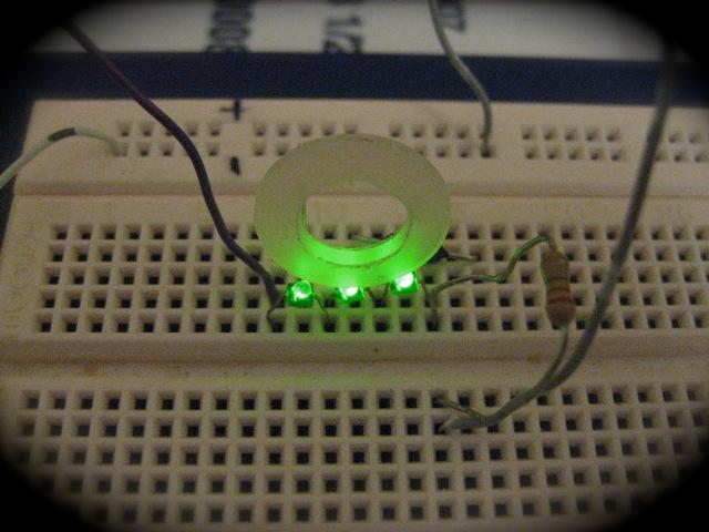

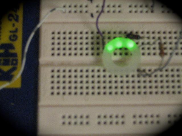

Re: Washer LED bleedthrough?
Just a quick test, plastic somewhat opal washers and 3LEDs in series @ 9VDC, 220R.
Re: Testing encoder LEDs through the opal washers.
It.Really.Smears.the.Light! Just for testing if the washers can serve as diffusors.
Yo! Nice diffusion! But am a little bit sceptical, if it is sufficient to backlight those knobs brightly enough for Emerald City :slight_smile:
Stay tuned!
Re: End result with smearing…
This is considerably dimmer, but this is taken in a well-lit room during daytime. It will glow nicely in the dark. Also, my gallery tells me a different story when the before and after pictures are level-matched /public/style_emoticons/default/thumbsup.png" alt=“thumbsup.png”>
I like it - it will be sufficient :slight_smile:
I hope so - otherwise I could get some gull-wing blasters that put out 168mcd each locally. But these were free /public/style_emoticons/default/santa.png" alt=“santa.png”>
yo, or the bfg9000 photon emitters, but these are military grade :slight_smile:
Firecrackers!!! Has a harsh intro - starting to get going at 1:52 w/ Nam June Paik gfx, analog style from 1978…
Mhm after watching that video I want an oldschool 256x64 OLED galaga-style shooter :slight_smile:
Yay for Galaga and other old-school shooters! And to BFG /public/style_emoticons/default/thumbsup.png" alt=“thumbsup.png”>
Re: 9HE Panel
mmm - tasty :sorcerer:
Re: 9HE Panel

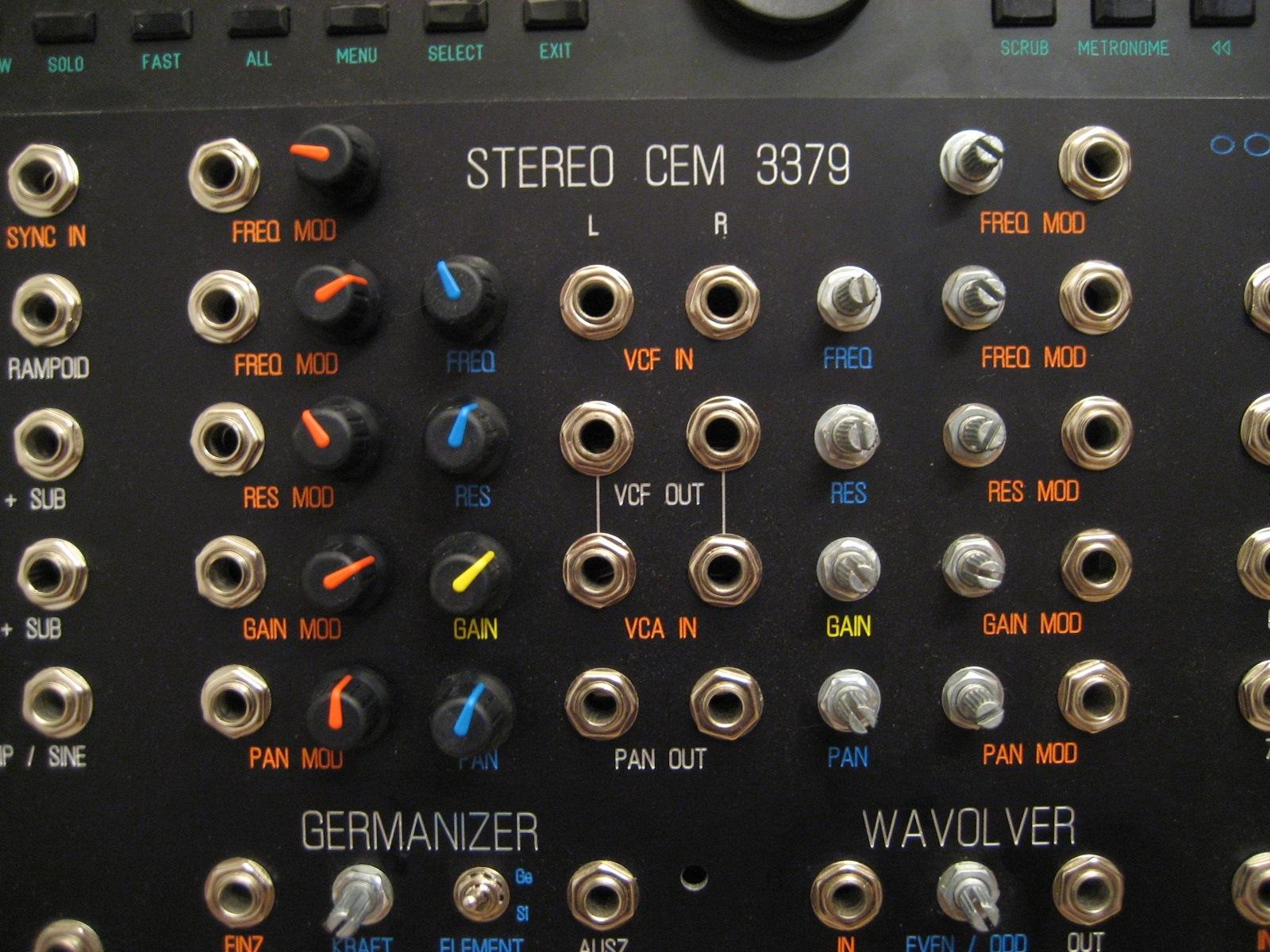

Future 12U panels will be less bread and butter and more outlandish. As you can probably tell I want this to sound harsh - buil in distortion and waveshaper. All inputs are attenuverting (+1 to -1).
Getting antsy to finish this, get panels and let it sing. Untz untz untz, skronk and some schranz. /public/style_emoticons/default/whistle.png" alt=“whistle.png”>
Re: 9HE Panel
not to forget
modulated sawtooth → germanizer → “yodelütiii”
:thumbsup:
Re: 9HE Panel
Will you make a Bavarian version?
Next panel will be Swedish - Klånk skrammel rassel ööööö hähähähä Erik Northman, Greta Garbo, saltlakris, snaps, sill och lite vrål.

Re: Dummy mounting of modular synth panel and MB-SEQ
Jo man, that is sauce-boss-extreme style :slight_smile:
Well done! Am very interested to hear its soundz!!!
Greets,
Thanks! She needs populating first/public/style_emoticons/default/sweat.gif" alt=“sweat.gif”>
But, it will all be good, goofy, gooey fun in the end. Design freeze was 111009, aiming at working like mad to have it up and running by 111111 one one eleven!!!
2xVCOs (Thomas Henry - one 566, one XR2206), a dual/stereo CEM3379 VCF (PML), dual envelopes (PML), ring mod (Fonik), SN76477 noise and S/H (TH and Fonik), Ian Fritz Wavolver waveshaper on our own PCB, Germanizer germanium diode distortion (PML) and MB-seq w/ 8channels of CV/Gate (TK’s genious sauce and design - Wilba stylee CS, Fussylizard arranged the order, Julian F did the panel, we did the CV/Gate out PCB).
This is PML stylee (that’s me and my pal FS) - we mix the borrowed (TK, Thomas Henry, Fonik, Ian Fritz) with our own custom sauce. Next time we eat the future!
