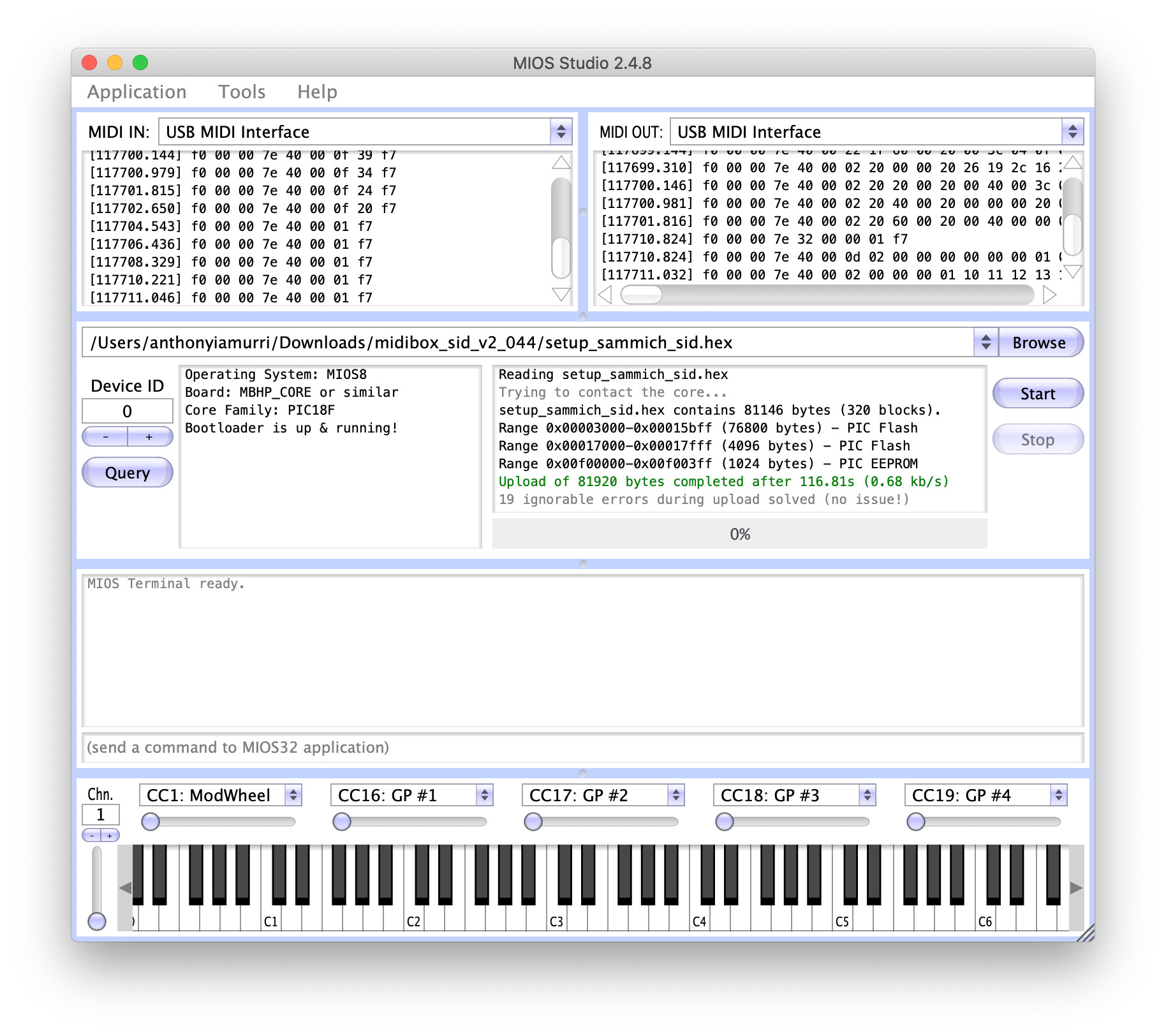

Hello,
I recently built a sammichSID Midibox & am having issues with the firmware. I am uploading the most recent version of the hex file (midibox_sid_v2_044/setup_sammich_sid.hex) & every time it’s uploaded, I receive ignorable errors in MIOS Studio (see attached image). Also, the prompt says the “Bootloader is up & running” afterward & never changes to “Application is up & running” (unless that only happens when no ignorable errors are detected…?).
Can anyone give me any hints or point me in the right direction? Thanks in advance.
Maybe it depends on your Midi Interface but if you could have uploaded MIOS 8, it should work.
Took a look at the White and Blacklist http://www.ucapps.de/howto_debug_midi.html (Blacklist Link at …via Loopback)
