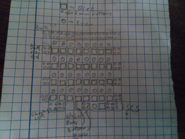

About what I have in mind, it would be something like this:
Banks are all groups of 4 buttons on the sides. All banks would be independent from other groups of (bank-buttons) or (bank-encoders).
But if the limit is only 4 banks…This would no longer be possible.
This easily avoids conflicts of having to keep weird parameter grouping, just to be able to turn whatever parameter needed at a certain time. In other words, one could easily play with any parameter without conflict of position and have better organisation.
In the top double button row, each 8 buttons would have 2 banks.
For the encoders, each 4 encoders would have 4 banks. This way it would max the 128 possible encoders.
In the bottom row would be, from left to right:
8 shortcuts that would directly call for a preset from SD memory;
2 global banks for the buttons, and 4 global buttons for the encoders. This way one would be able to select, for example: bank 1 for all encoders.
SCS controls. Maybe redundant, maybe useful to have. I don’t know if it would be possible to have that 33rd encoder or that 33dr display.
This is what I have been cooking. Care to give an opinion?
And again, thanks.
As far as I know the maximum allowed number of banks is 127. So this shouldn’t be a problem.
You want 33 OLEDs? This is definitely nothing easy to do. You need to take care of the clock pin when doing the PCB layout. Nothing you can do on breadboard. Also you’d need a separate power supply for it.

 ah, I see that I misinterpreted your post, I figured that you wanted to bolt on displays to a BCR2000, now I read that you want to replicate/extend it. I think your idea is feasible and it looks quite similar to what is planned for v2. By all means, go for it as this is what MIDIbox is all about.
The limit of banks is 255 I think, just they need a method of selecting them.

Golden on the banks!
30 minutes ago, FantomXR said:
You want 33 OLEDs?
I can definitely forsaken the 33rd OLED and have the SCS emulated.
Thanks Man!
The thing is for me to have a general understanding of whats is possible. So I can get the hardware and then start working the rest (coding and prototyping). Then I will get to more in depth questions.
