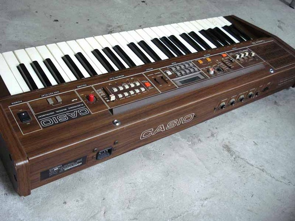

Haven’t been on in ages, hope everyone is well. I have a casiotone 501 laying around in good working order, but I want to try and put a pitchbend wheel into it. For those that don’t know the Casiotone 501, its the same as the one in this pic:
The reason I think this is possible is that the keyboard has a master tune pot on the back, which really works in the same way…its not a MASSIVE swing in pitch (im guessing a major 2nd at MOST…probably only a half step even) but its better than nothing, and still helps breathe a bit of life into the dorky sounds it makes.
