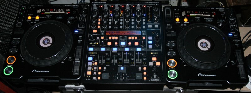

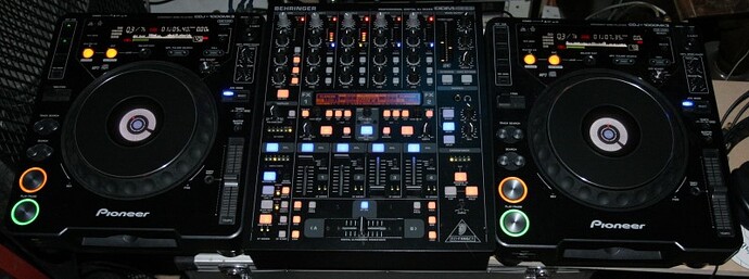

the mixer was probably designed with being paired up with the cdj’s in mind, as dispite the odd orange and blue dominated lighting scheme it actually fits in very nicely with the decks :slight_smile:
also, took the time to test the players and mixer with midi control from the mixer to use it as a control surface for traktor ! ..and used the time code cd’s in the cdj 1000’s to control the scratching section of traktor to manipulate music on the pc also. i can confirm all of this works flawlessly :slight_smile: ..supprised at that ! ..was expecting a niggle.

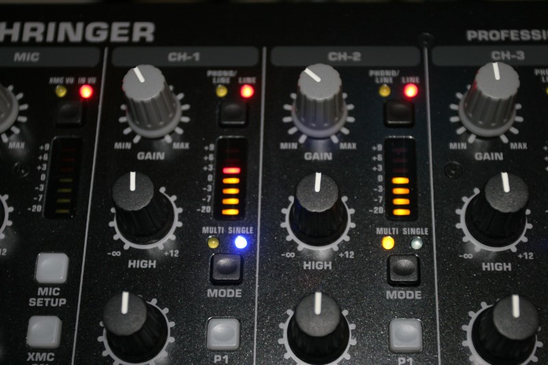

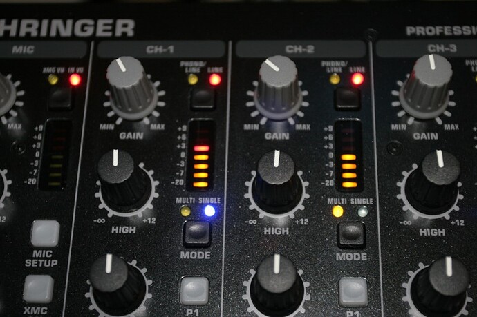

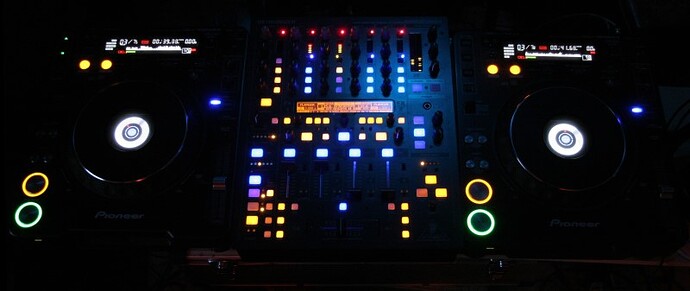

..and lights off, ooh ! pretty :wink:

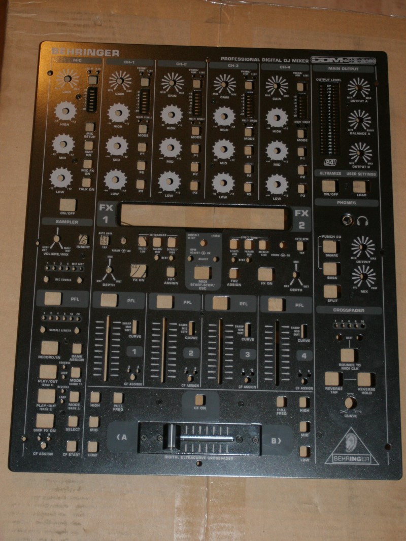

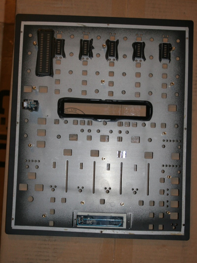

nice speckled silver/black finish :slight_smile:

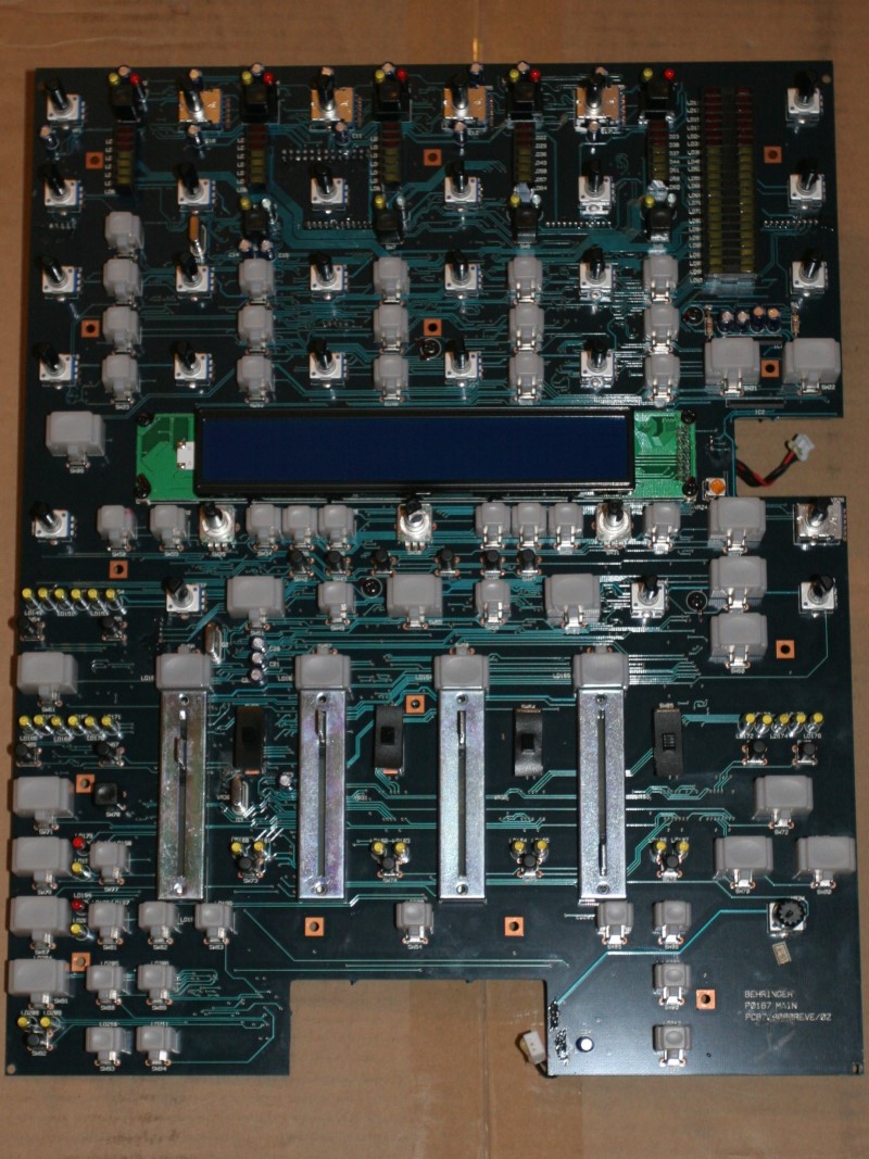

also modded the usual problem of overly bright blue leds, 4.7k added worked a treat.. tho maybe the next value up for some peoples tastes, only this doesnt burn the retinas out now :wink:

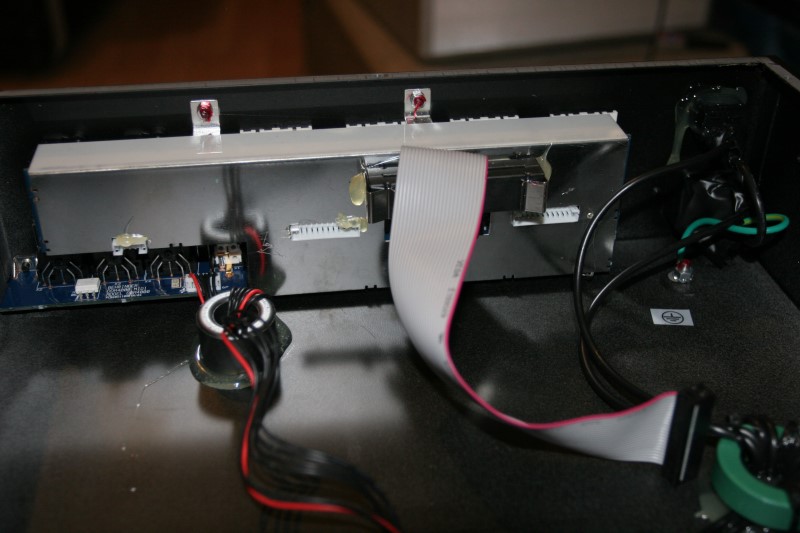

EL backlit screen.

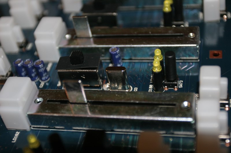

sliders are standard resistive tracks, not optical as reported some places !
nice, slightly resistive feel.. marked with a B in a triangle

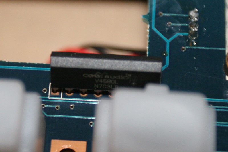

new power opamps for headphones, supprisingly good.
manages to run even relatively insensitive headphones like my other set, the akg k702 reference cans quite loudly.
the sony mdr’s are dangerous !

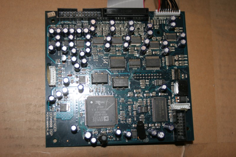

dsp card with two 400mhz blackfin dsps !

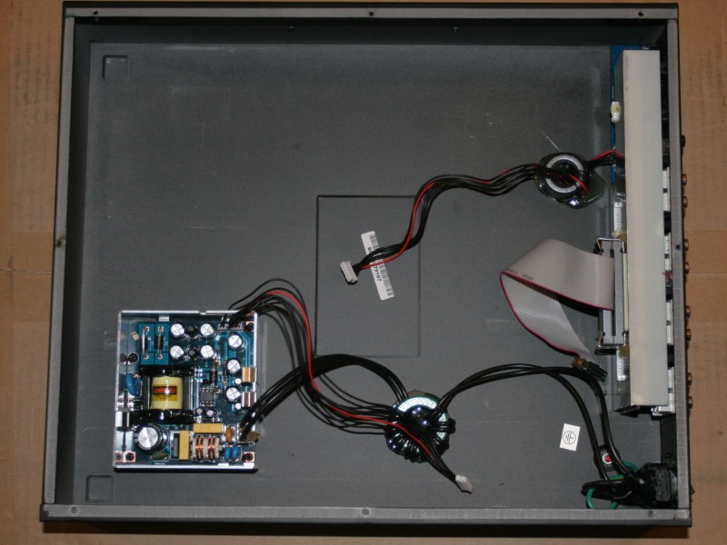

a supprising ammount of shielding & rfi filtering for a ‘budget’ product :wink:

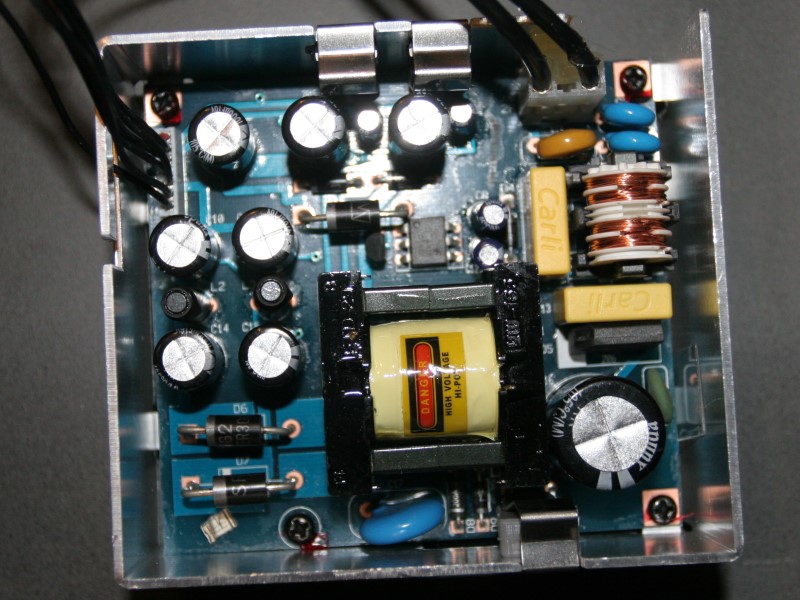

very simple smps ..not many linear psus in berry stuff these days.
the plastic screen guard needed wiping from the inside to clear some residue from manifacturing ..not bad, but a noticeable streek on the plastic.

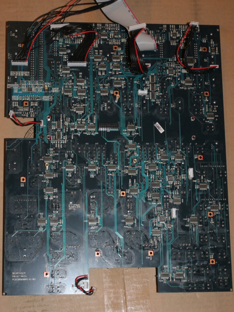

main board:
* 2x xtal - 16mhz
* 2x headphone amps - cool audio V4580L high current opamps.
* 2X AMTEL - ATMEGA8 RISC PIC
8-Kbyte self-programming Flash Program Memory, 1-Kbyte SRAM, 512 Byte EEPROM, 6 or 8 Channel 10-bit A/D-converter. Up to 16 MIPS throughput at 16 Mhz. 2.7 - 5.5 Volt operation.
(lots of:)
* 74HCT165 - 8 bit parrallel in serial out shift registers
* 74HCT595 - 8-bit serial-in, serial or parallel-out shift register
* 74HC4051 - 8-Channel Analog Multiplexer
* 74HCT244 - Octal buffer, line driver; 3-state (afew)

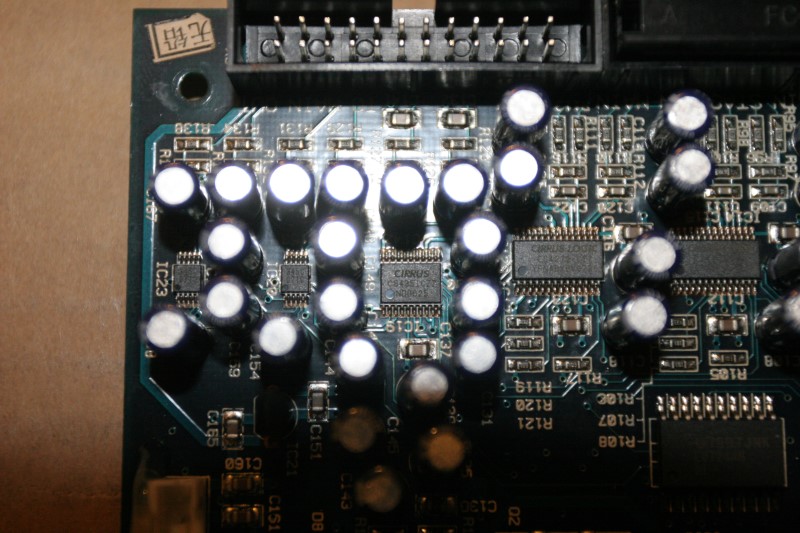

main board, analog i/o section:
* jrc - 4580 - dual bipolar opamp, 0.0005% dist, 15mhz, 5v/us slew, 0.8uv/vn (standard behringer faire)
* st - 074c - quad jfet opamps, 0.01% dist, 3mhz, 16v/us slew, 15nv/vn (old opamps, very odd !)

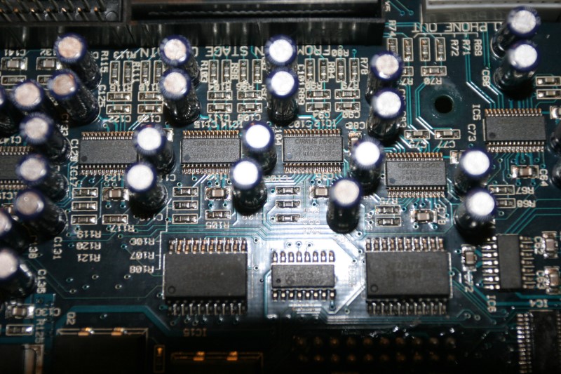

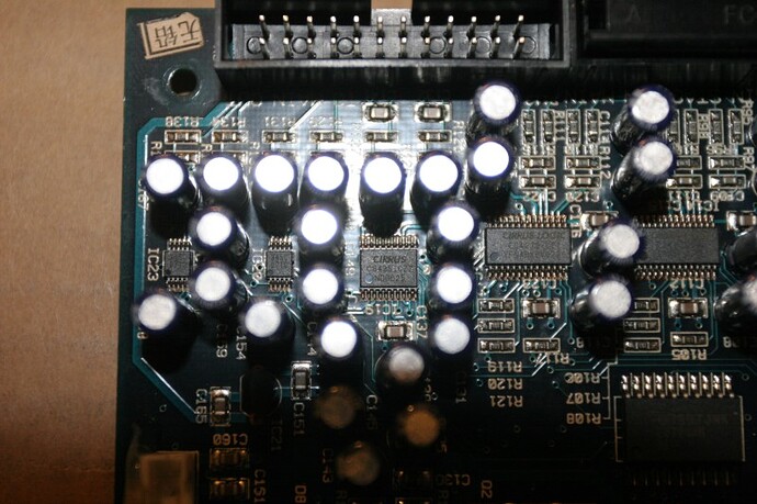

dsp card:
* 2x analog devices - black fin, adsp-bf532 - 400mhz !! (800 MMACS) 32 bit dsps.
http://www.analog.com/en/embedded-processing-dsp/blackfin/adsp-bf532/processors/product.html
* samsung k4s281632i-uc75 - 128mb sdram, 3.3v 133mhz/cl3
* hynix - hy57v161610ftp-7 - sdram, 3.3v, 16m, 64ms, 133mhz
* xtal - 25mhz
* xtal - 11.289
* 74LVT244 - Low Voltage Octal Buffer/Line Driver
* 1x cirrus logic - cs4351 - 24-Bit, 192kHz, 2ch dac, 112 dB, -100db thd, with Line Driver
* 2x cirrus logic - cs4345 - 24-Bit, 192kHz, 2ch dac, 105 dB, -90db thd (marked 345c071)
* 4x cirrus logic - cs4272 - 24 bit, 192khz, 2ch adc & dac codec, 114db snr, -100db thd/n.
* 1x cirrus logic - cs4271 - 24 bit, 192khz, 2ch adc & dac codec, 108(adc)/114db snr, -98/100db thd/n.

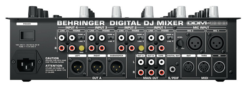

AUDIO INPUTS
Mic 1/2 (XLR, electronically balanced)
Max. input level            -14 dBu
Input impedance             2 k?
Phono (RCA)
Max. input level            -18 dBu
Input impedance             47 k?
Line (RCA)
Max. input level            +30 dBu
Input impedance             15 k?
AUDIO OUTPUTS
OUT A (XLR, balanced)
Max. output level           +21 dBu
Output impedance            200 ?
OUT A / OUT B / TAPE (RCA)
Output impedance            100 ?
Phones Out                   max. 260 mW @ 100 ? / 1 % THD
S/PDIF                       (coaxial, 16 bit, 44.1 kHz)

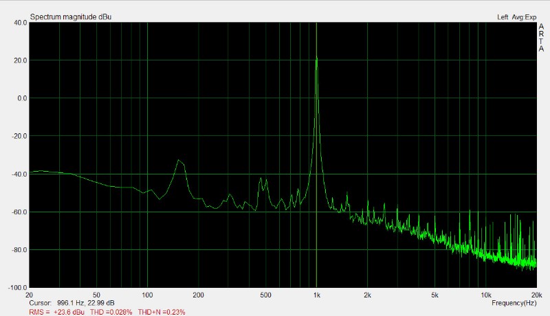

NOTE: measured with ARTA & Saffire le soundcard, performance of unit may well be higher on accounts of distortion & noise floor.. as the figures quoted will include what marginal hash it generates too.
disregard the 156hz peak, this seems to have nothing to do with the mixer.

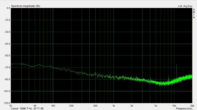

dig out:
* noise floor - -105db 100hz, 4.1k, -110db 20k, -83.5db
* 1.15v pulse train, well defined edges.

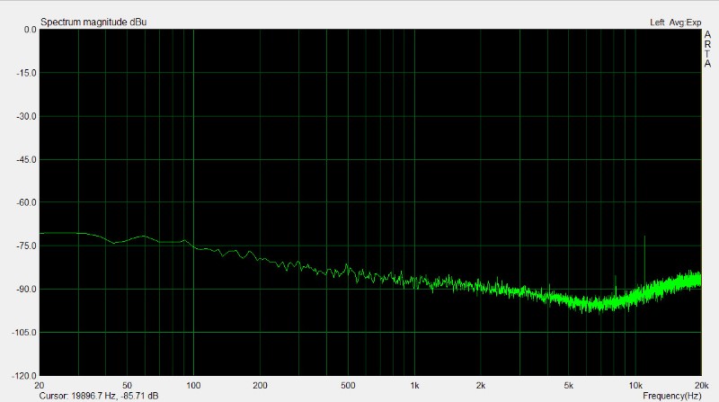

phono mode:
* max gain noise floor - -75db 100hz, -94db 7k, -85db 20k

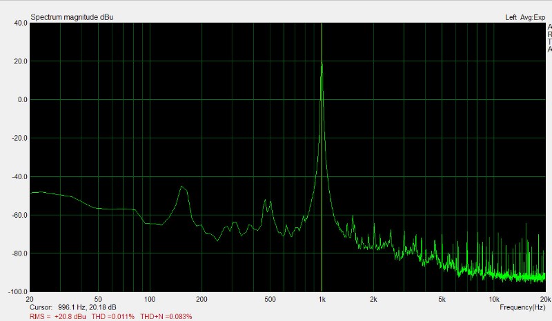

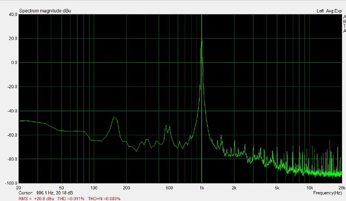

output a:
* +21 dbu before distortion.
* +8db on ddm meter (11v) cleanest sound setting. - (THD 0.011%, 21 dbu)
* +12db on ddm meter (14.5v) max ‘clean’ setting. - (THD 0.028%, 23.5 dbu)

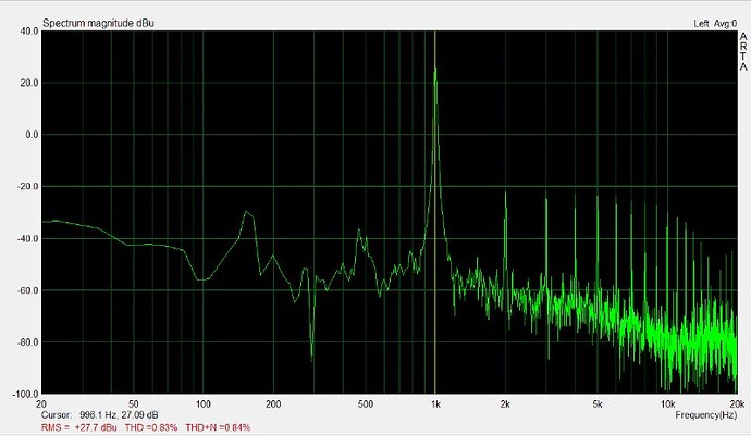

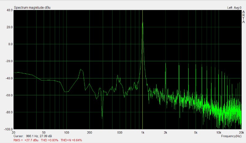

* clip starts to flicker on ddm meter (23v). - (THD 0.83%, 27.5 dbu)

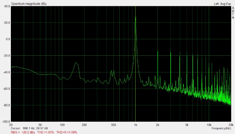

* beyond clip on ddm (27v) power rail limit. - (THD 1.63%, 29 dbu)
* 27v peak, for 11v out (knob at 12 o clock) before marginal distortion rise.
* opamp lower power rail seems to collapse before upper.
* any output level, neglegible noise floor does not rise.
* scope measured hf noise, mostly out of audio band: 22mv/rms aprox, 45mv peak.

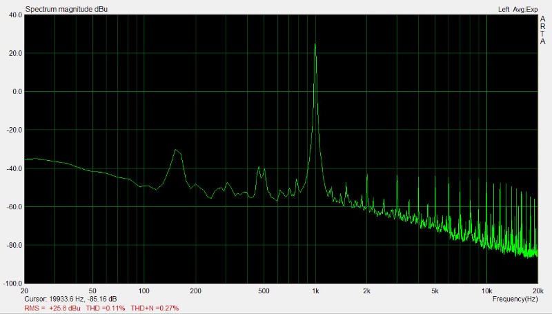

headphones:

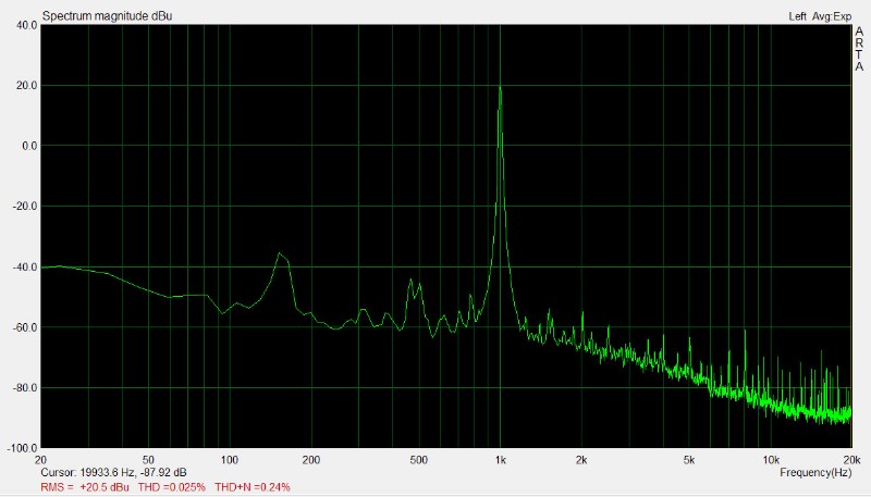

15.5v out - clean output (+20.5dbu, thd 0.025)
18.5v clip limit (+25.5dbu, thd 0.11)
(no load)
Digital out, idle all inputs set to minimum level.
Phono in mode, with gain set to maximum.

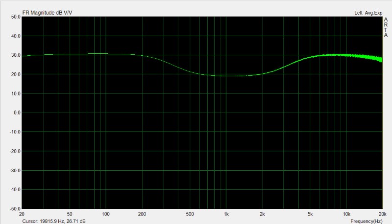

Standard eq settings, low and high set to max gain.

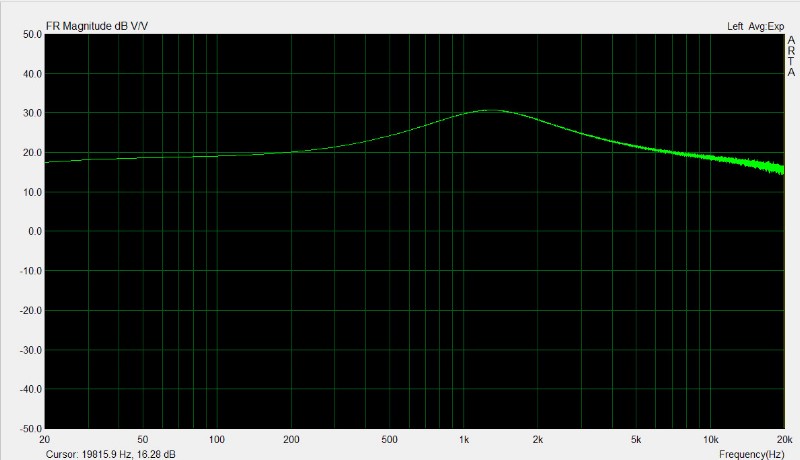

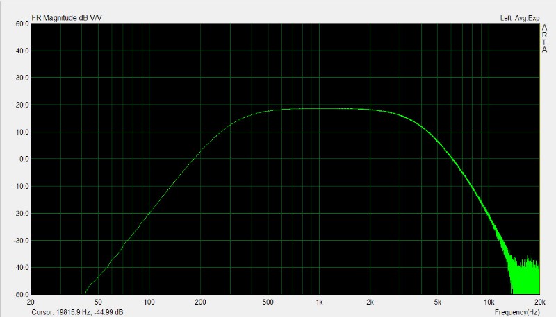

Standard eq settings, mid set to max gain.

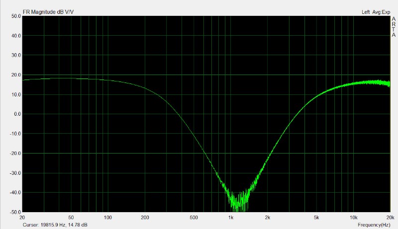

Standard eq settings, mid set to min gain.
around about -70db dip.
output a, at 11.5v.
output a, at 14.5v.
output a, at 23v.
output a, at 27v. rail limit.
headphone out 15.5v (no load)
headphone out 18.5v (no load)
