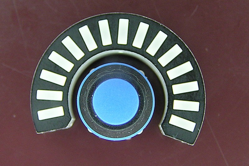

I have found these a few weeks ago
http://www.ledtronics.com/ds/CBG1500/Default.asp
You can find more by making a web search with keyword ‘circular bargraph’

That is exactly what I was looking for – a much more elegant solution to the LEDring problem. Thank you so much for the link!
the problem is to make the holes in the panel…  >:(

I`m little confused… If I converted dimensions right, inner diameter is 10.16mm. That means the knob on the picture is not more than 8mm in diameter. Also I guess it cannot be used with regular sized Alps/Voti/Sound Well encoders. Right? How long shaft needs to be to have both encoder and LED ring soldered on same PCB?
I`m little confused.
you are, diameter is 20.32mm  ;D don t worry sometime happens
Oh, I just noticed it is radius, and not diameter.  :-[ well…
Hahahah … confession: I did that when designing the footprint for a battery holder. A CR2032 will not fit in a 10mm diameter :wink: hehehhe
The ledring is 11.18 mm thick and no, Soundwell encoders wont fit. Encoders like ~9mm or ~12mm max is required. Like the one SmashTV is selling.
