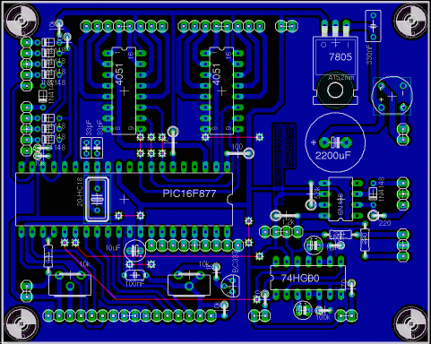

Btw.: I just have finished the new layout and will get the PCB in about 4 days in order to test it. It looks expensive, but it isn’t: the estimated price is about 7-8 Euro for a premade 10cm x 8cm board and it’s also nice for DIY etching since only a single layer is used (and 9 bridges…)
Best Regards, Thorsten.
I rek so, if you look at the pic the red/pink wires (I count 9) will be the bridges to solder that’ll save ya from using a dbl sided board…
