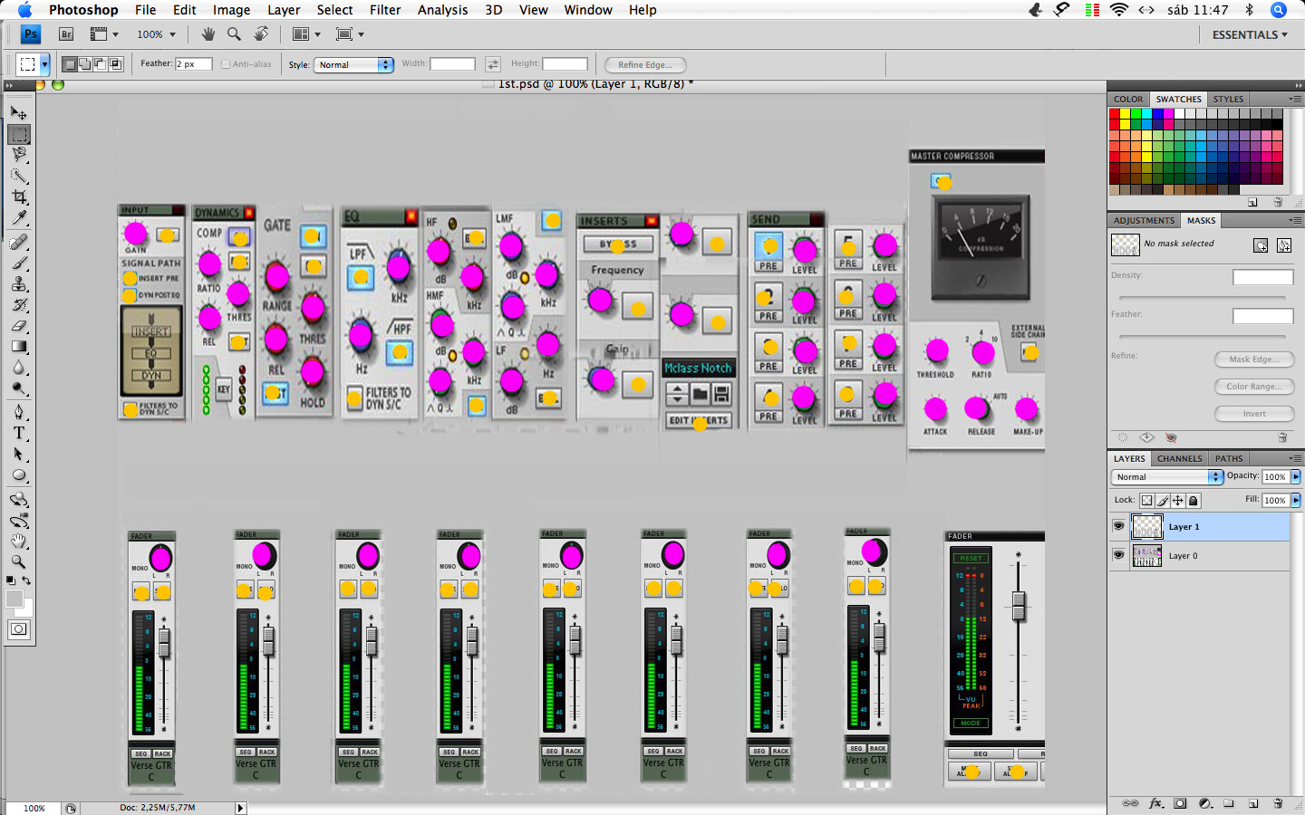

One question. If I’d stick to 8 motor faders, could I still have 45 Encoders and 64 buttons all together?
This because I really want to have the strip channel in front of me, and then a modifying button to then assign the same encoders to control the main send and returns, that would be labeled under the encoders… Like a “shift” button.
Somth like this:
(pink is encoders and yellow is buttons, plus the transport and modifiers)
look i have made it easy for you to understand, i cant be any simpler, if you look at the cnx description which you did, goto ucapps.de, look at the info for the dinx4 boards and how they cnx in the pdf files in that page, you will learn how many buttons per nix4 you can connect or how many encoders per dinx4 you can conncet, for reference, 64 buttons per dinx4 or 16 encoders per dinx4, you can mix buttons and encoders, you just have to remember that an encoder uses two pins, the one its assigned to in the asm file and the one next to that assignment. buttons use 1 cnx and the other to gnd.
