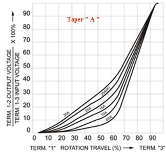

Regarding the pictures.
I was talking to a HongKong dealer from ebay.
Iv’e purchased several items from him in the past, like IC’s, protoboards,
switches, pots etc.
Fair prices! This is why i asked him if he could supply me with pots.
He told me to go to this link (ALPHA pots homepage):
http://www.alphapotentiometers.net/html/pot_selection.html
Choose what i want and send him a price request.
http://www.alphapotentiometers.net/html/16mm_slide_pot_5.html
When chosing the right specifikation, one needs to confirm what kind of taper one wants.
http://www.alphapotentiometers.net/html/taper_curves.html
This is confusing.

Anyone got any input about wich line curve i shall choose,
regarding the info i posted above?
…Anyone got any input about wich line curve i shall choose,
B  (the one that is a straight line)
(note that not all manufacturers use the same letters)

Looking at those graphs on a better monitor, I wonder if they might be the old ‘fixed-resistor-in-parallel-with-the-pot’ type graphs.
When doing analog audio control, some folks have been known to strap a fixed resistor across two terminals of a pot (one of the terminals being the wiper), in order to modify the pot’s taper.
