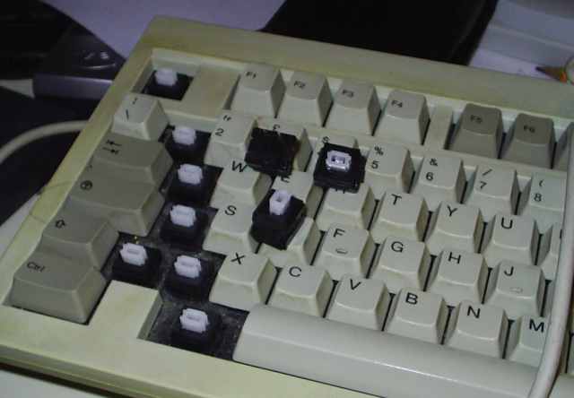

i found the buttons for the sequencer!
if you need a lot of push buttons, search for an old PC keyboard!!
Surey.. but which “Brand”?! At least Keytronic manufactured are out of question, as those have keyboard membrane, not individual switches..
I got some from an old Teletex terminal, but sadly those are Normally Closed type.

i cannot tell you what kind of keyboard was. it had the old large connector, and not the nowadays ps-2 (?)
i used it with my old 486… and fortunately i never trashed it! :slight_smile:

i 've got them from a broken commodore amiga 500;
you can get them out quite easy with a desolderingpump and a mini screwdriver.
they are "noramlly open"and have four pins on the bottom (wich sadly dont fit 2,54mm rasterplates)
dont know about the quality though..
if you look at/in the caps lock button you’ll see it has a built in led(2mm??) and a small plastik “window” in the corner of the cap, to make the light visible.
the other buttons could house (small) leds as well, but you’d have to find a solution for their caps/.
